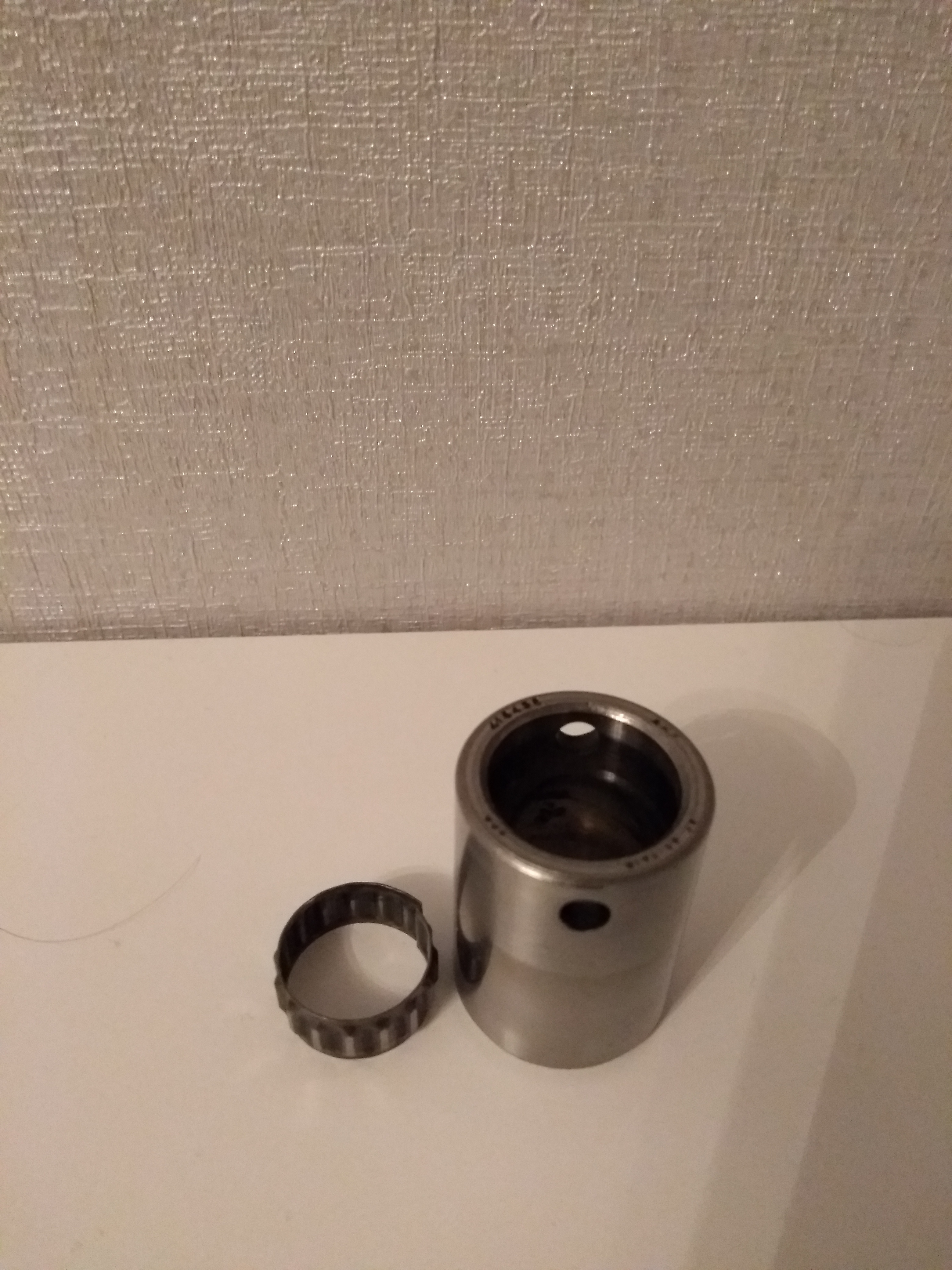

This is the inner sleeve and tolerance ring which holds it in place on the input shaft
you could use a pin through the holes attached to a slide hammer but this would be a harcher process knocking it back in
