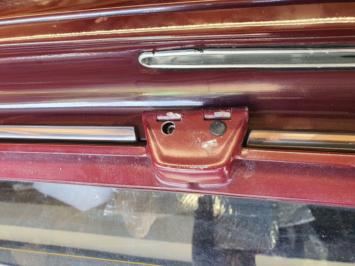

And my favourite modification that I did on DDG.
4 holes and 4 socket head bolts make fitting a rear hatch SO much easier.
I can live with 4 rubber gtommets !
Not hard to remove and replace but when shimming in on rebuild or new seals it saves oodles of time and you can leave the rear hatch stays in place, no more using the back of the head to hold it up
