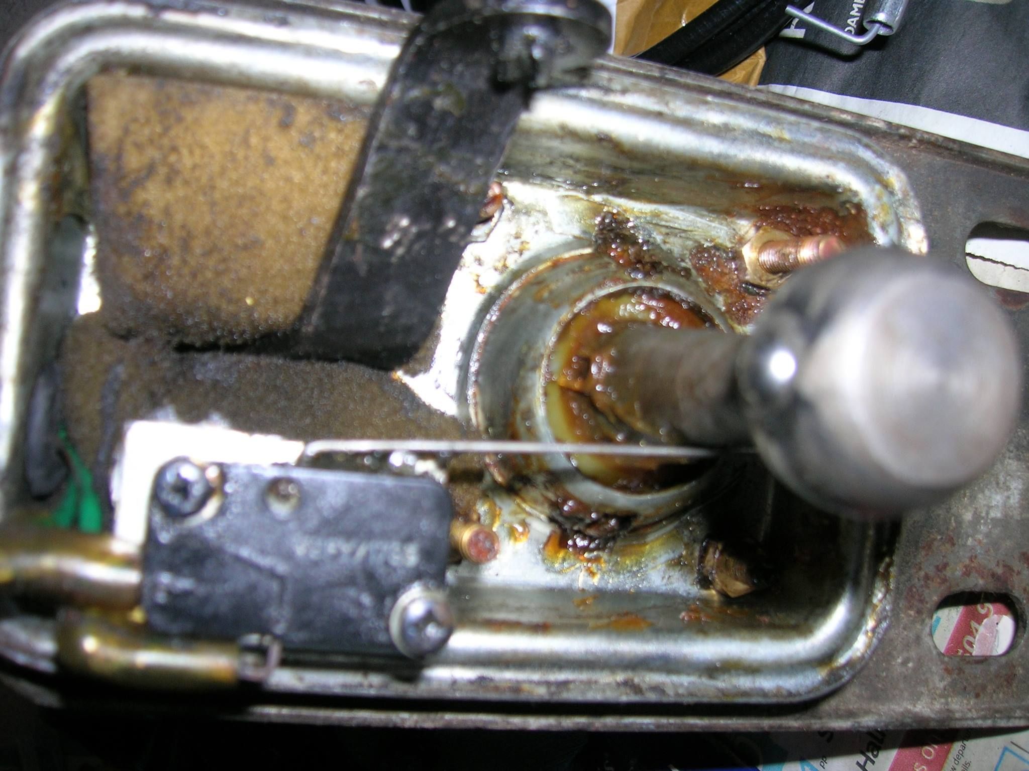

Dave had a picture he sent to me of the factory micro switch Dave Lane and that hides on the gear lever. can be retrofitted to the gear lever.

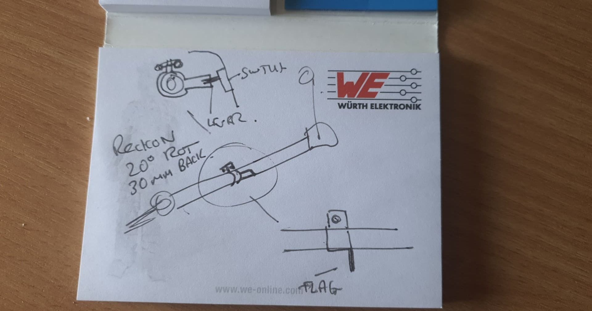

I have not put it on yet but the switch I intend to fit on DDG is different and uses a clamp on "flag" which attaches like a U clamp onto the gear selector shaft that I can rotate/bend the flag end on and the micro switch is attached to the inner tunnel on a couple of rivnuts. The clamp flag lets me get more movement on the rotation so when in reverse the distance the flag moves when the gate is engaged is a lot. It will be protected by the under tray when fitted.

The factory one works well Gary but any play in the gear level assembly or bad alignment of the switch and its iffy.
Reason being the movement/shift is minimal making the adjustment critical. My plan was to extent out from the actual shaft so that there is more distance moved per degree rottaion, front/back there is a lot of movement so will be positive.
my best dodgy doodleno rocket science but throwing the flag out a bit from the centre gives it a more positive path of travel.

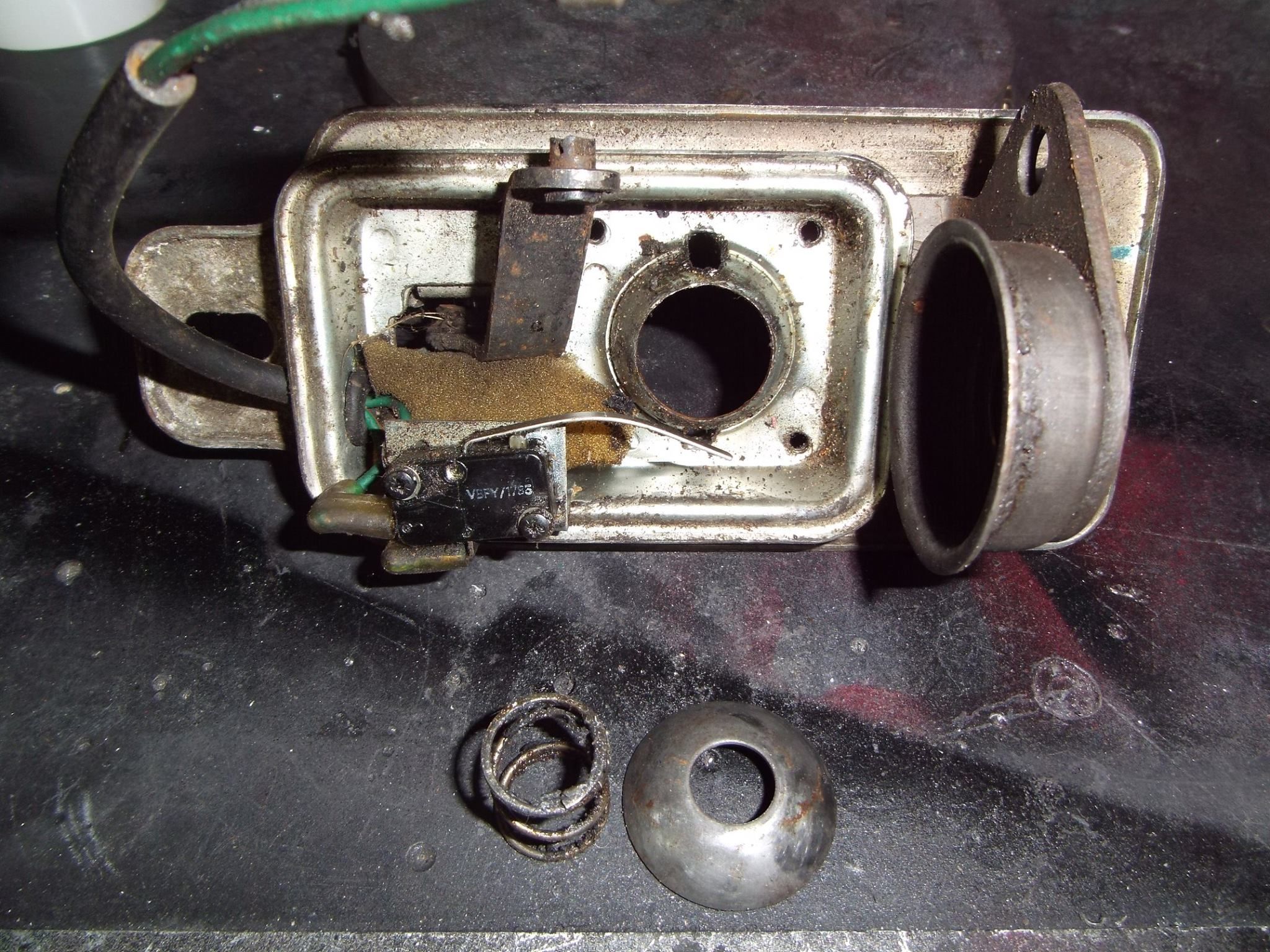

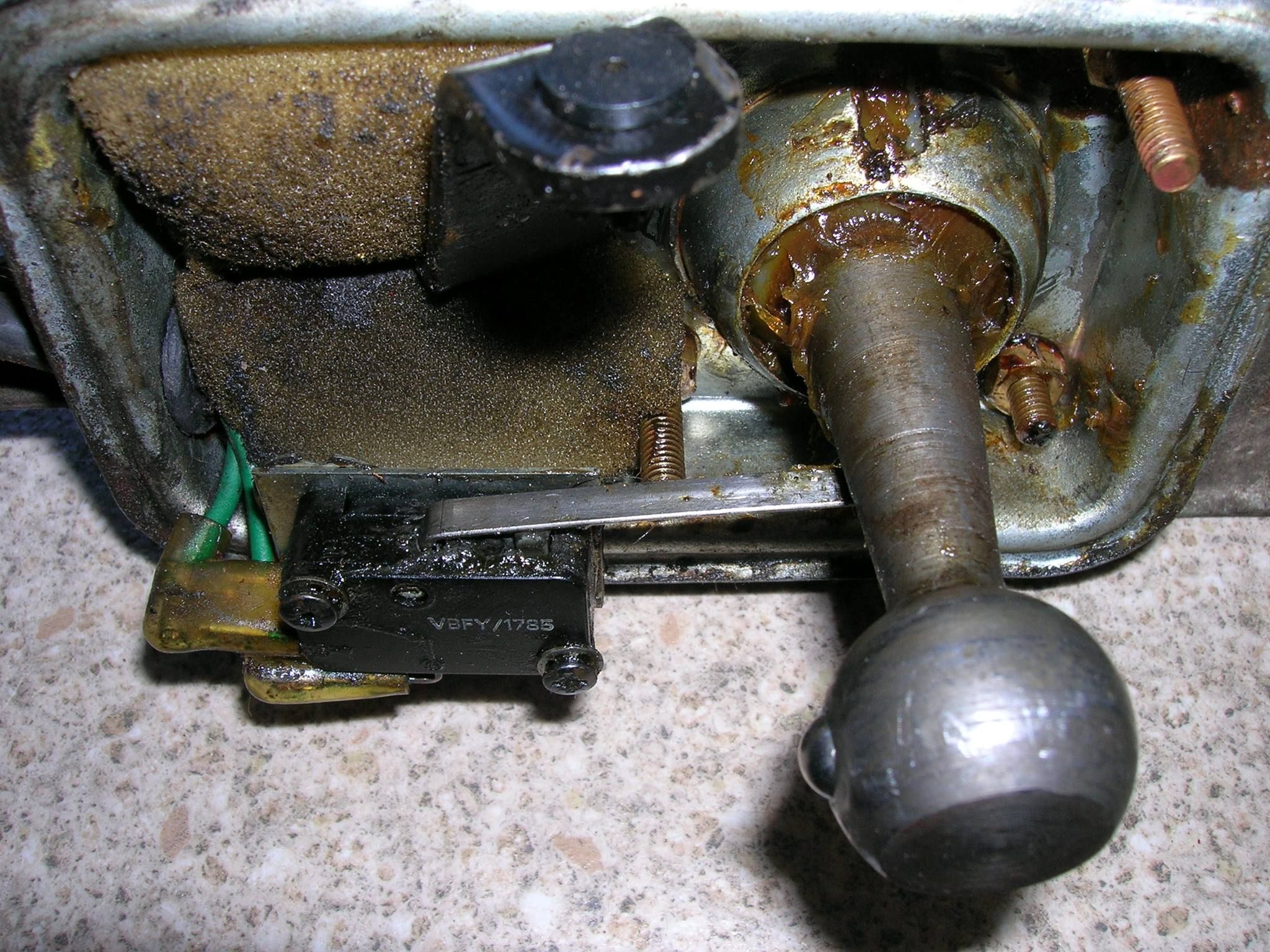

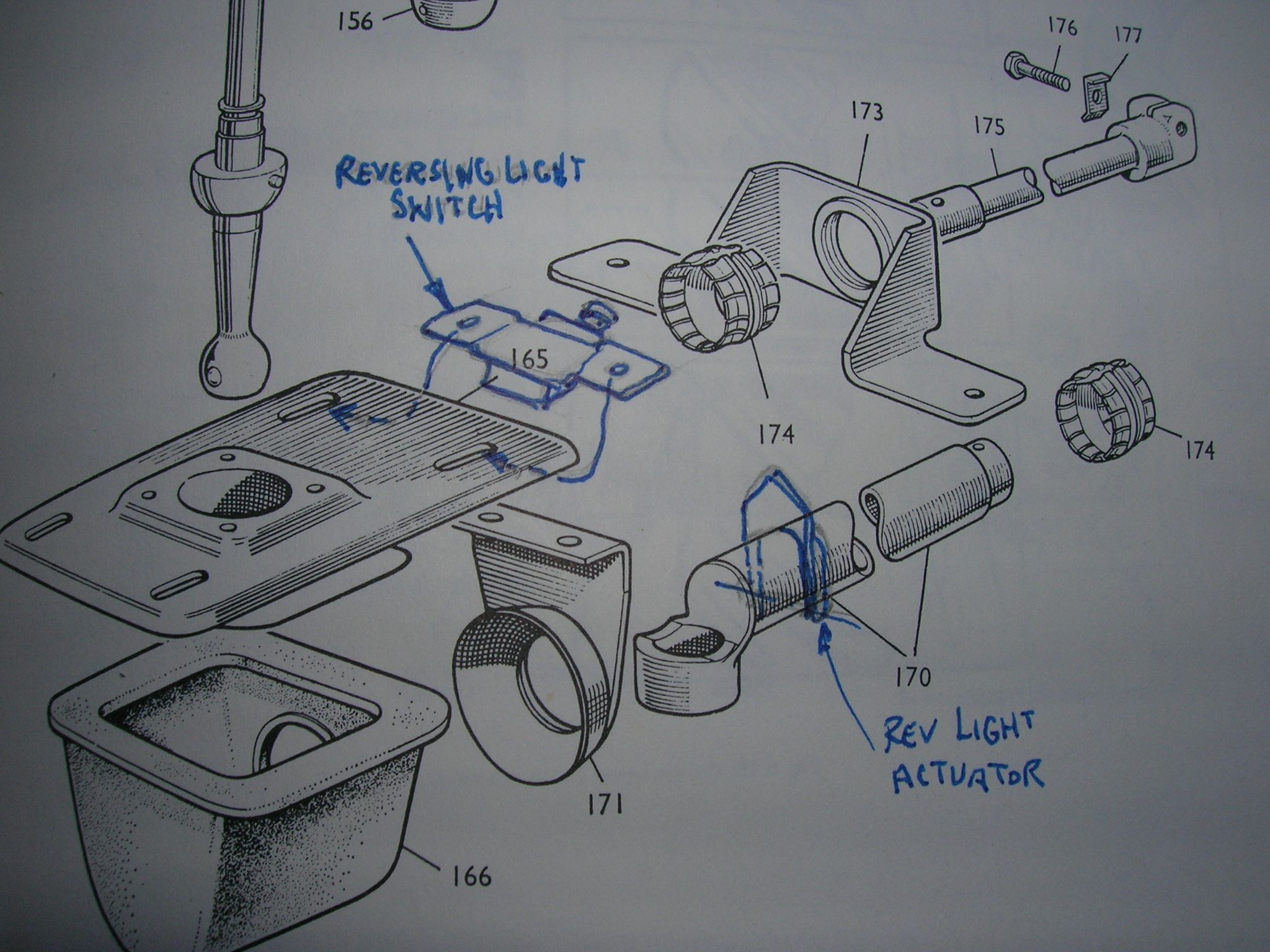

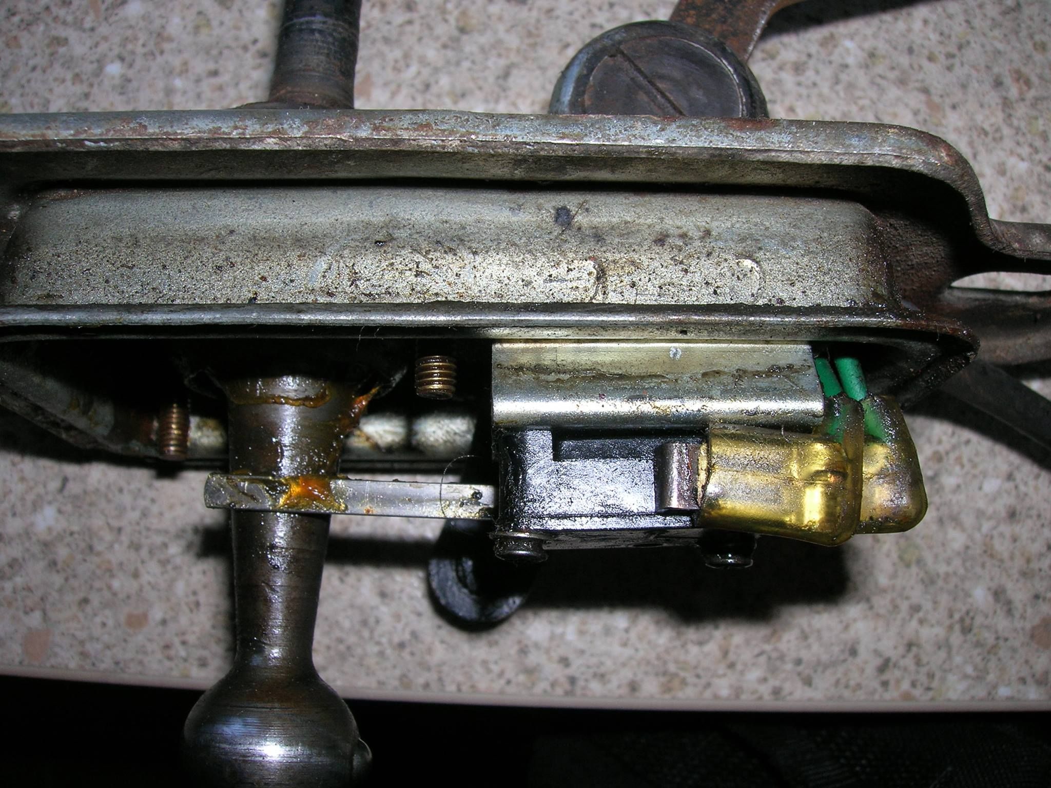

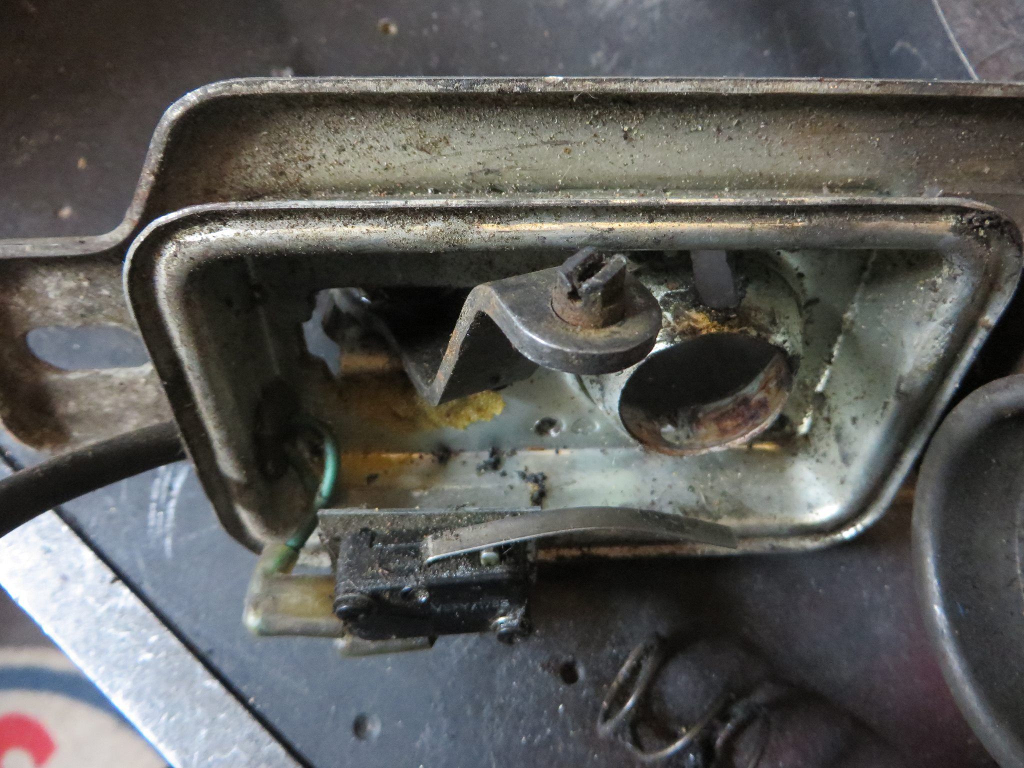

Gary, images of factory placement
Some from Dave lane Dave Lane and some from Peter Nunney Peter Nunney
looks like easy mod to replicate the factory way, if you need those switches I have some here Gary.

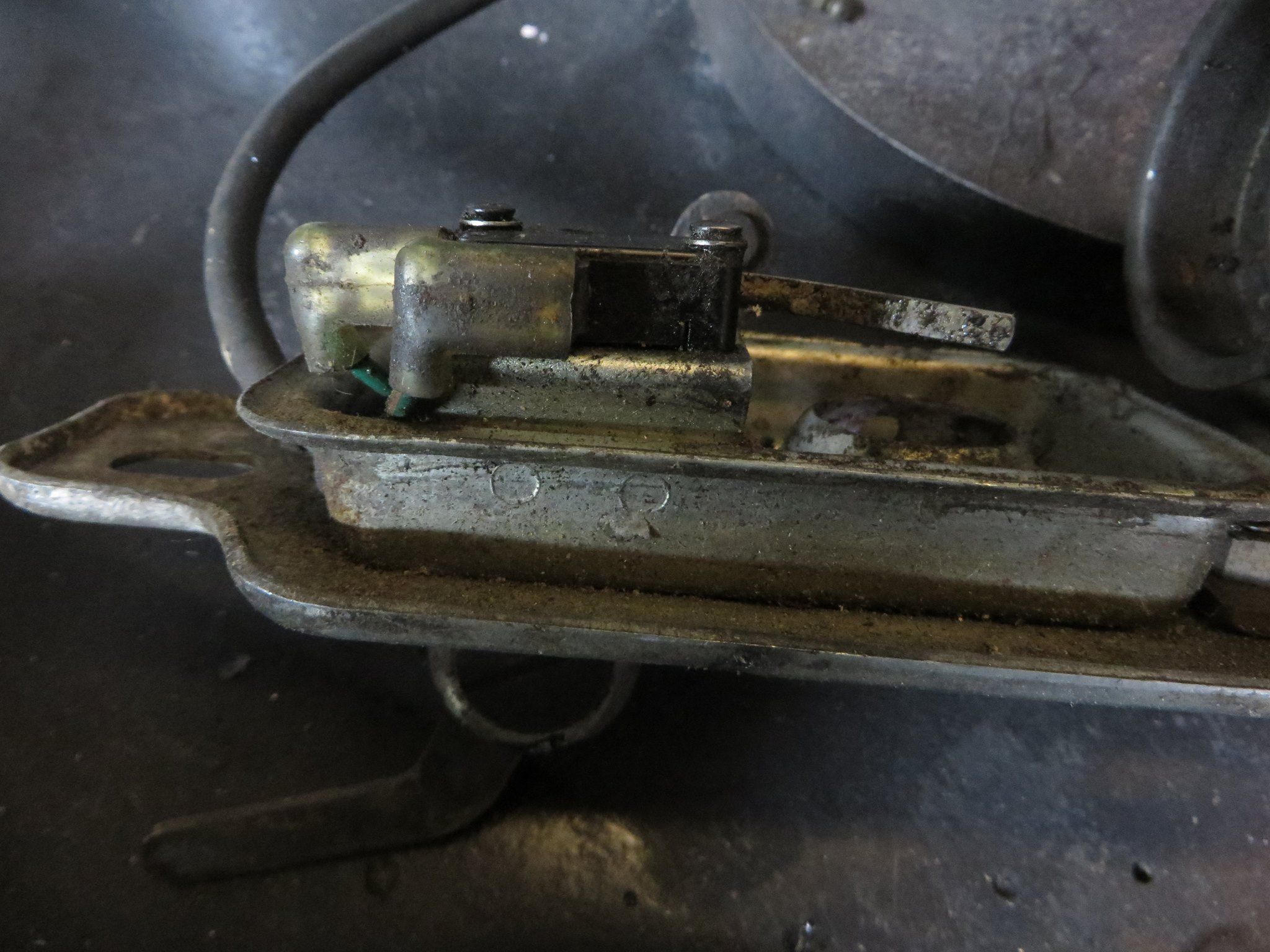

Peter also added this
Similar to what I had planned looks like uses a U clamp, switch would need roller end though
I did consider this but makes things just way more complicated !
