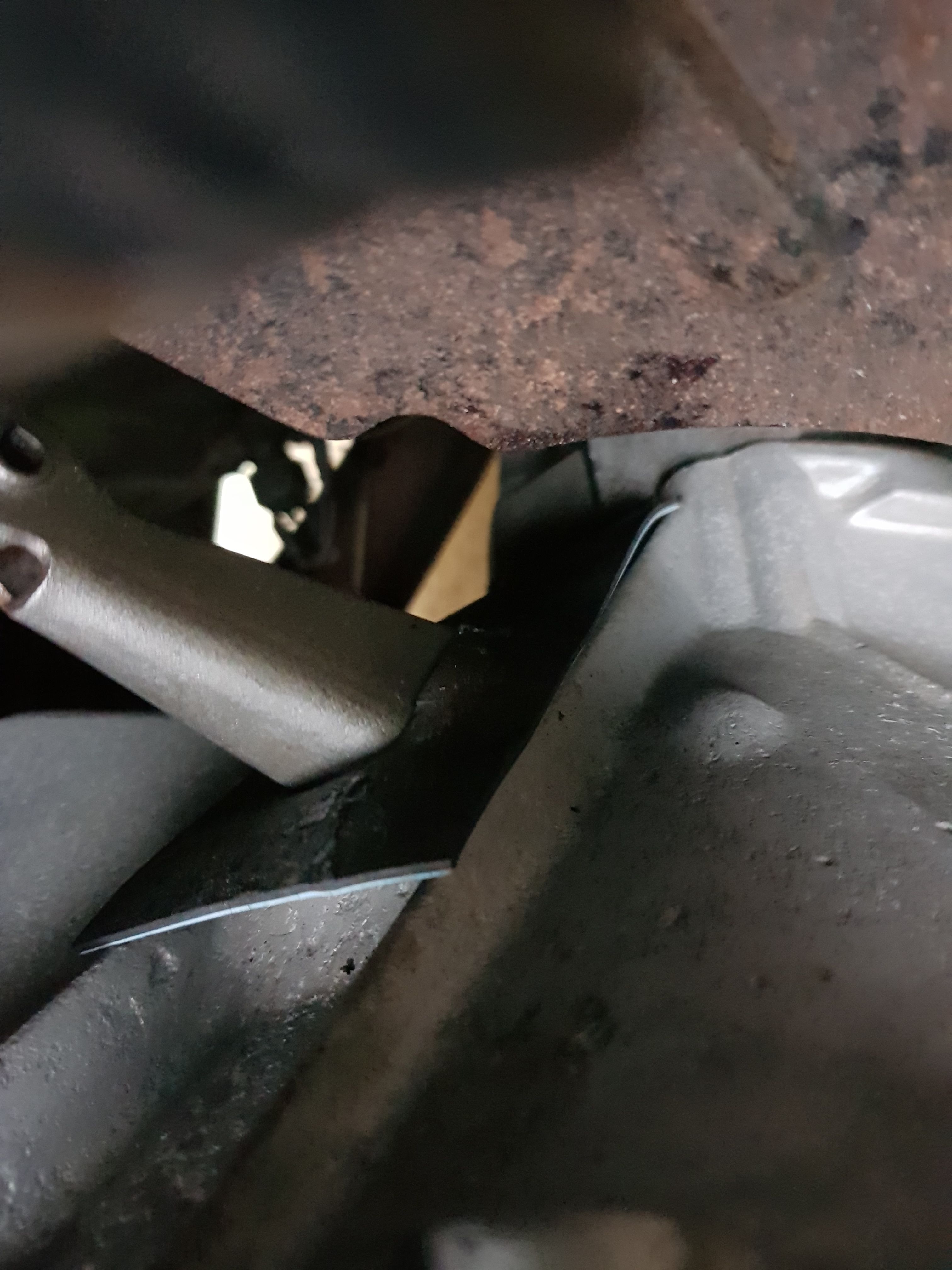

One solution for keeping crap out the transaxle top opening where the fork is
    • 4843
    One solution for keeping crap out the transaxle top opening where the fork is. Crude but it works, on Mildred this was really dirty and covered in crud, only 1-2k miles or so. Just shows how much crap is throw up there
    Something I have always done but never thought to comment on. Now that Dave Lane is on a run mith nods mods thought I would add my meagre attempt
    Neoprene layer, cut N channel out to fit around the clutch fork and big enough to cover and flank the top transaxle aperture. No more dropping ashers from the slave cylinder bolts down inside the transaxle !
