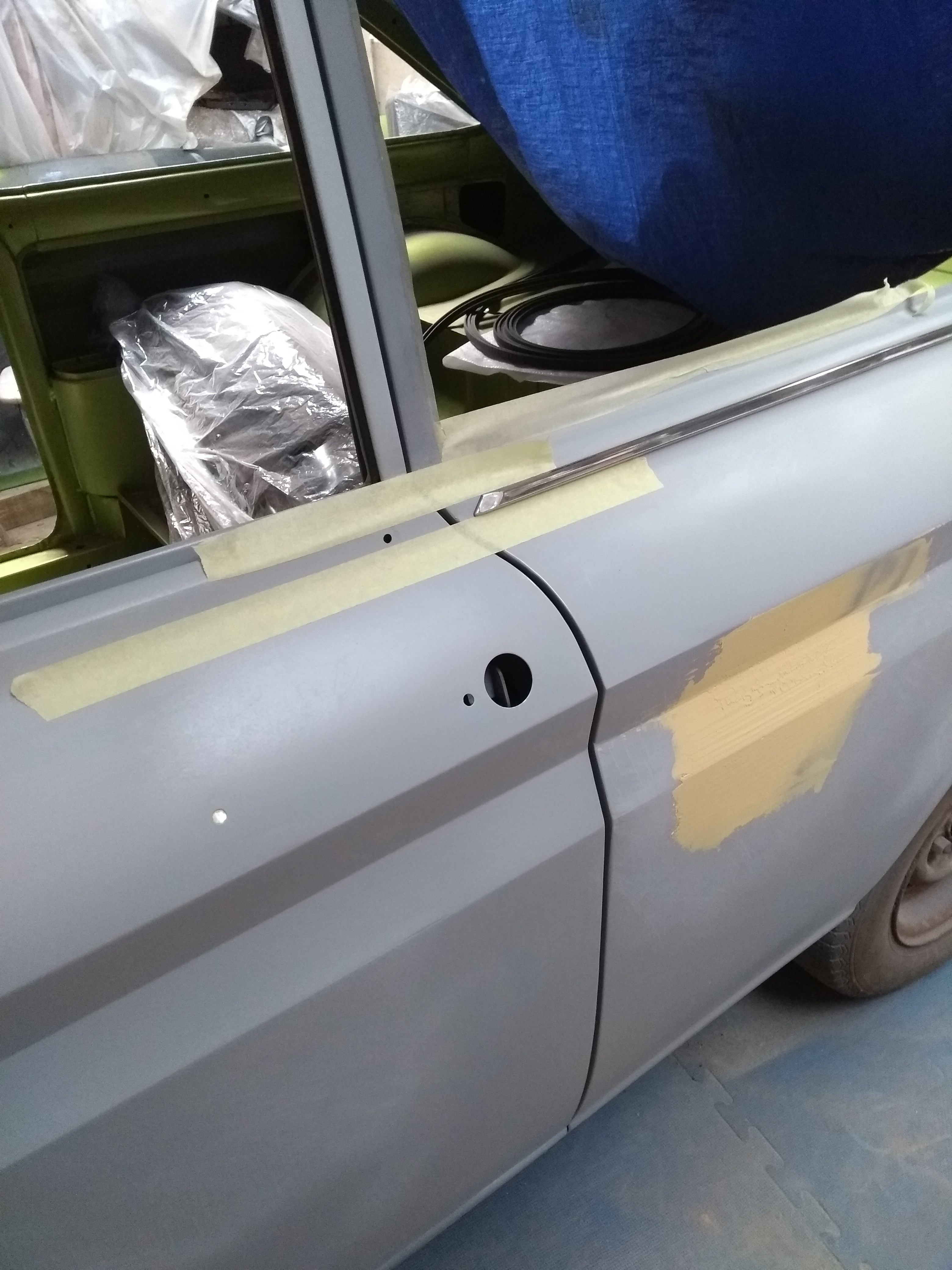

Gaps and lines look very good.

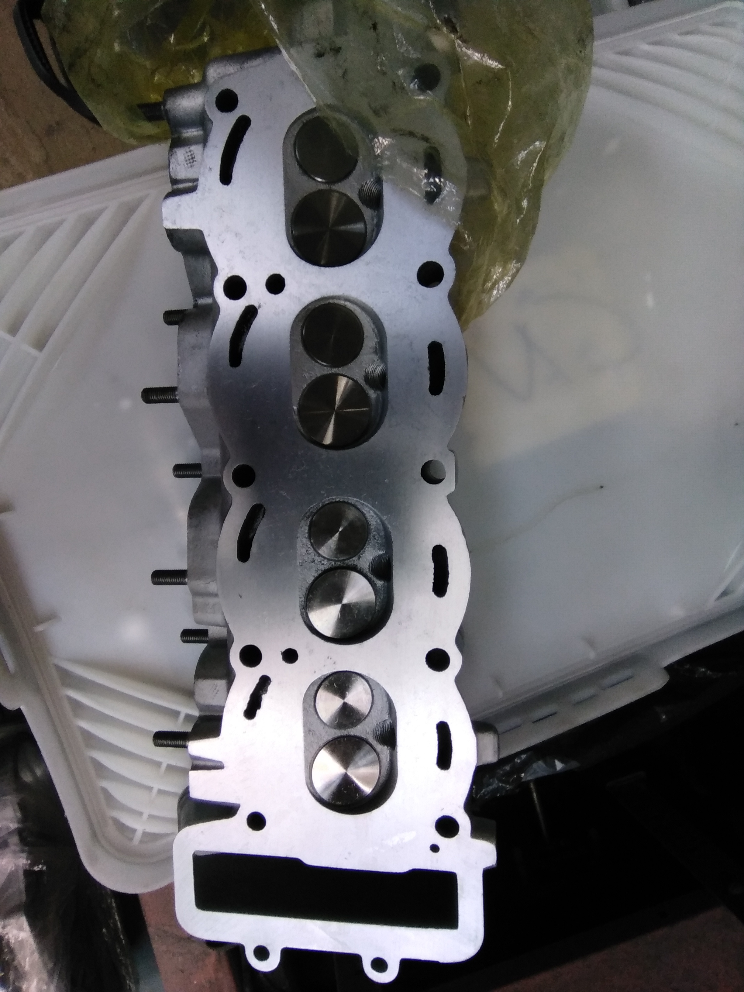

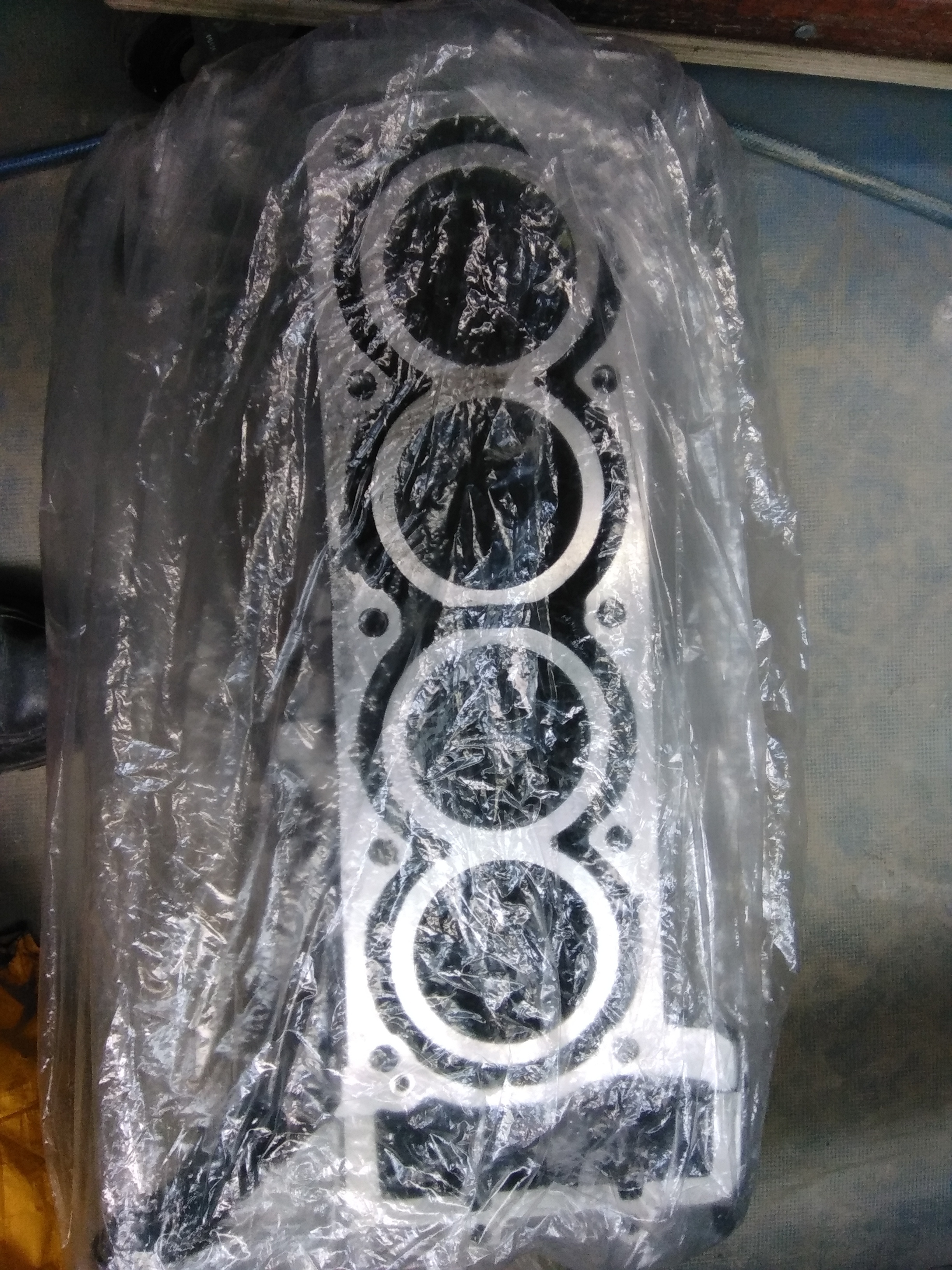

Engine now with Andy Jones had a long chat and look round at what else he's building ,said it was lucky I had the NOS hepolite pistons +20 as they are very hard to get now we had a chat about the 733 head I had to convert to sport spec but it wasn't worth doing the. possible break thro in to the water channel was a problem so I I've gone for a full referb on a sports head new bronze guides stainless valves
so should keep me going for a while
I also took along the new main bearings for him to have a look at to check the quality ,they are fine as he said there have been some terrible bearings on the market

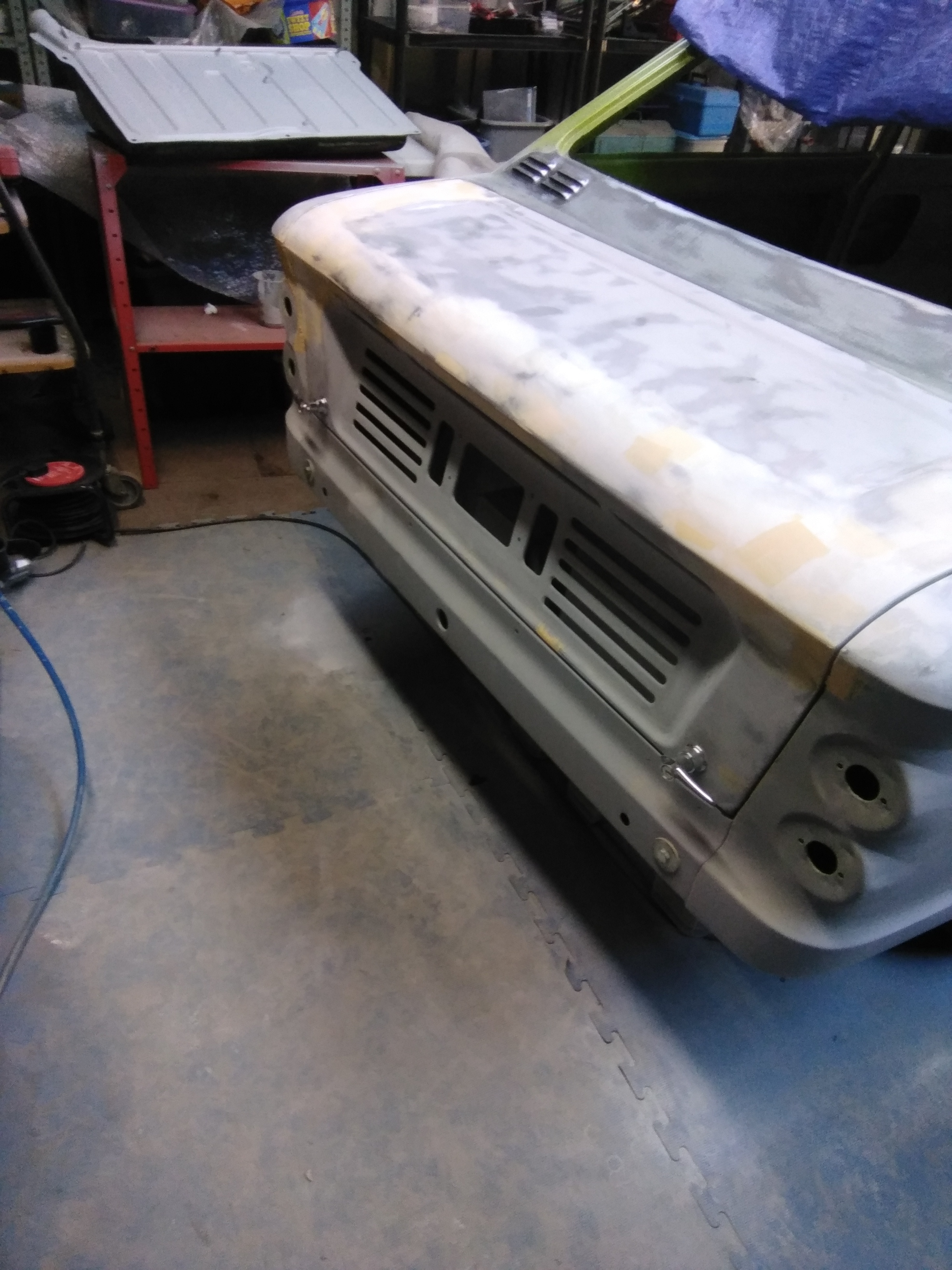

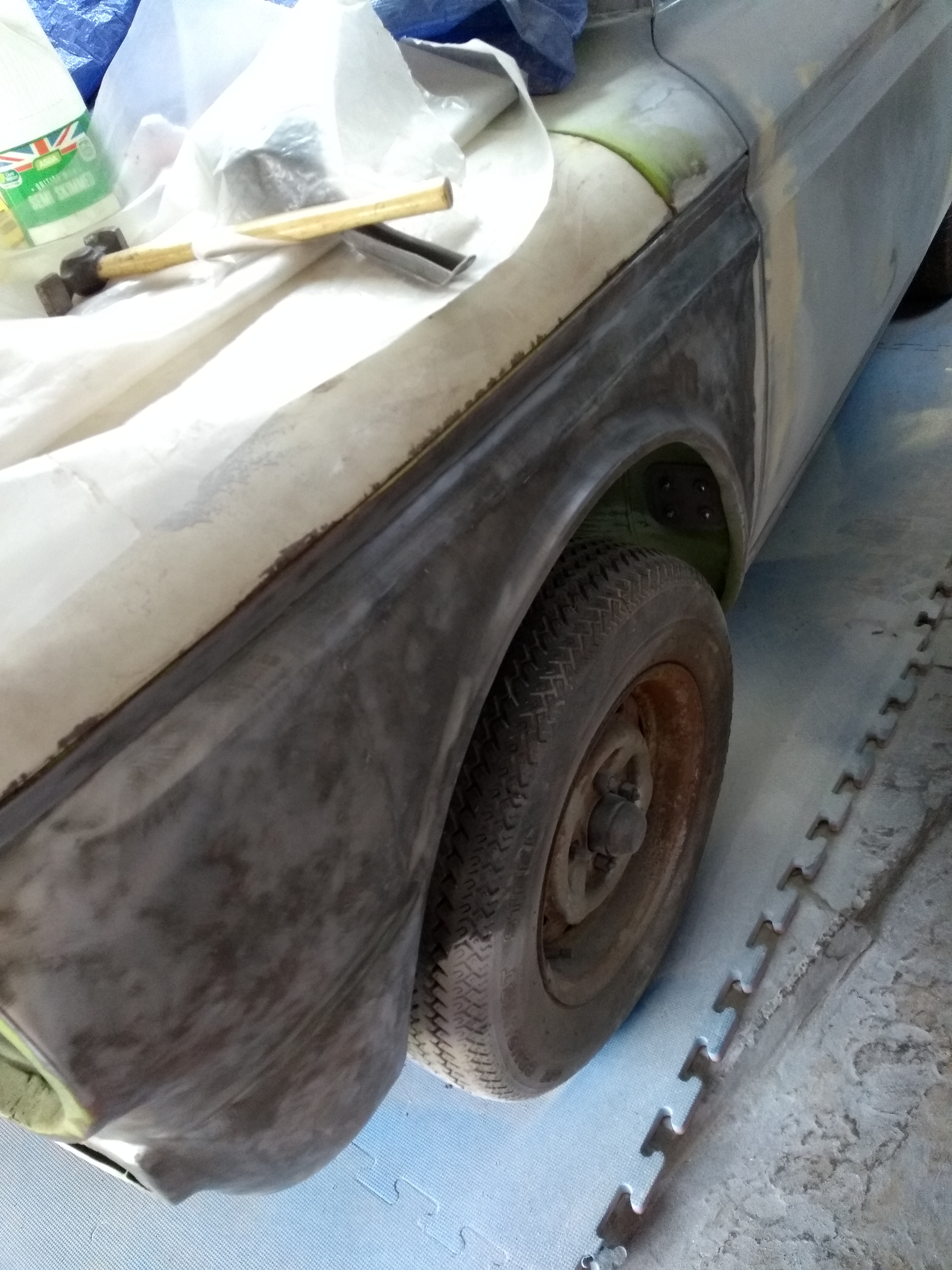

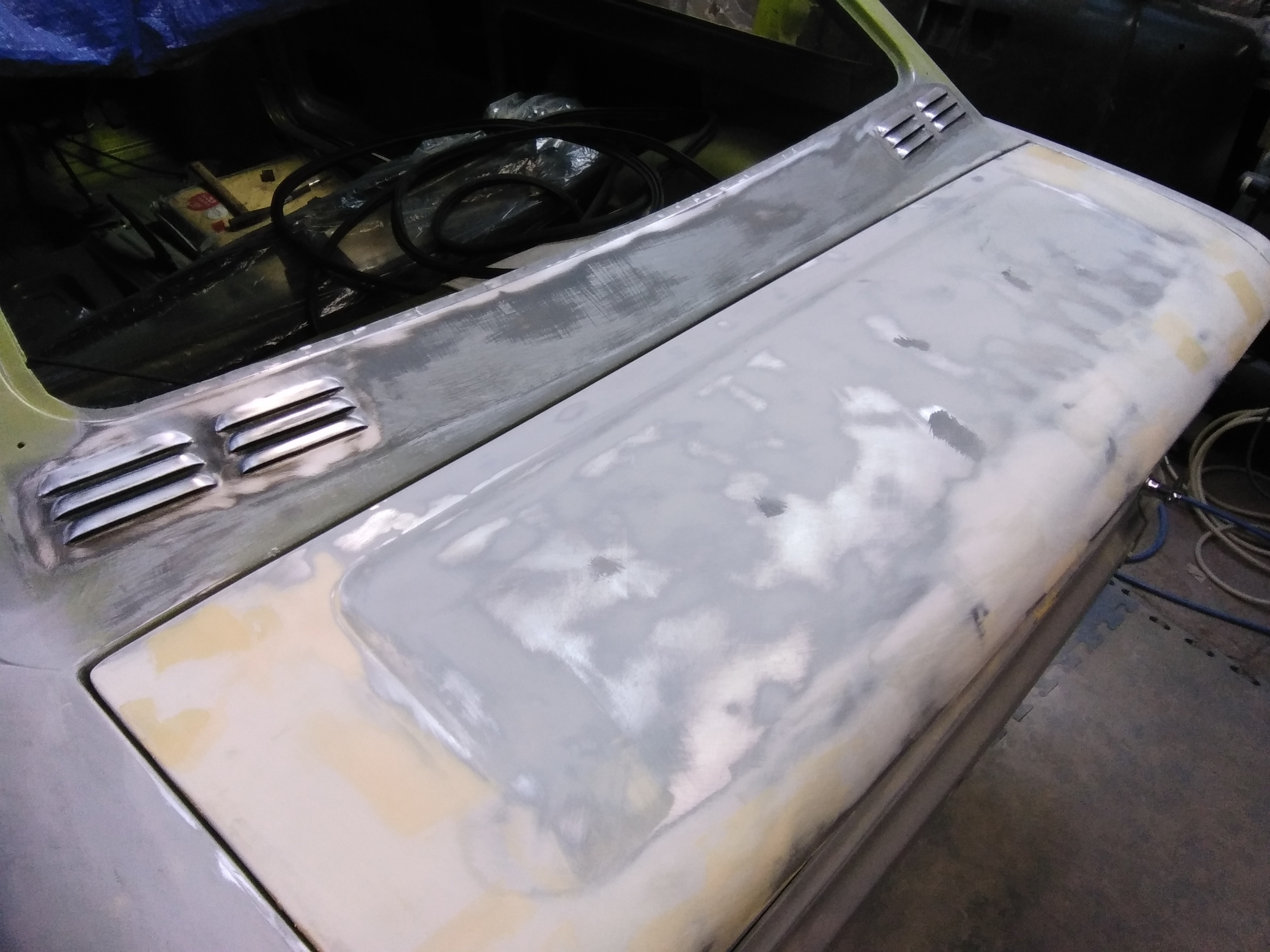

so better get on with the bodywork

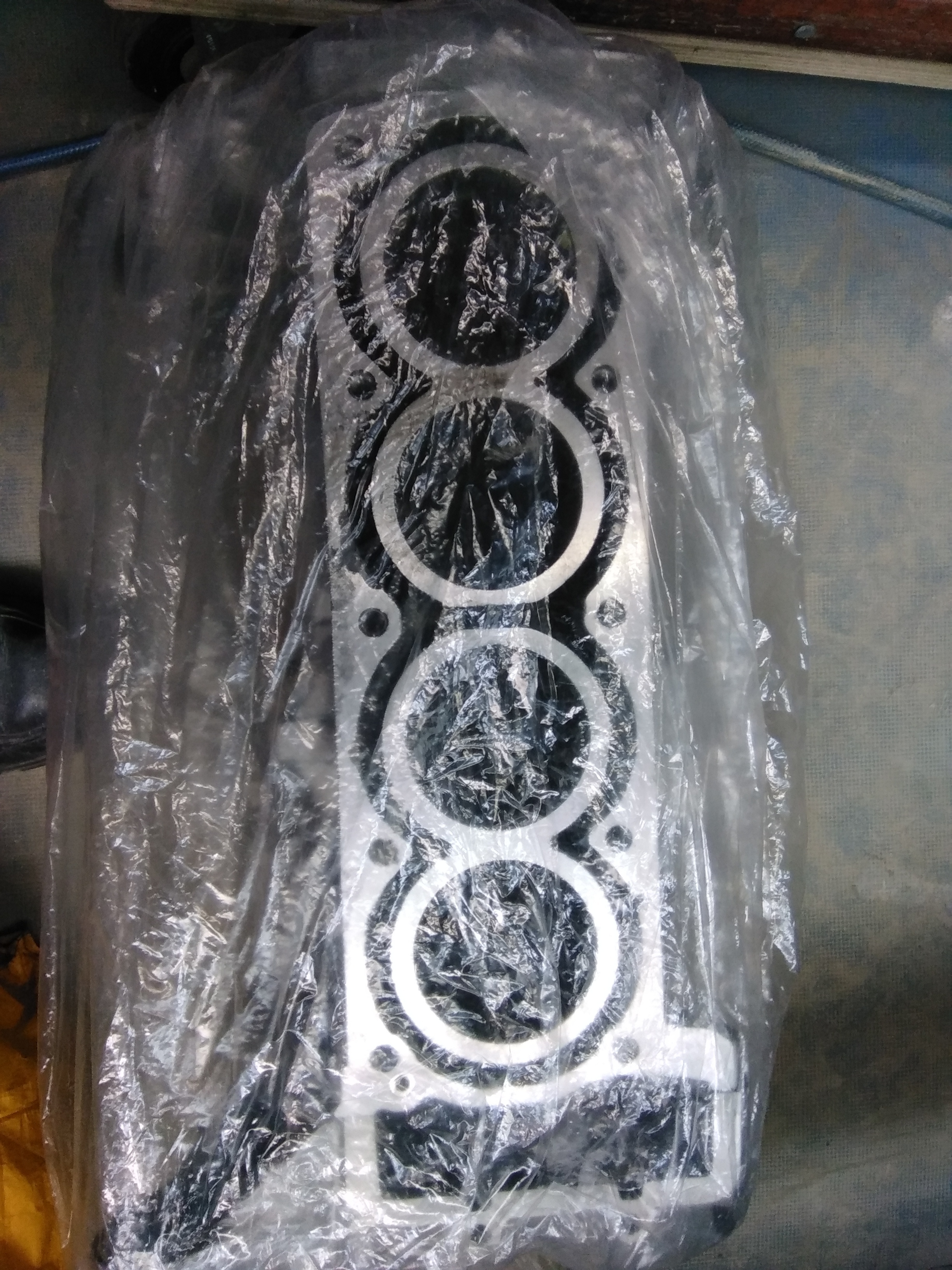

I've got engine back iam building it myself I'll put some picks I had some valves for the head but as soon as I saw Andy's I was sold Andy bored the block tight only .0015/.002" and I have to bed it in carefully to1000 miles got 10/40 oil of him guarantees it will not glaze .
it should bed in to .003" and he says it will not burn oil
