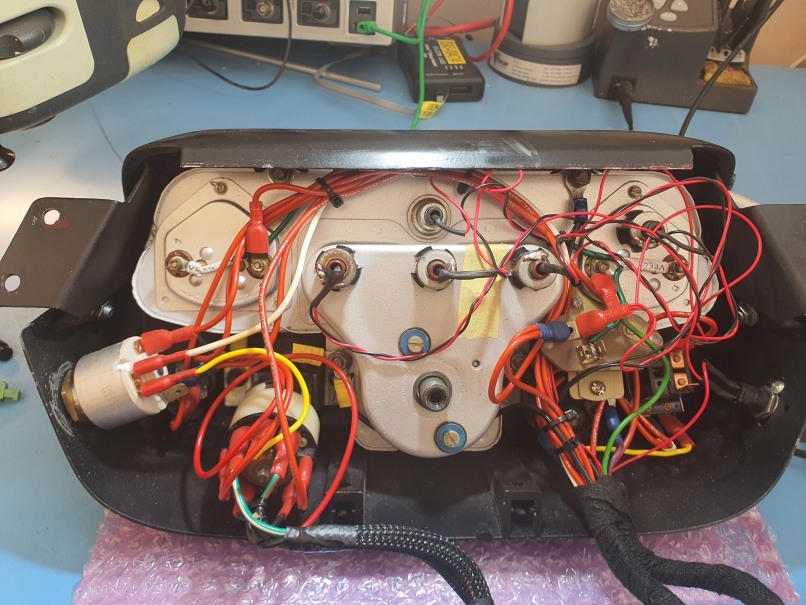

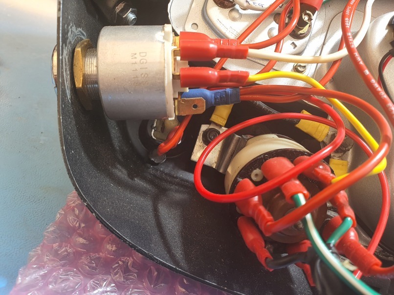

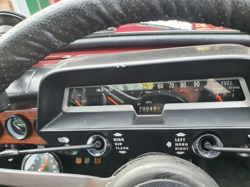

Biggest bummer was failure of the smiths stabailiser for the fuel and temp all around the nearly 80k miles , went from zero to end stop back to zero and fail
So binnacle unplugged and stabaliser removed

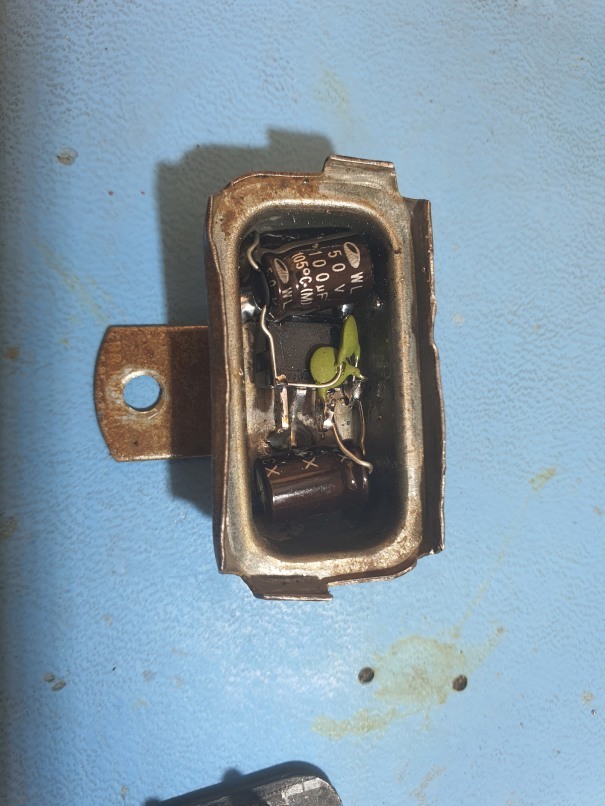

And as I could not find the box of stabilsers I ended up having to make one of the devils own solid state versions and jam it in the tin can.
Now all working but its annoying the crap out me, new smiths one going in as soon as I find them

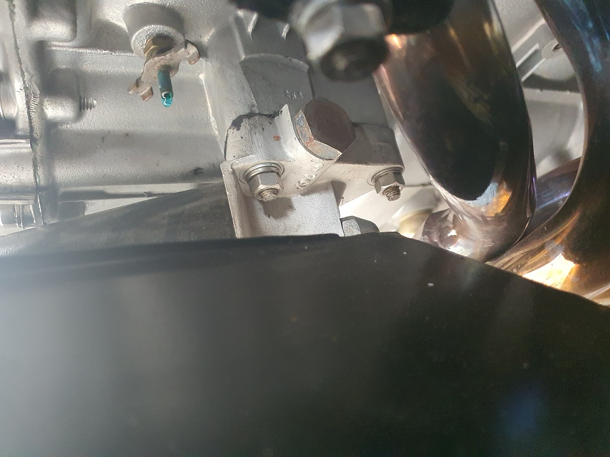

Decided to pull the engine and box and as all the spares are knacked, car will be off road unless I can buy an engine for cheapness.
What started off as a bit of pufff of coolant (engine never lost a drop of oil) ended up like this
So plan is now to
Pull engine and box
I will have a good look at my "expert professionally" rebuilt gearbox and see if i can fix the oil leaks, end casing for gear change shaft will need to come off and see what the O rings are like as the leak at the moment would suggest there isn't any !
Then onto the engine, preferred route would be to return it to the builder as that knock is not healthy but I will at least drop the oil and see what is on the sump plug. I have seen the oil pressure drop time to time but the terminal on the electrical sender was loose, when i recored that video it would not go above 25 PSI which is very far away from the 50-55 it normally sits at when revved.
Head has to come off anyway to check the liner heights (in case one dropped) and pull the rings to confirm that they are indeed the "bad batch" circulating at the time. Thats 50/50 as the other rings would have failed as well.
Then off with the sunp for a look see.
It will likely need something, any machnining involved will be a case of booking a date with Andy and just get him to check/rebuild and run on dyno
Complete feeking bummer, first engine almost ever with no oil on the deck !
I have a gearbix or two unkwon, so if I can pick up an engine to use in between I might drop that in to see that it is OK as thats about the only way to test them
