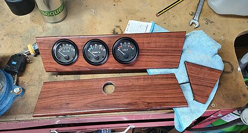

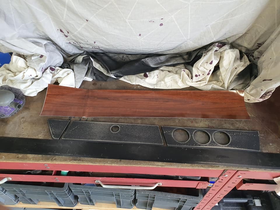

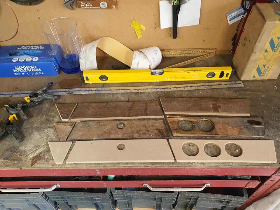

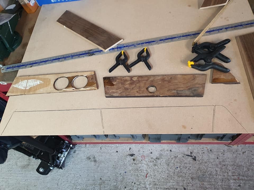

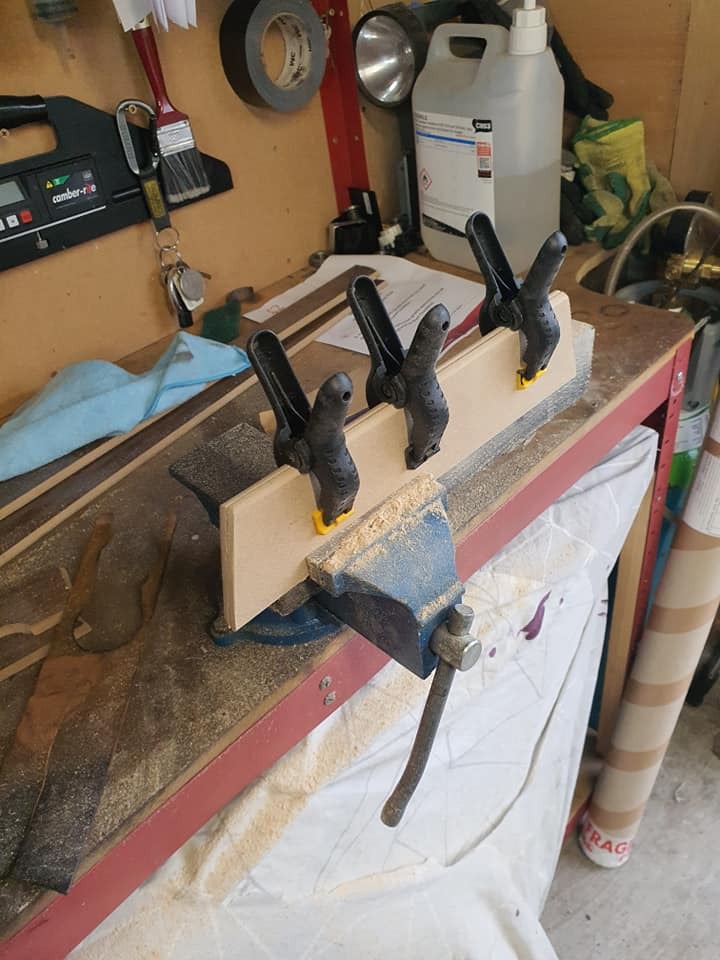

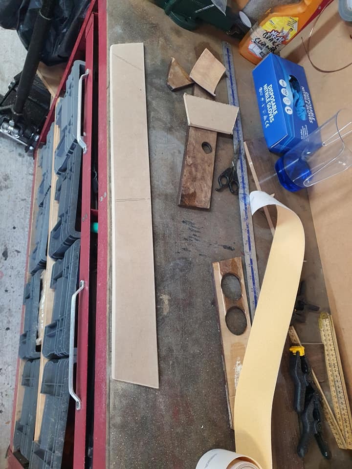

Well that was a failure, my straight line must have been as bent as a £3 note, finish on the made pieces was great but I am not spending the time to modify as it will take too long.

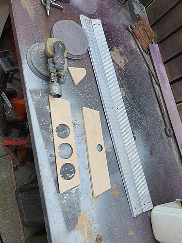

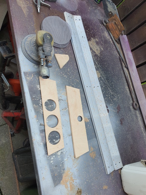

So took originals and blocked down with 80 grit, then 120, then 480, nice and smooth and back to ply.
And of course now I have to seal it.

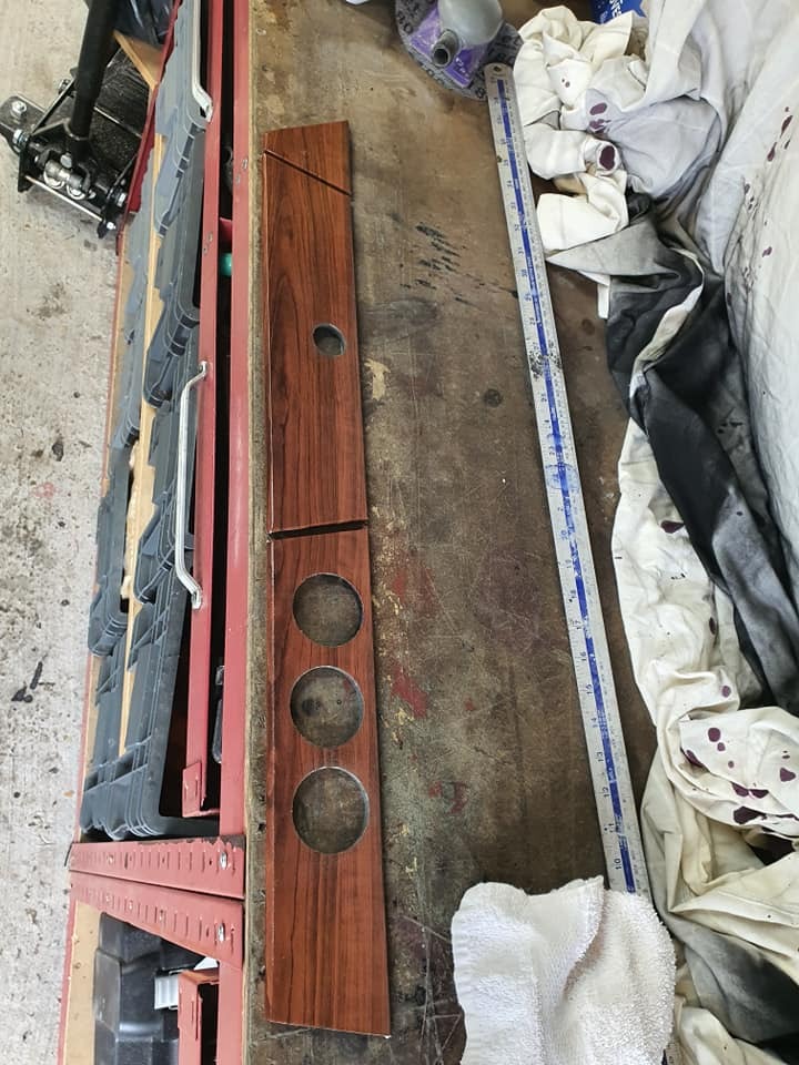

Strangely enough the ply that rootes used was already veneered, loosk like re-cycled, before they added the veneer and varnish
So plan A is available. Needs 3rd guage hole oval out a bit to fit back plate OR the metal ovaled out.
Not by much tho.
