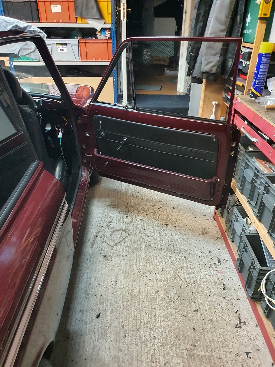

And next, finish driver side rear wing panel and then door cards and pockets.
Side cards at rear now done

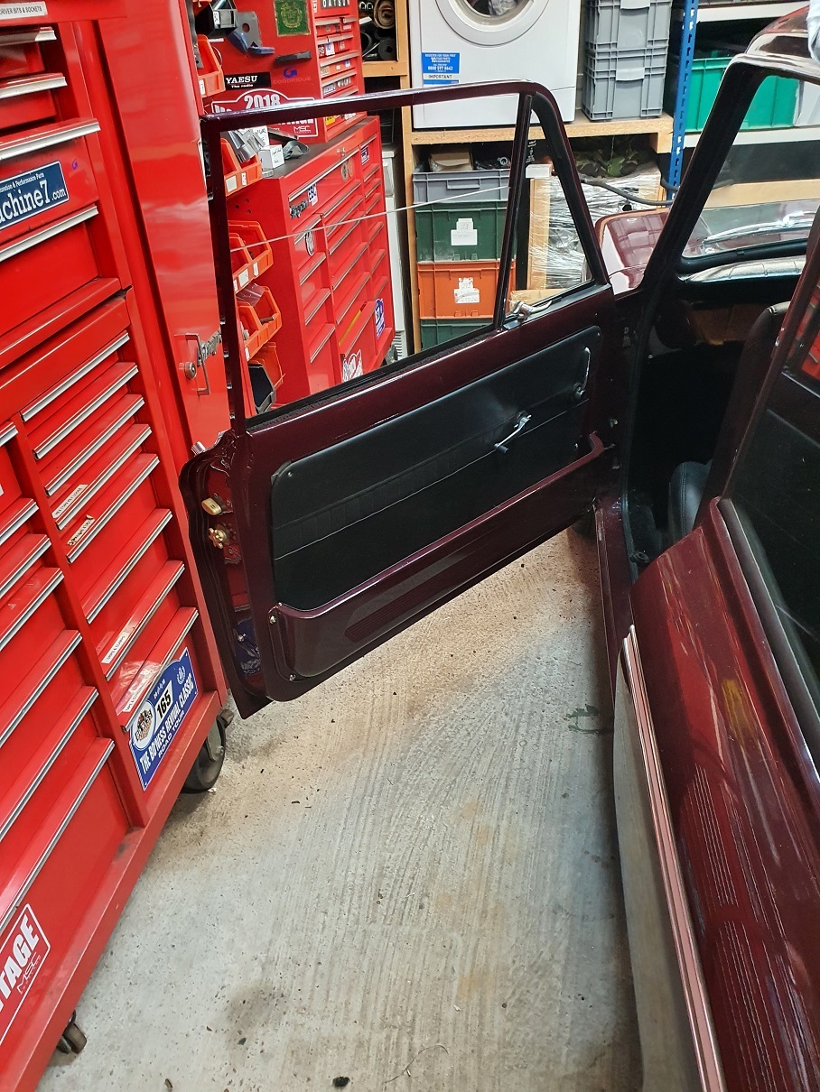

Even managed to get both door cards and pocksts on

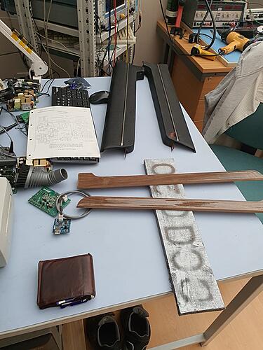

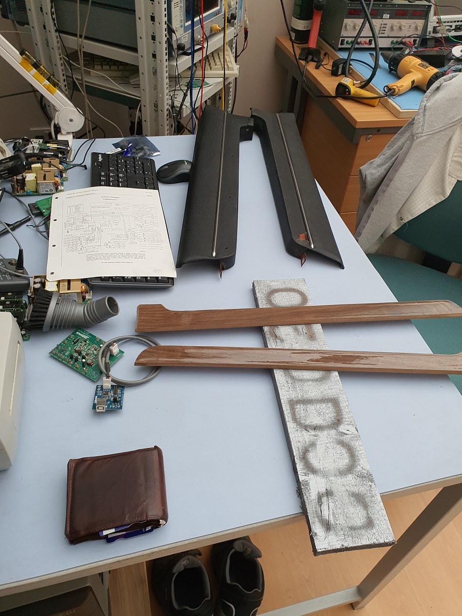

The rear and door cappings are far off yet as I need to refurbish some timber veneer first as well as the dash peices.
Dorr cards are slightly thicker than factory but latting off the back of the handle covers sorted that
Door pockets are of course on with stainless rivnuts and screws Dave Lane

Lesleys door cards turned out very well, there was a comment that they were stitched and not embossed however the fact that they are stiched gives it a classier look to me.

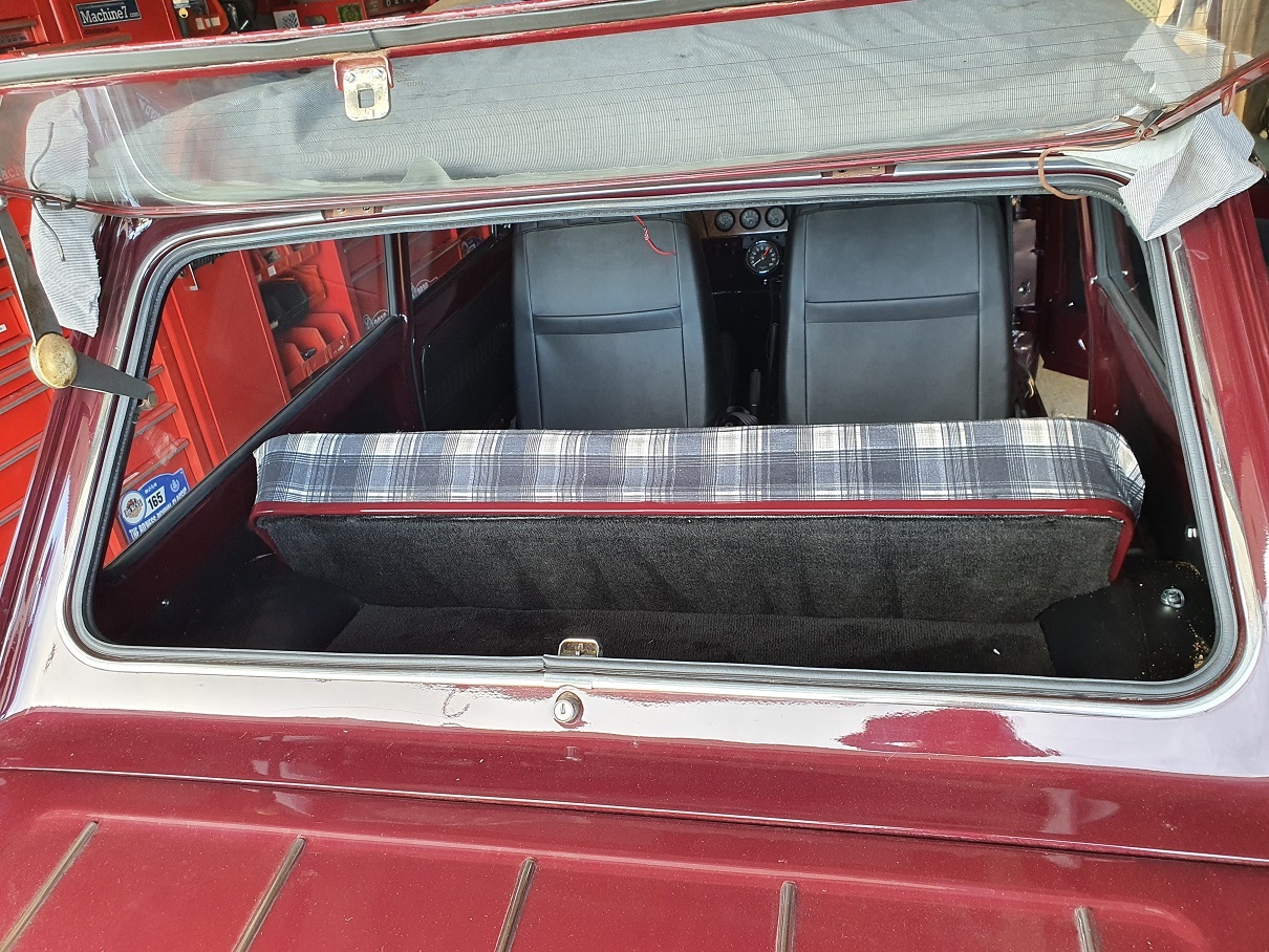

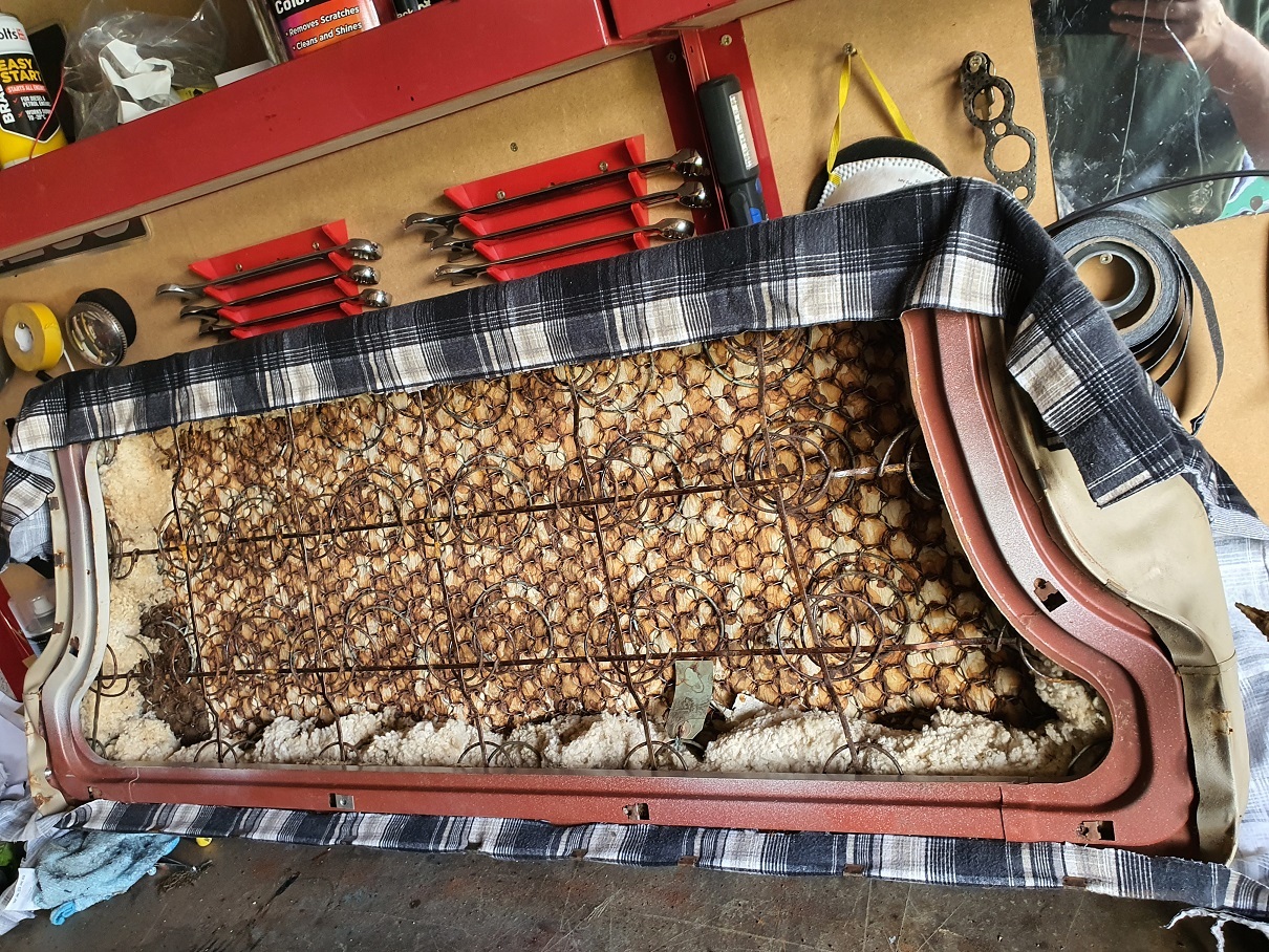

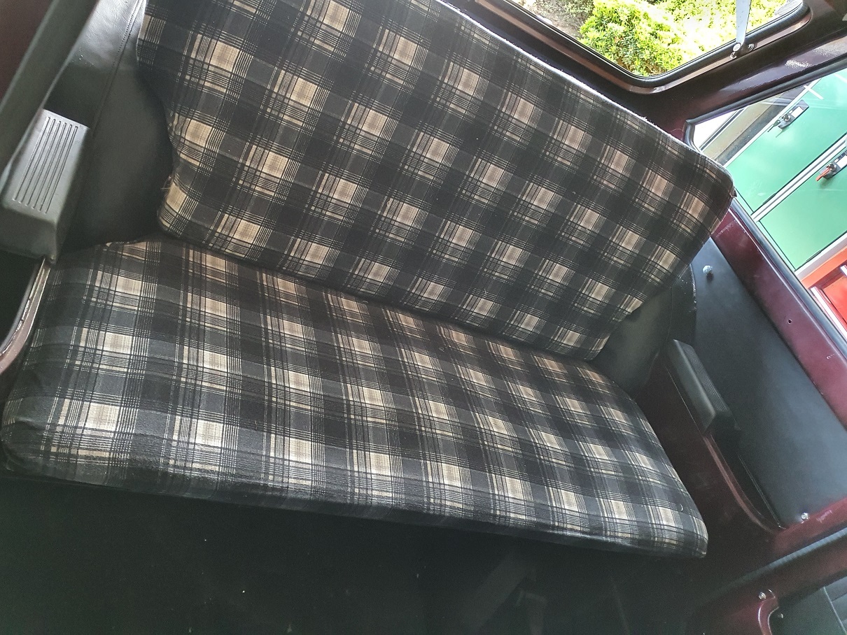

And temporary seat covers in place, not a very tidy job but it will do.
The seats are not worth recovering, the base one especially the spings ar so rotted the break if bent.
I quite like the pattern myselfalthough not sure Lesley will see a trend in these anytime soon. Philgsmith
New seat base and back in the works though and I will get them recovered properly
Inbetween started on the rear cappings
Sanded countours properly and gave it its first coat of clear to let it soak the sanded areas.
This will be a long process of coat, bake, block, coat bake, block sort of a groundhog day for clear coatUncle Henry

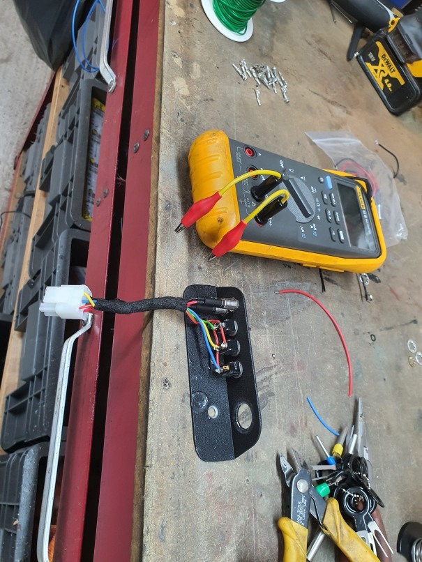

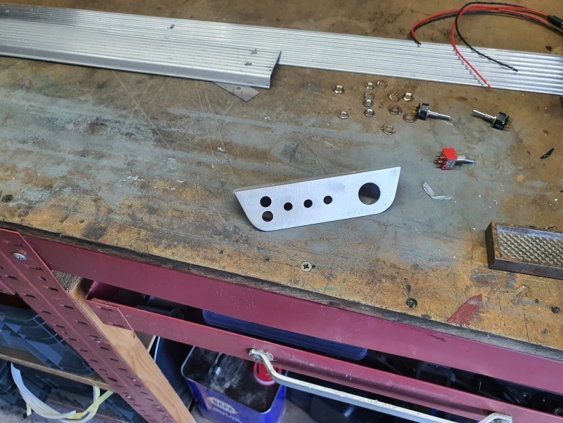

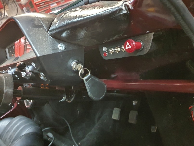

Time to tidy up my messy wiring

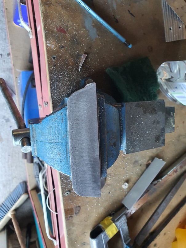

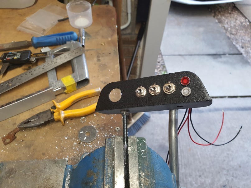

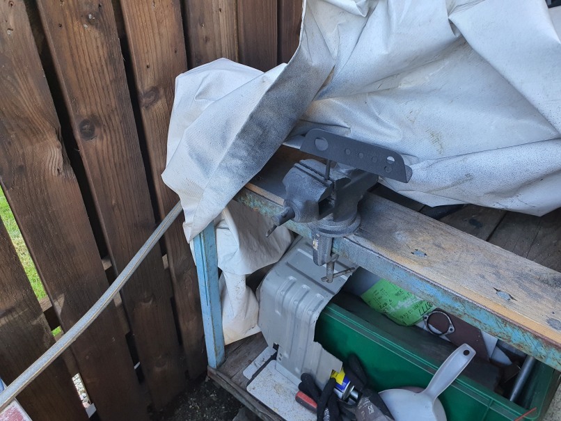

First the bracket, tried to keep an oldish look to the shape (plus I broke the plastic one I had)
I wanted a sort of old scholl speckly powder coat done badly look.
So heated up the bracket a little and sprayed from a distance, then closer and final a satin clear coat.

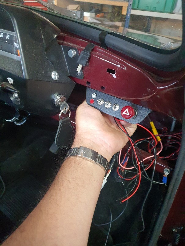

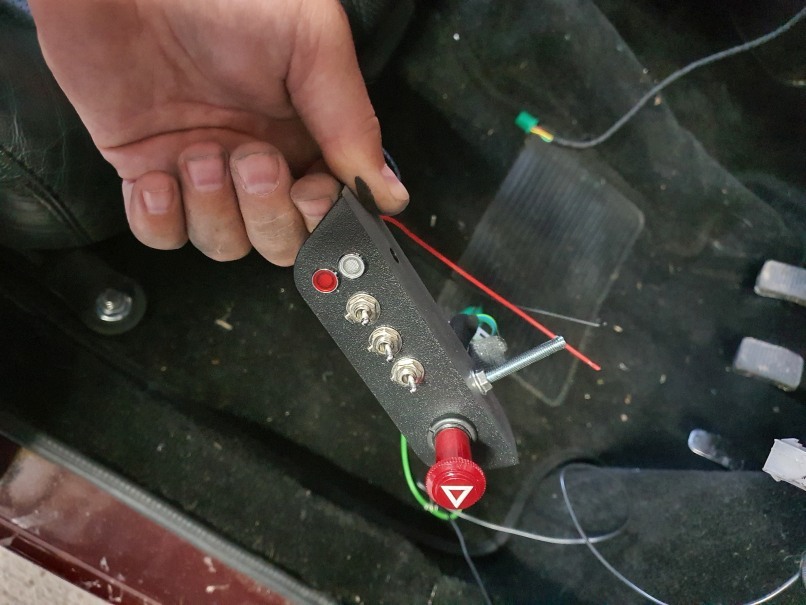

And the final stages
Panel ready and plug fitted

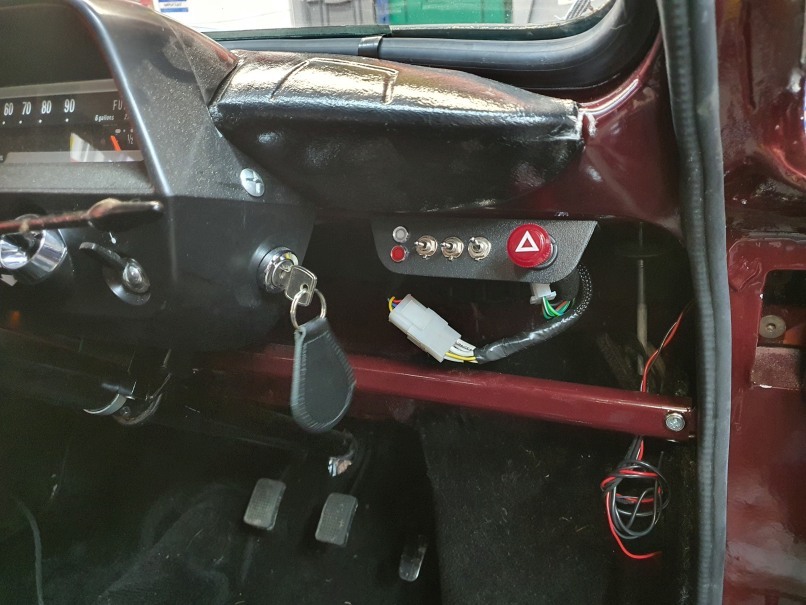

Fitted and tested
And final loom tucked up and tie-wrapped away.
Need to find the other end off the front courtesy light, found the door switches and the rear courtesy light but no front
There is one other hidden button that does something special.
Had planned an ejector seat but changed my mind to something more useful. Cheers Andy
