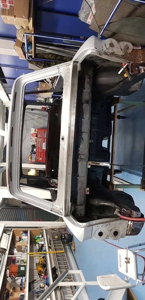

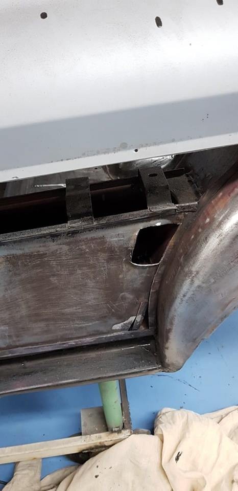

OK, so back to slicing and dicing and all thae fun that goes with it.

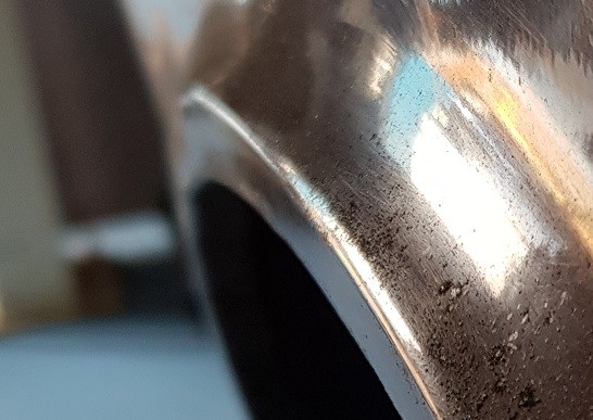

The sparks that no matter how much protection you wear ends up in your work boot, the cutting disc dust that ends up in every crevice, like sand on beach, enough said !

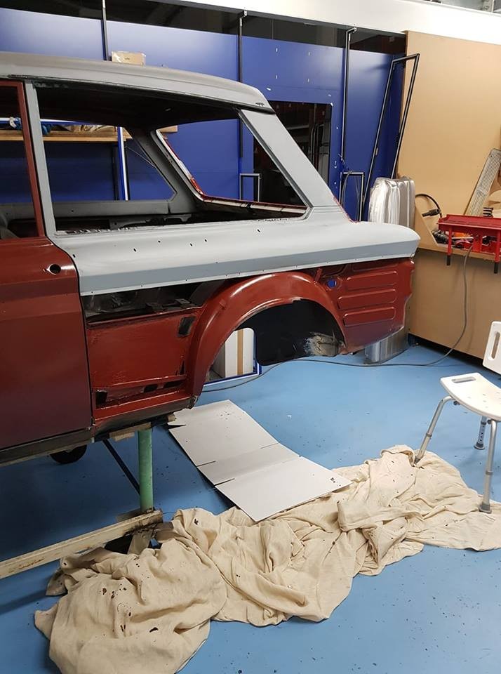

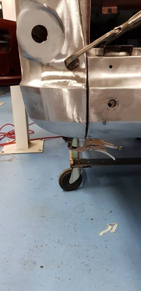

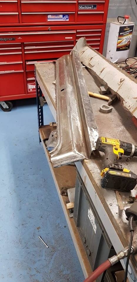

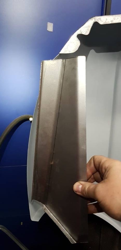

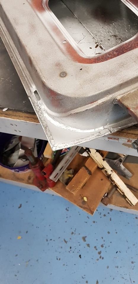

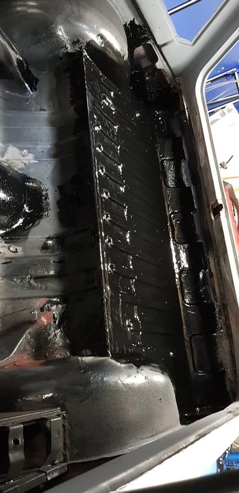

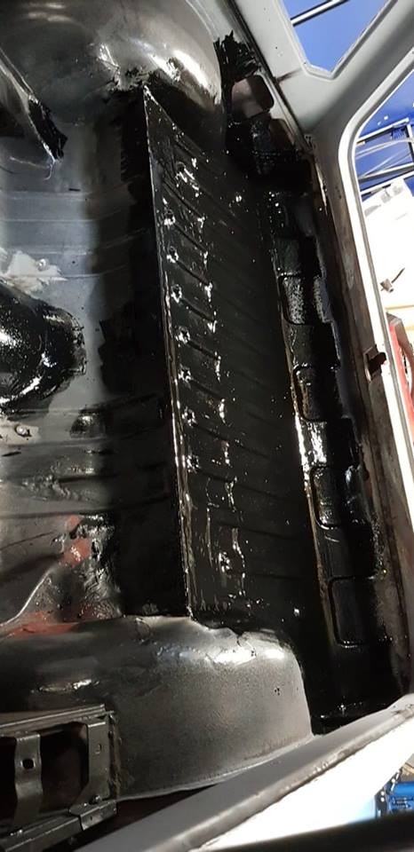

Fits the replacement panels get treated to a wip down with 320 grid, acid etched to leave a keyed surface and zinc coat, then a couple of coats of 2K rust blocking epoxy that binds to metal like crap does to the under crackers.

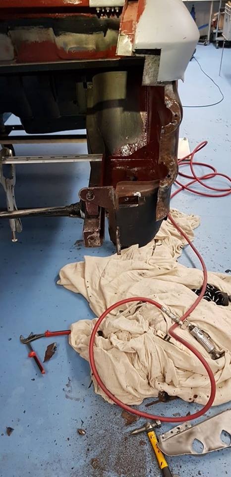

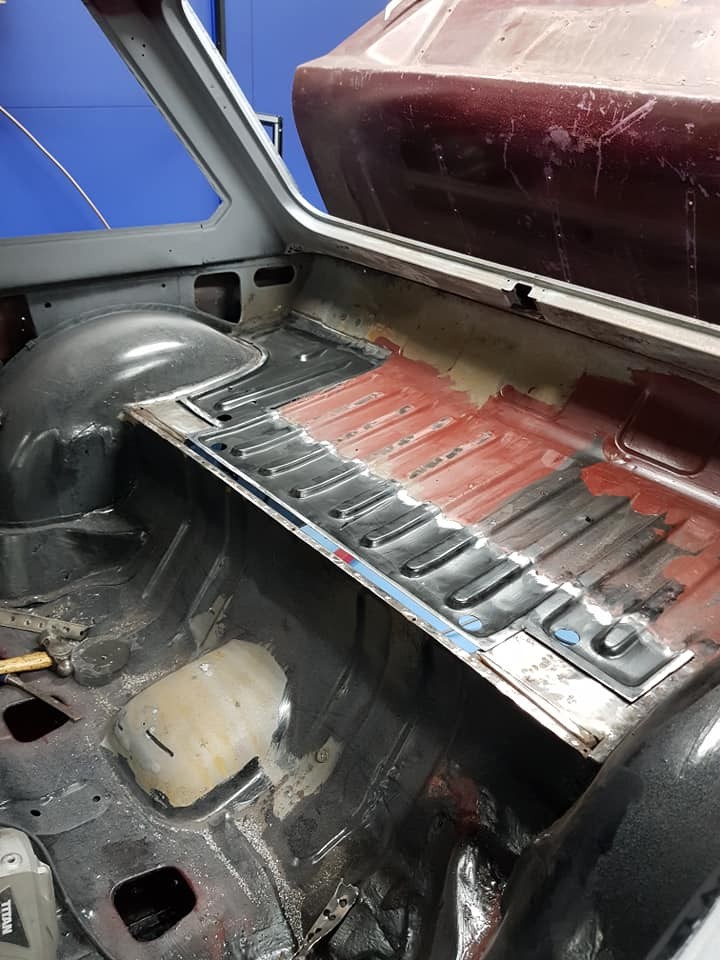

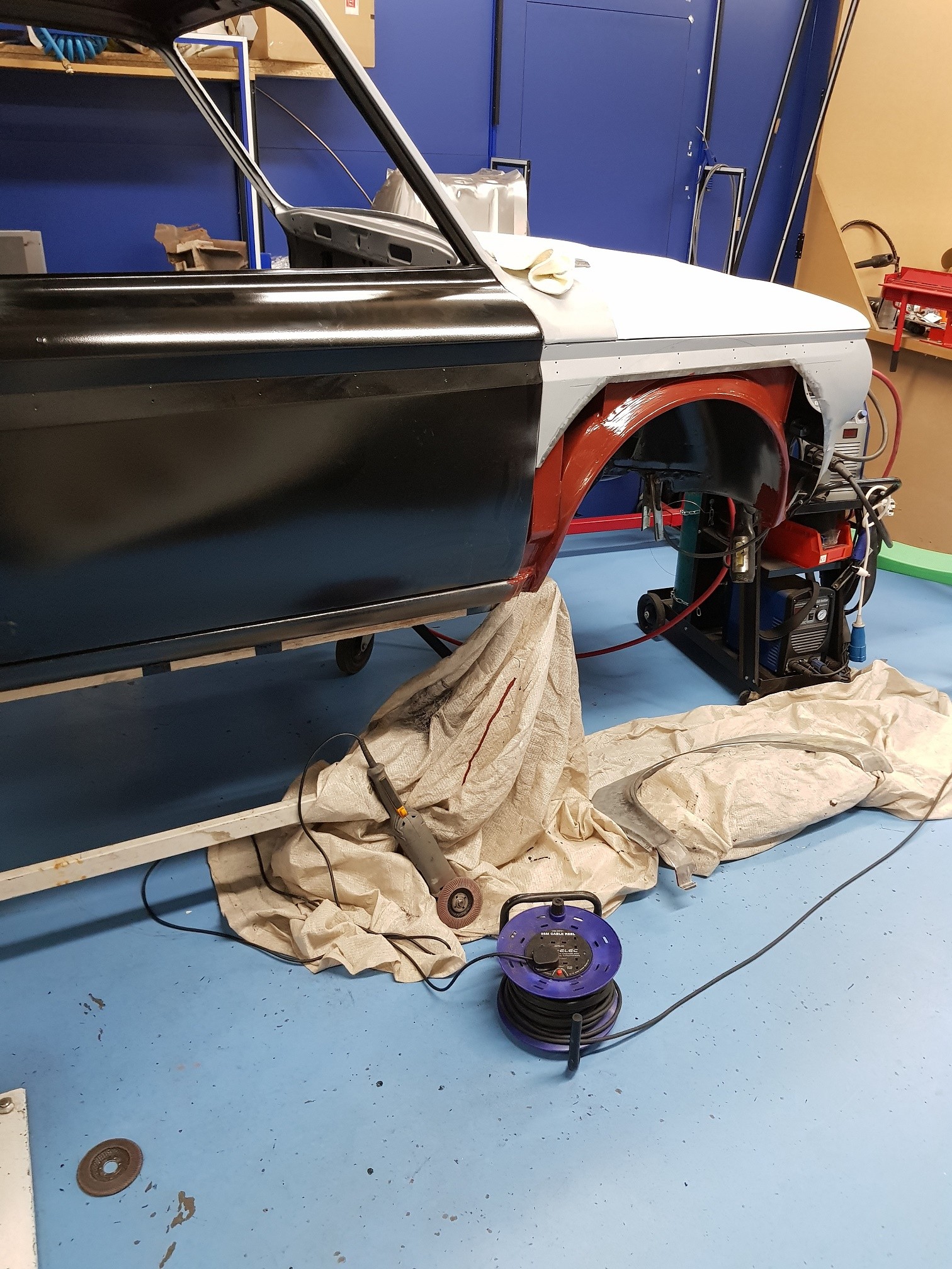

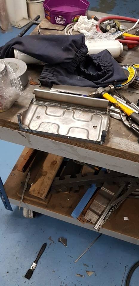

2 of these and 2 of these

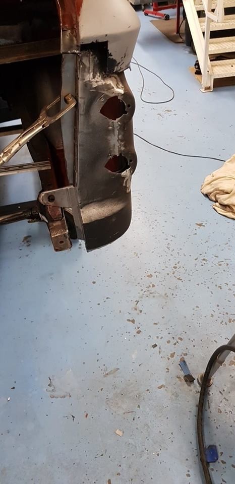

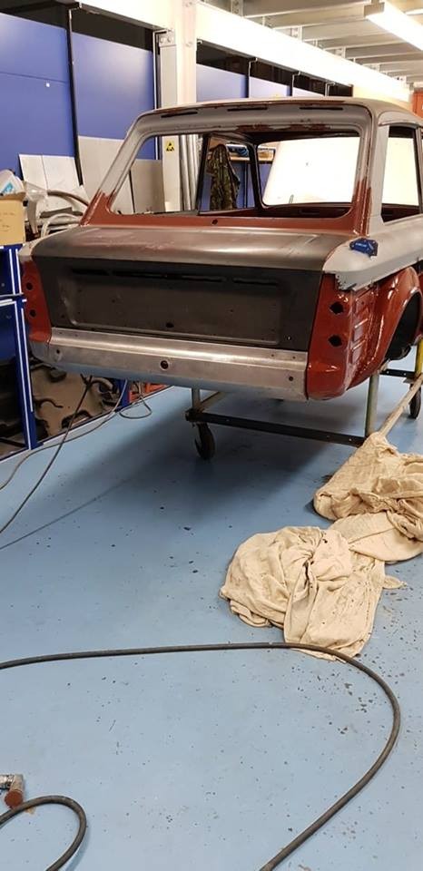

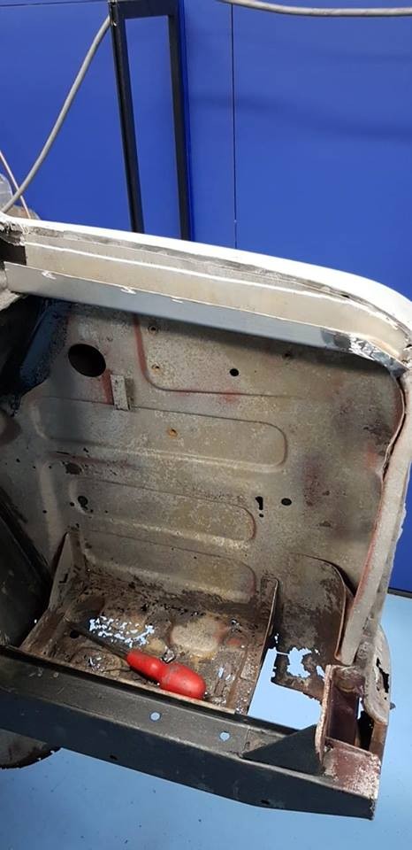

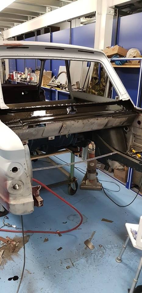

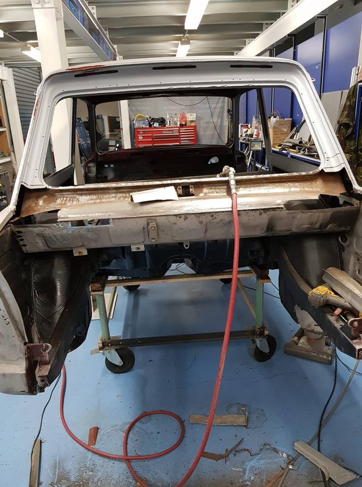

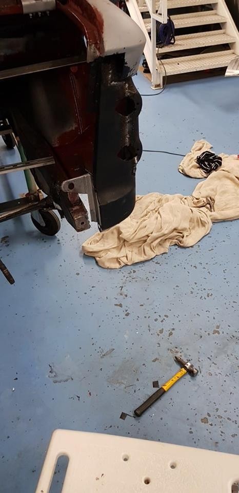

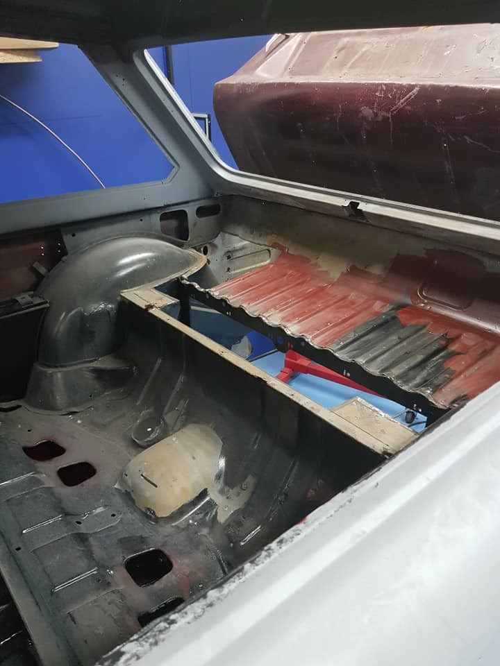

Thats all 4 corners sorted, but wait, door repairs and doors needed for setting panels
