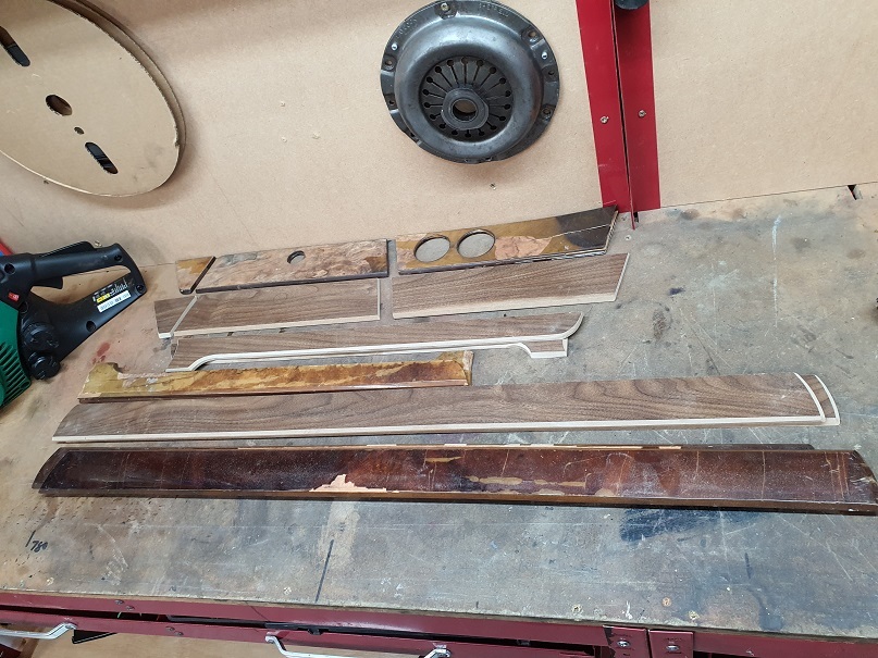

Brian eventually got my cut/planed varnished walnut panels back to me, so a bit blocking of the edges and a few coats of 2K varnish and should be much better than they were.
As the veneer is already varnished that saves loads of crap as when I did the last ones out of stained oak the timber simply soaked up all the varnish and the putting was just terrible to block back out with fine grit.
Here is hoping this works out better
Started out as thin high gloss laminate flooring which i picked up from discontinued line at local carpet place
