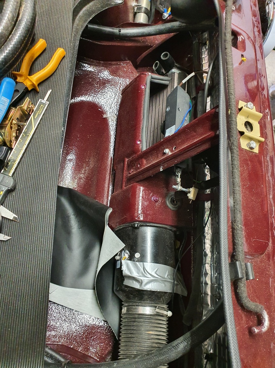

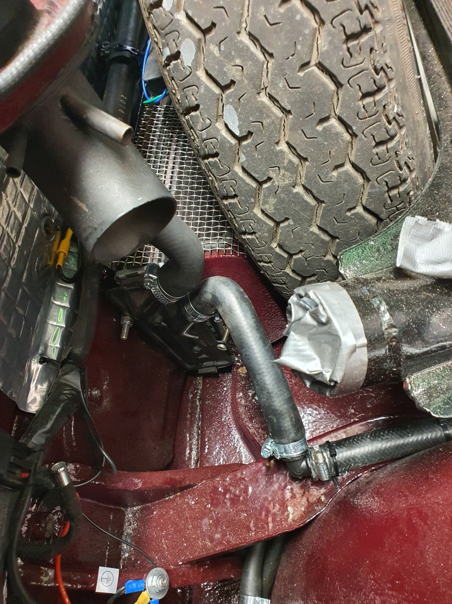

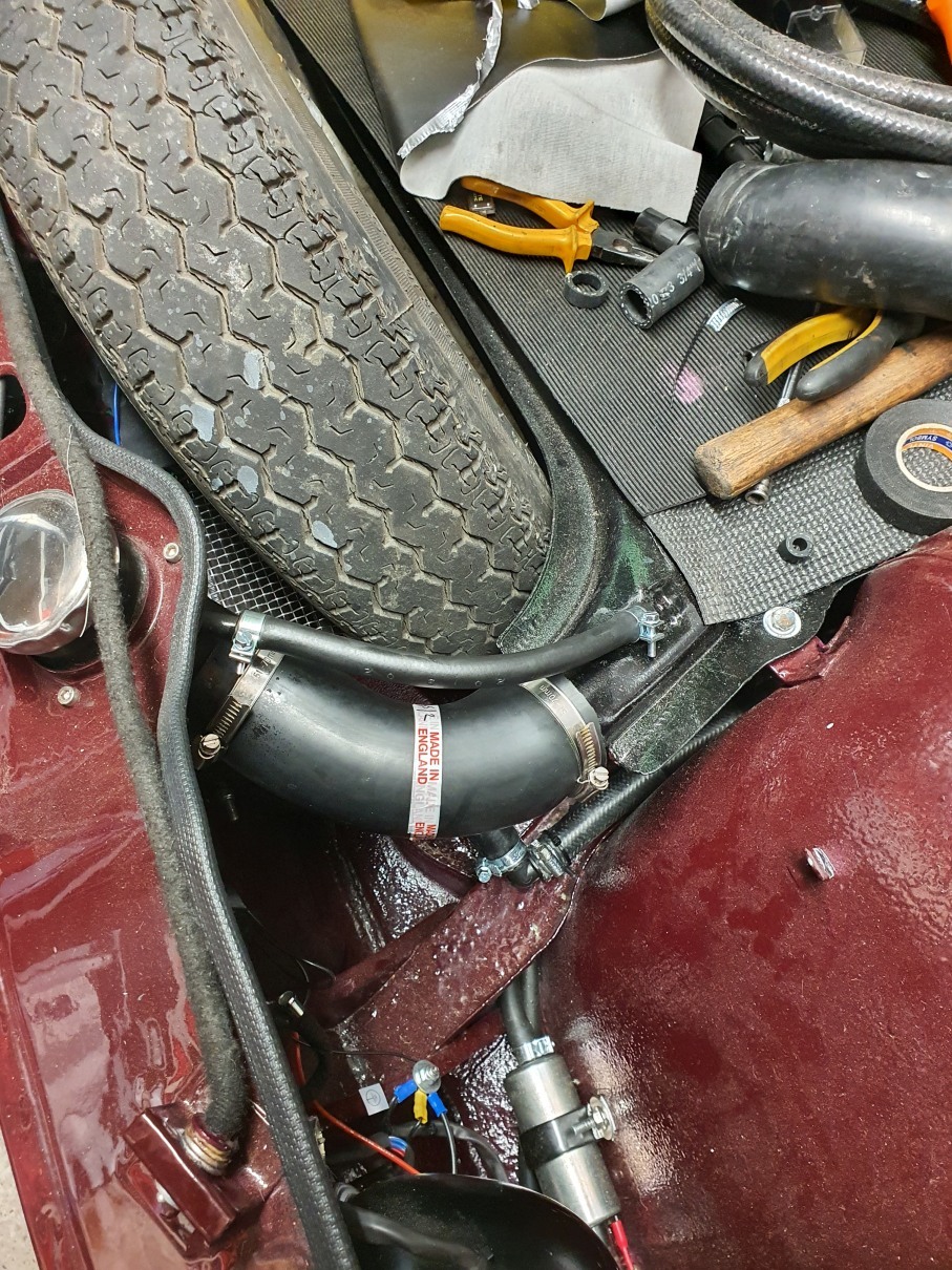

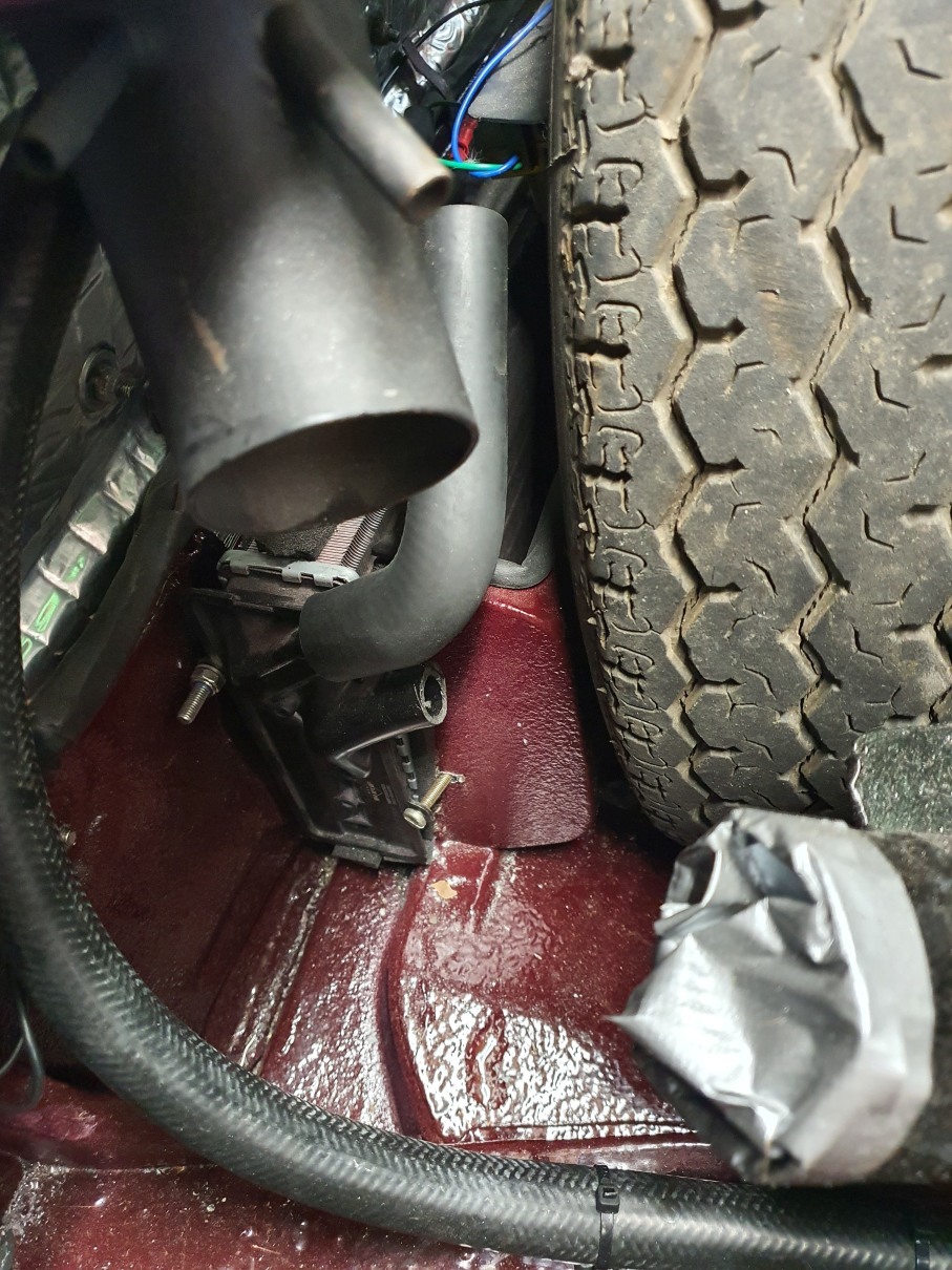

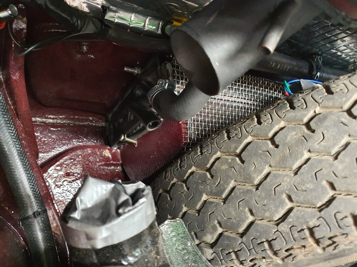

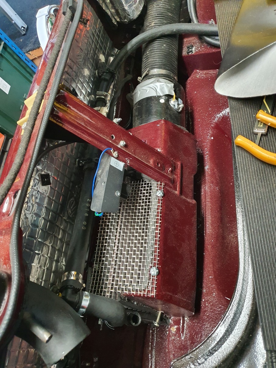

Today I ended up back in the bonnet area -
The aux rad solution i picked presented a few challanges as regards entry/exit of the hoses as i mis-calculated the spare wheel clearance (well i need to own up to screwing it up really
So a couple of 90 deg bends and some trim back on the rad end, sorted and done.
Nice clearance now
Then onto the heater air exit, time to fit the stainless grille to stop anything falling in there.
And the last one fitted, down onto chassis rail
So thats the rad solution sorted.
The AUX rad is a heater matrix from an Audi A3 and fits perfect with a slot between the left hand side of heater box and the middle divider on early cars.

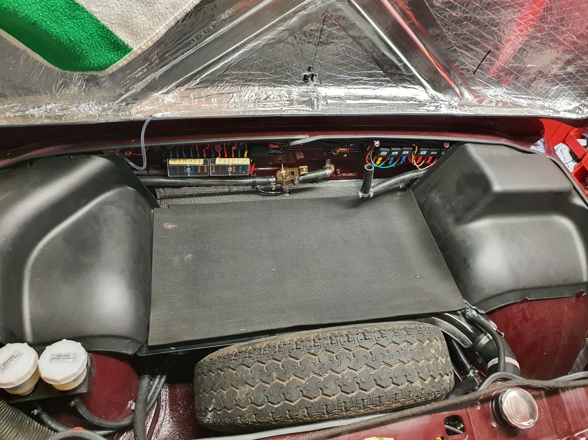

And while I was in there and now that area is sorted, its was time to fit the fuel filler neck and return, the breather will go in tomorrow

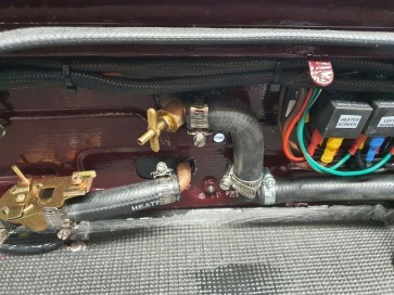

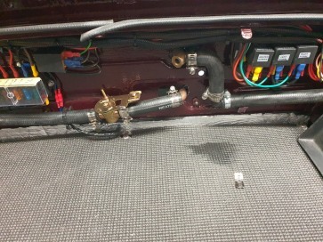

last piece of the puzzle would be the heater connections, ONE BEND SHORT
and 3 hose clips
So again need to wait.
Nice clearance now
