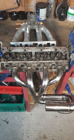

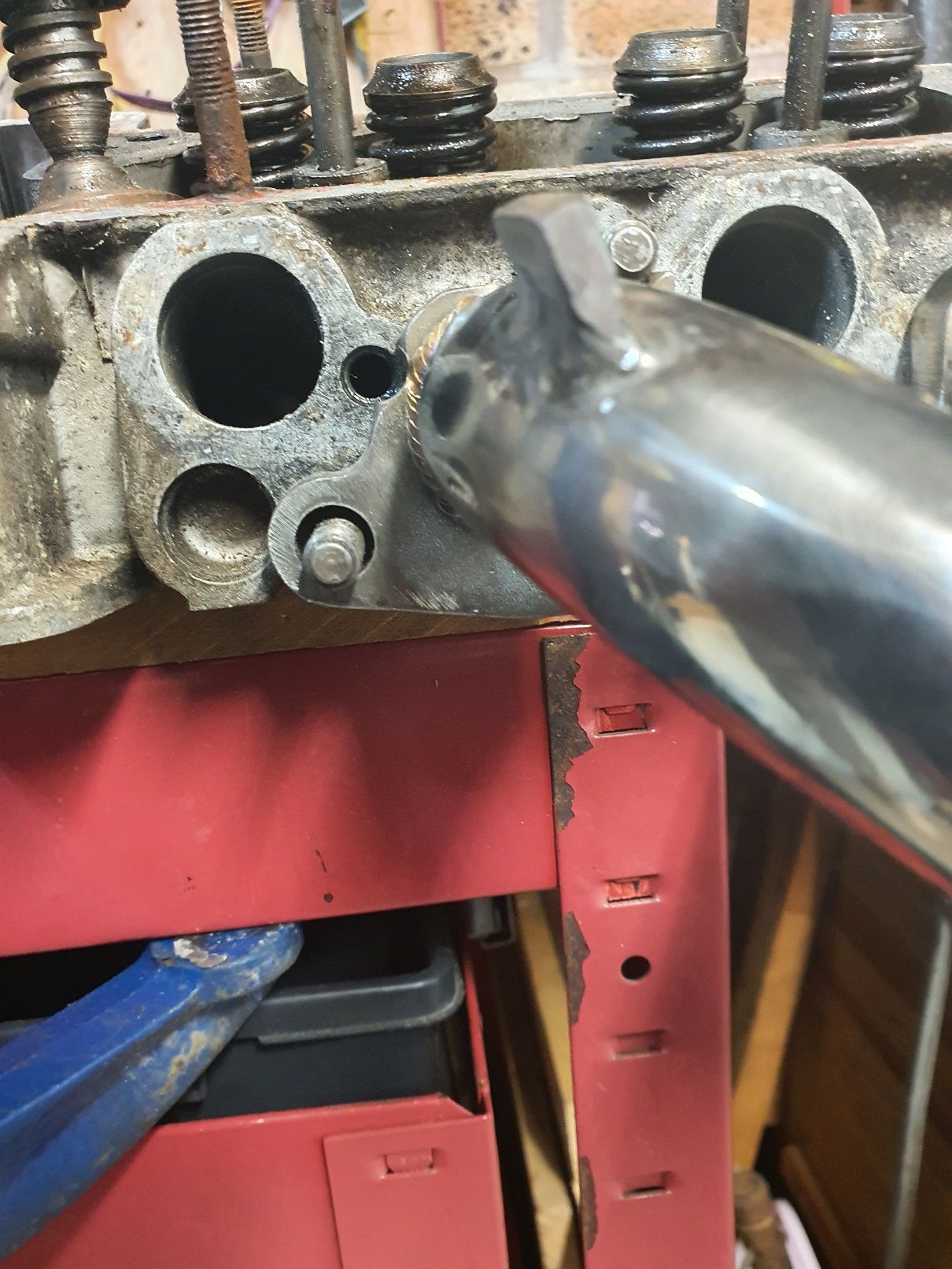

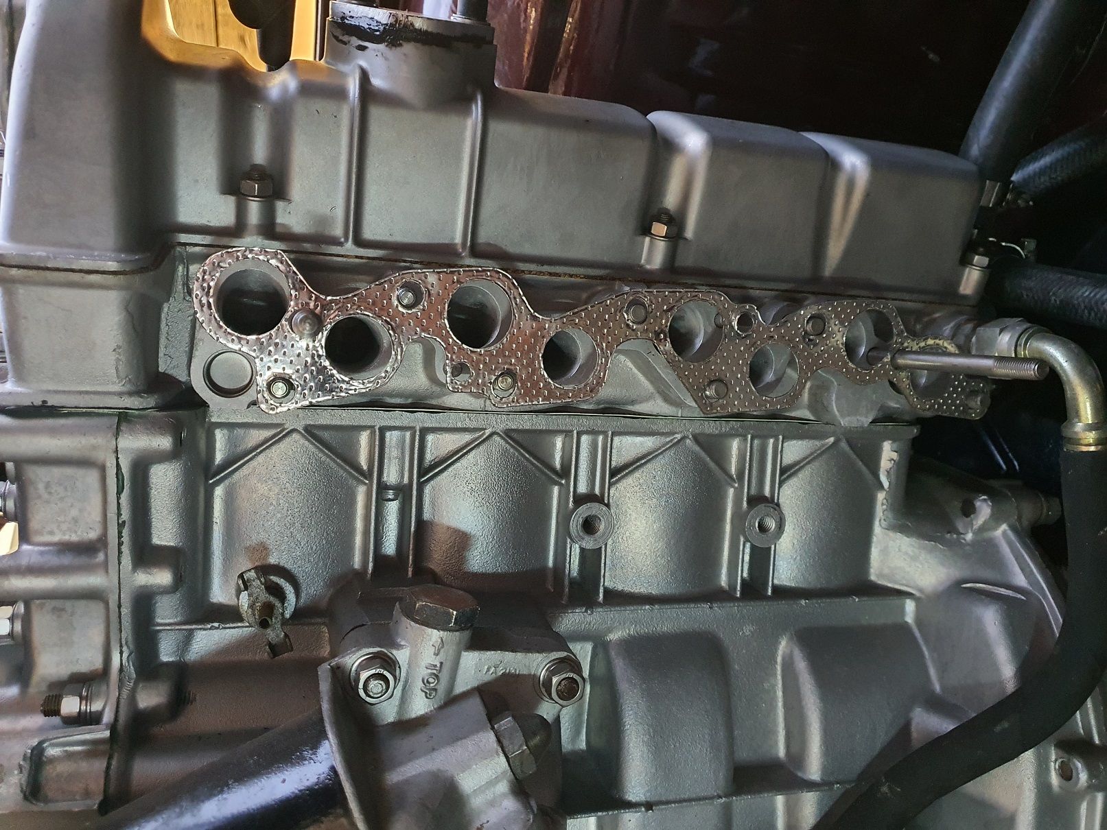

Well the exhaust manifold was offered up to the head along with the 28/36 manifold and it fits like a bag of odd bolts.
Terrible.
So tomorrows job will be die grinder, cutter and big hammer. OK, maybe not the hammer but thats my favourite tool
Not doing it upside down so spare 107 head bolted to edge of bench
Need to fit some kind of centre dowel to line up or at least check the ports exit to centre of primaries and then find a decent insert to take away the amount of play in the main fixing holes which is massive compared to the stud.
Not what I would expect from something that has beeen CNC cut.
It is what it is now, onwards we go
