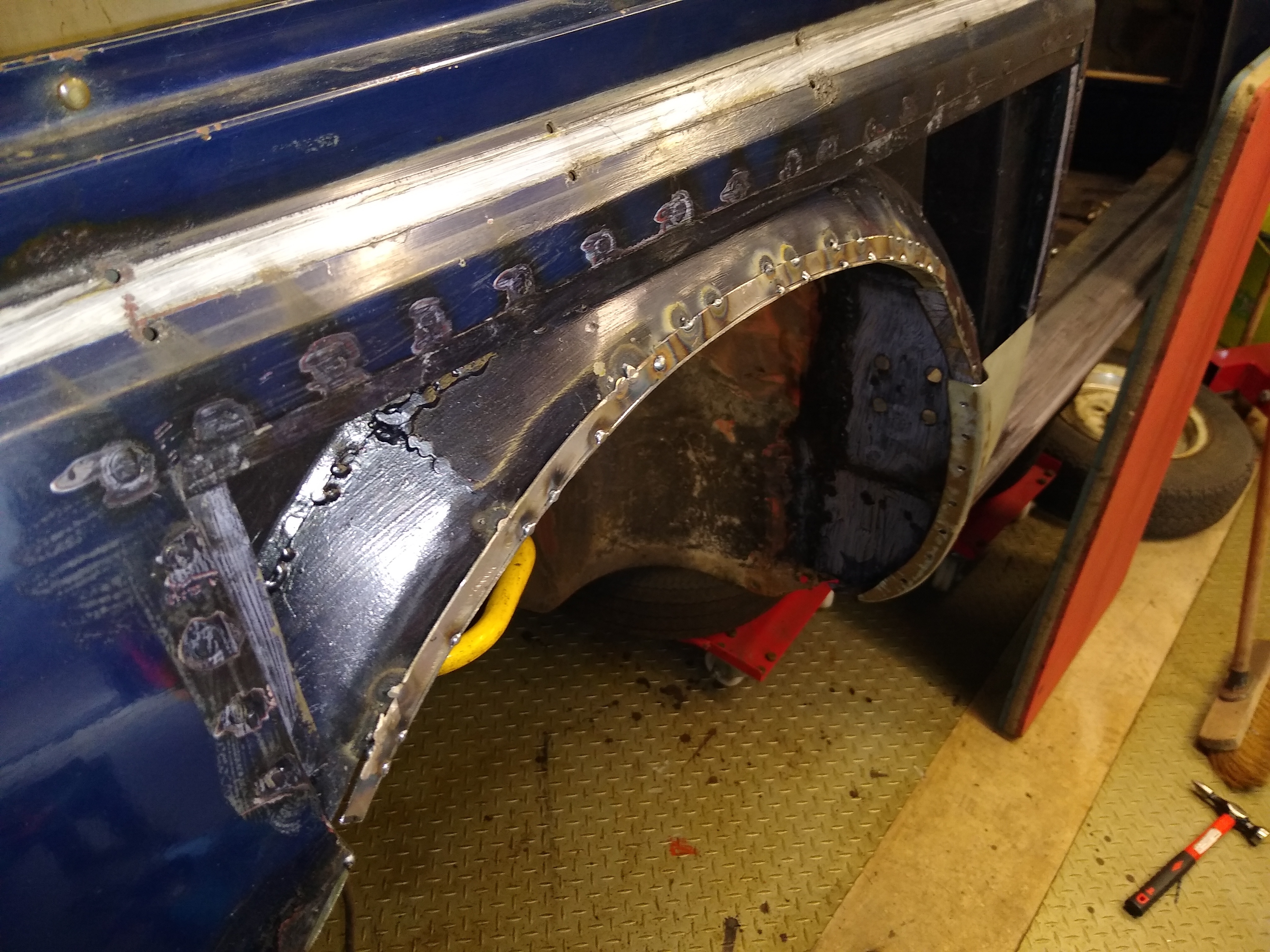

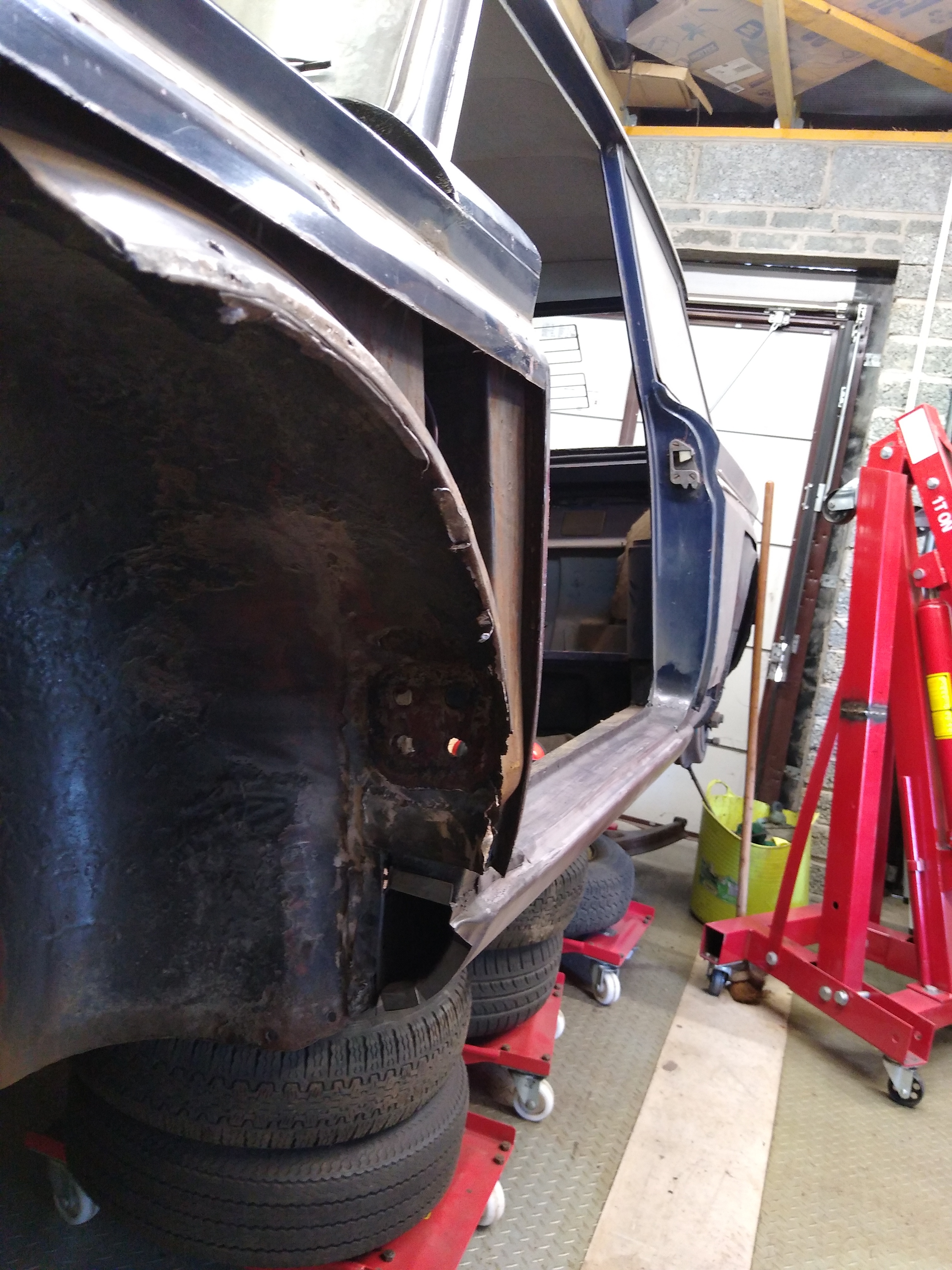

            Going to need a bit more work here. Click image for larger version

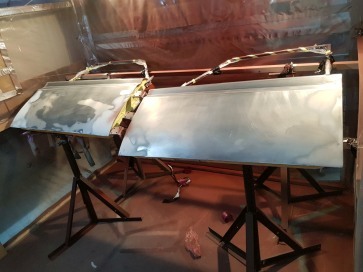

              Door off getting stuck in. No sun for me! Click image for larger version

                Still not that bad Keith could be a lot worse !

                  Yes John looking on the bright side! Just a bit of metal needing stuck in.

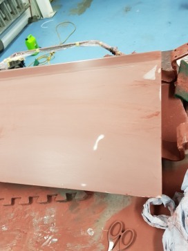

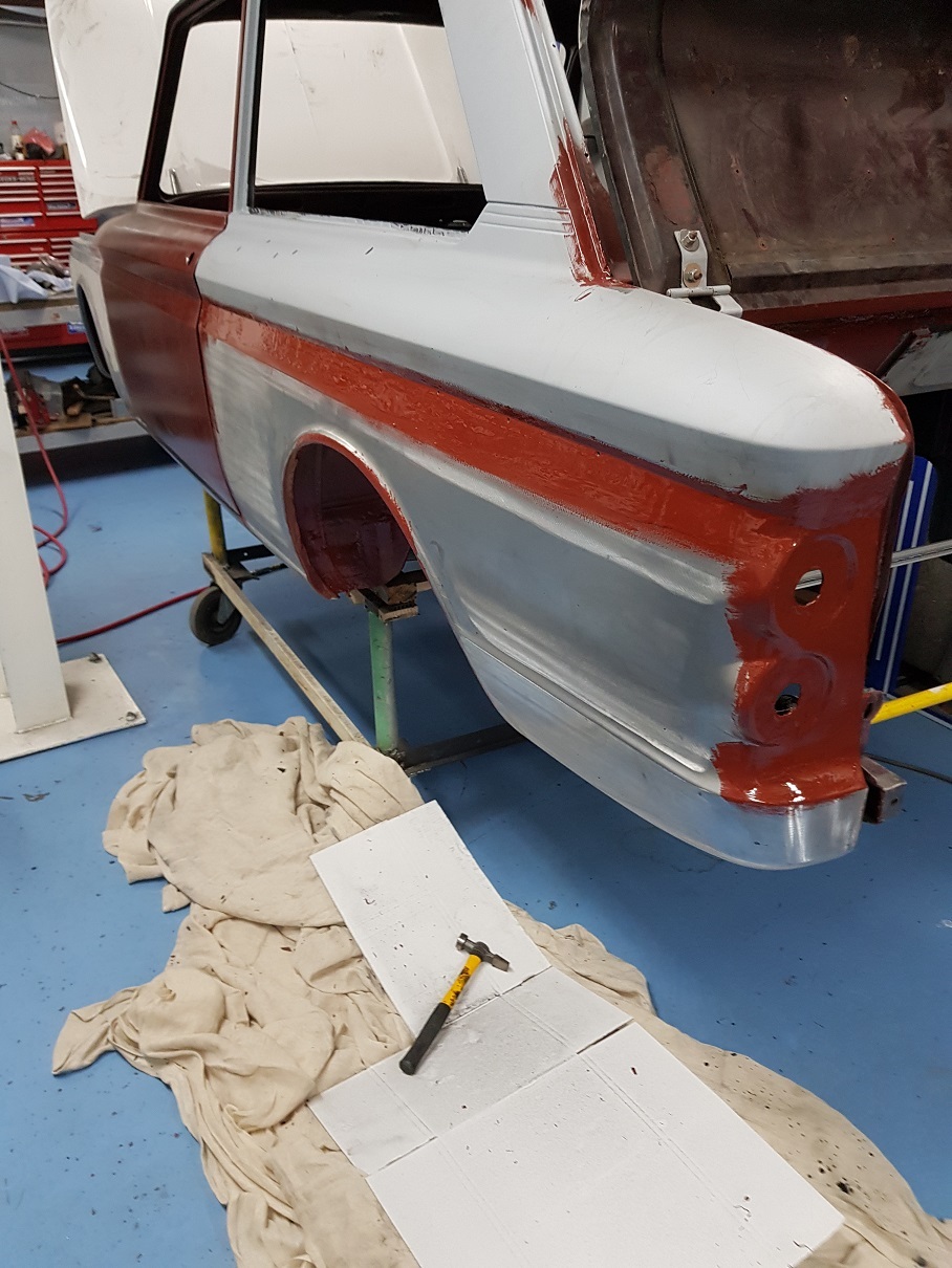

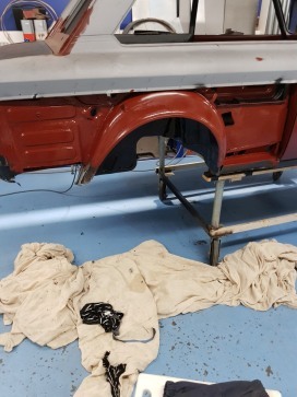

                      Taks some surface material off with a flapdisk (watch the heat) and some neat epoxy filler will do the dead and seal it at same time, you can always add some masking tape behind most of the rear wing/door ones but they do fill up nicely, for thos shallow areas some neat epoxy brushed in I always found had much better adhesion and fine filling properties to the white stuff.
                      Here it is "abused" ( I can here the purist tut tuts from here )
                      Without being thinned it brushes on great and blocks out as easy as a finishing filler.
                      I used it in all the seam joint for the lower 1/2 wing on Millie, first time using it like that, worked out great

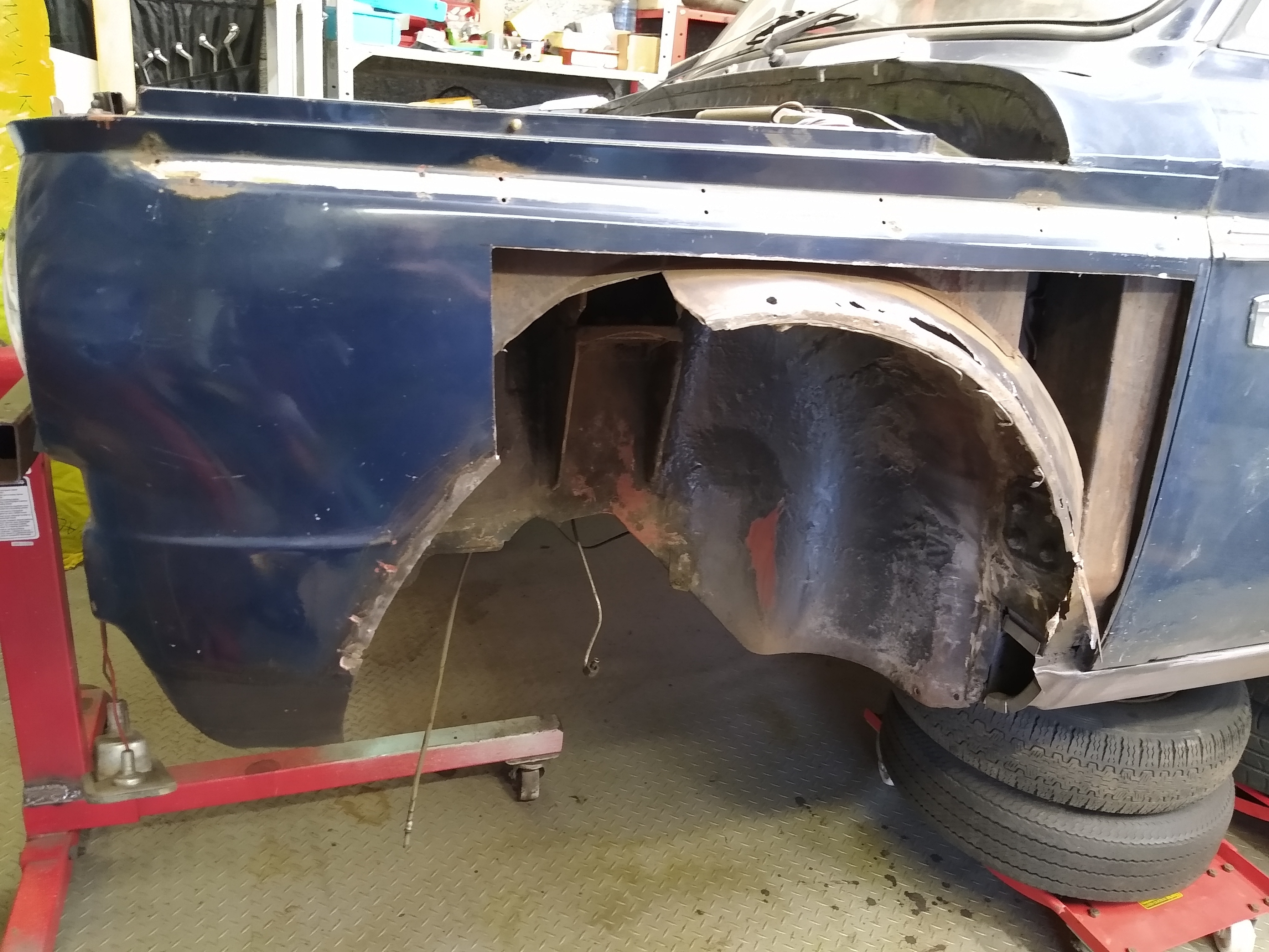

                          Progress... Click image for larger version

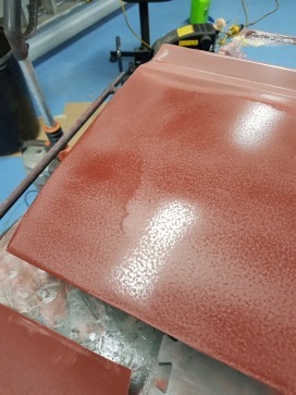

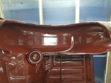

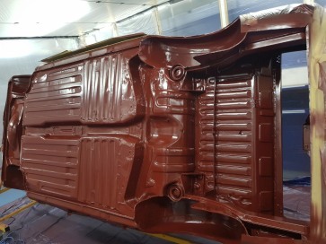

                            For suspension, underneath, filling etc. I prefer THIS STUFF as I can brush, spray, roller, scoop and otherwise plaster in there it works absolutely fantastic on surface dents as it self levels even in neat form. Brilliant for filling seams as unlike seam sealer it will flow in in like liquid.
                            Absolutely brilliant finish. I chose the "red oxide" colour option as it sort of replicates the original primer layer.
                            Brushed into seams or squirted in from back by syringe, great seam sealer as well.
                            Click image for larger version  Name:	PIC-09479.jpg Views:	0 Size:	32.0 KB ID:	8680Click image for larger version  Name:	PIC-09574.jpg Views:	0 Size:	26.1 KB ID:	8676
                            Here it is on door prep, also makes a fantastic guide coat of its own as well as a fine filler layer, blocked out the semi glosee finish goes matt so its has its own "guide coat"
                            The red or black shows it much better in red or black.

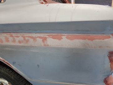

                            Dents and skim (well actual distortion from repair as I was over eager on drivers door its not deep filler but just deep enough that epoxy would not manage it.
                            Click image for larger version  Name:	PIC-09387.jpg Views:	0 Size:	27.7 KB ID:	8677
                            Spray applied epoxy and just a quick scuff to show surface
                            Click image for larger version  Name:	PIC-09390.jpg Views:	0 Size:	31.9 KB ID:	8678
                            Blocked out completely using long bed , great guide coat
                            Click image for larger version  Name:	PIC-09391.jpg Views:	0 Size:	22.2 KB ID:	8679

                              Arch back in one piece, progress indeed
