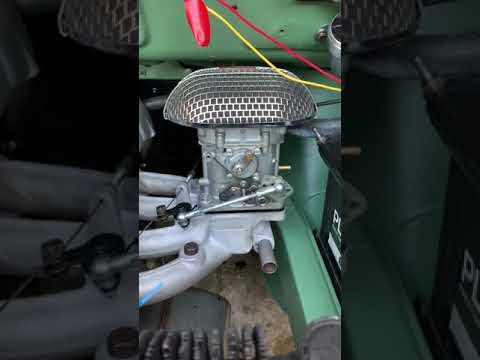

video of carb linkage working. This is with carpet removed. Is that fully open? Sure as hell drives like it is.
Managed to bleed the clutch in the end, had to remove the slave and make a tool up to hold the piston back. Once I did this bled after a couple of goes.
- Likes 5
Looks to be. Best to check by getting someone to press it to the floor and you try and see if you can open throttle on carb more. You can adjust the throttle linkage on the round bar between the two ball joints to shorten or lengthen it. you want to make sure you have full throttle with carpets in but also check that if you press hard on pedal into carpet you are not bottoming out the linkage and straining the cable.
