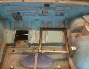

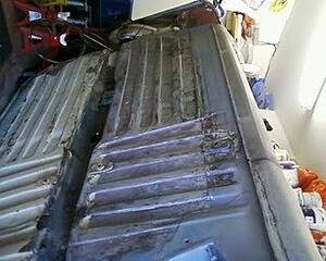

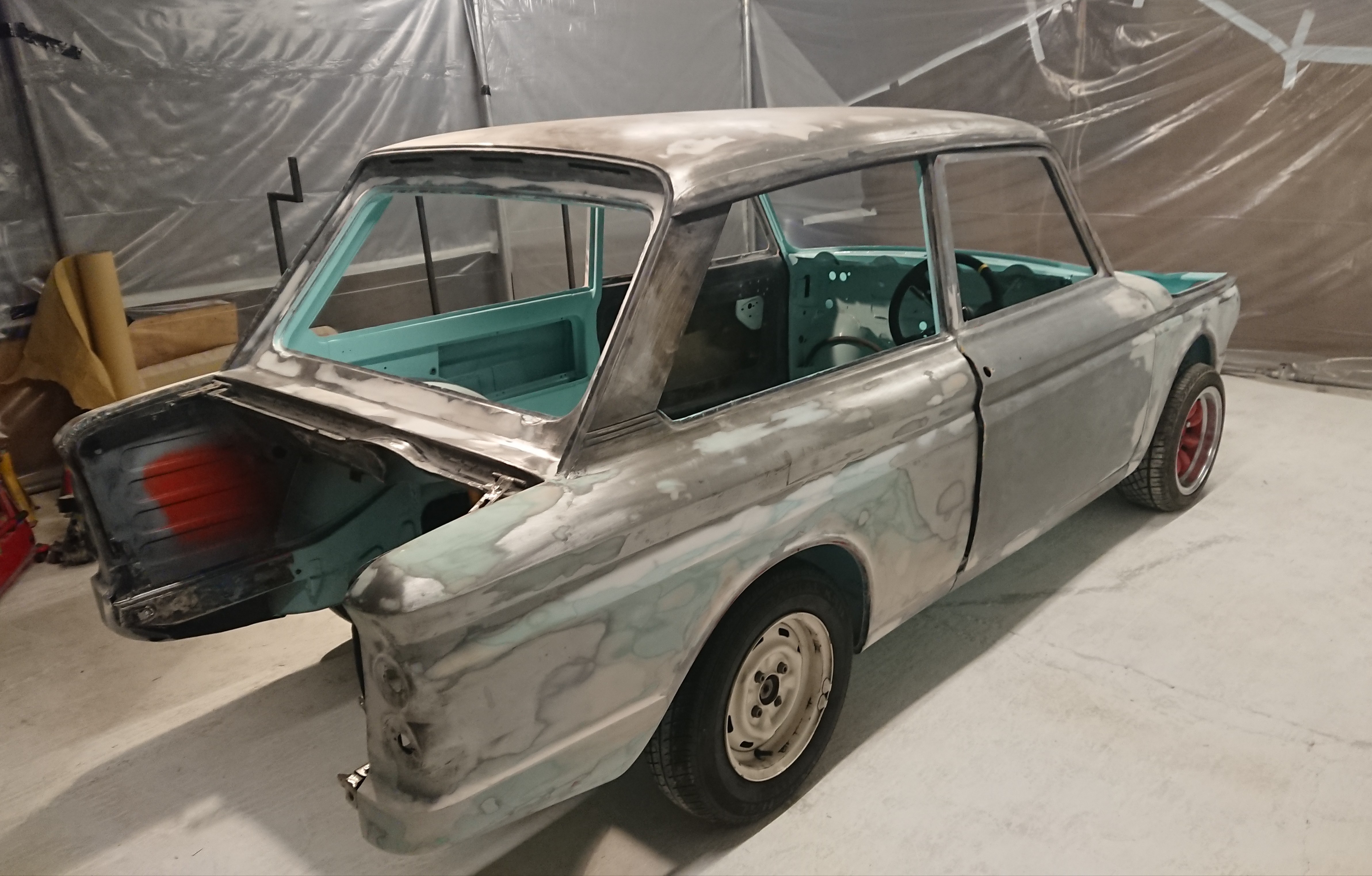

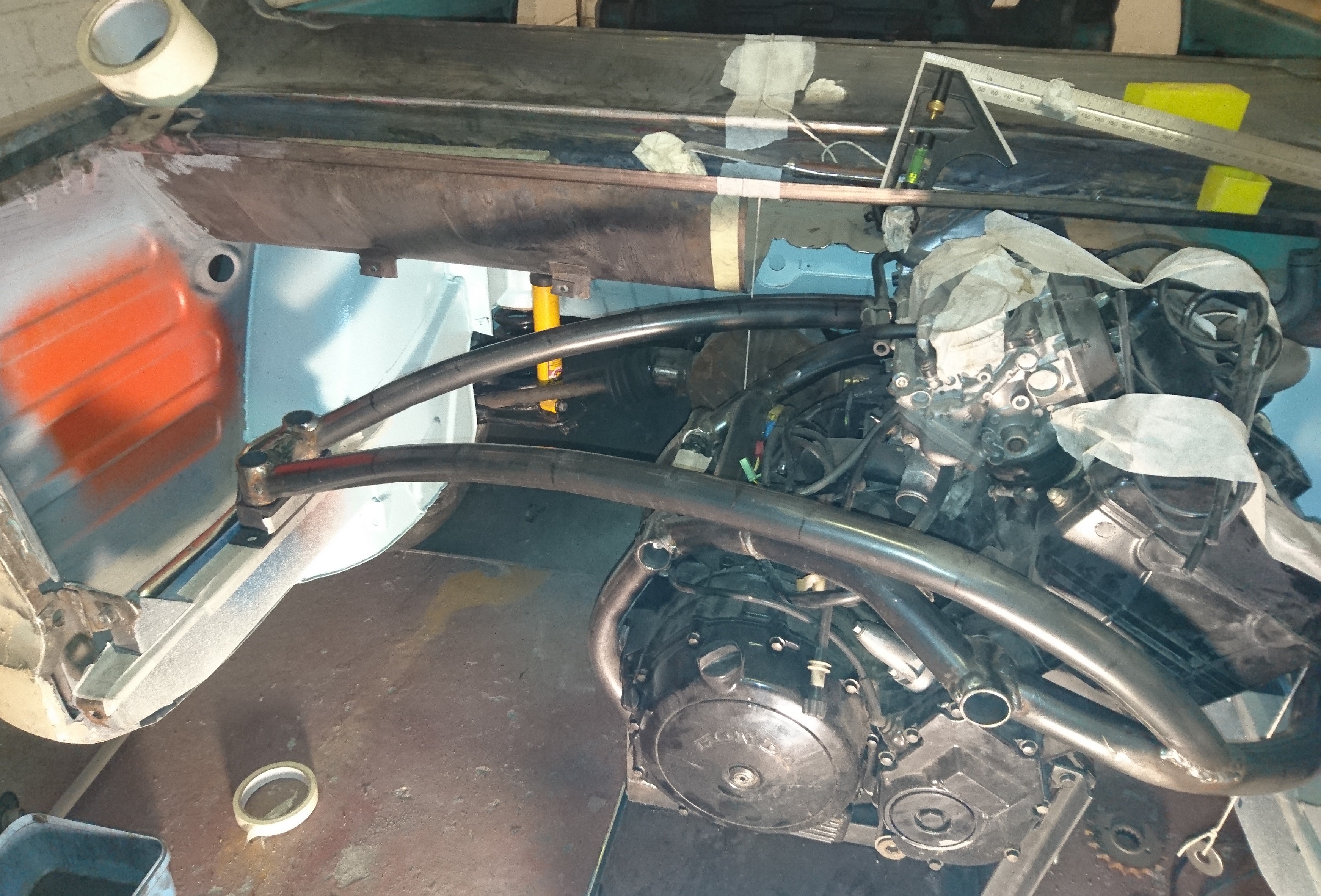

Well that was most of the structural rust and repairs done I then got on the case of improvements or things that I wanted in the car. Nice seats for one.

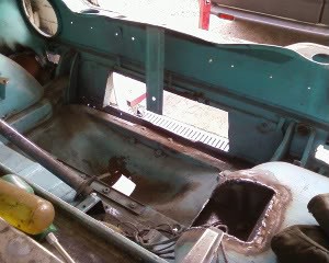

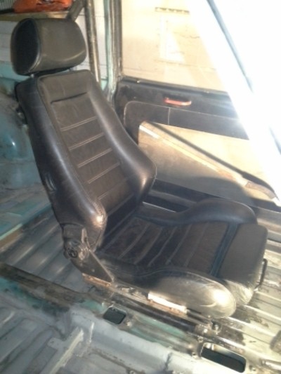

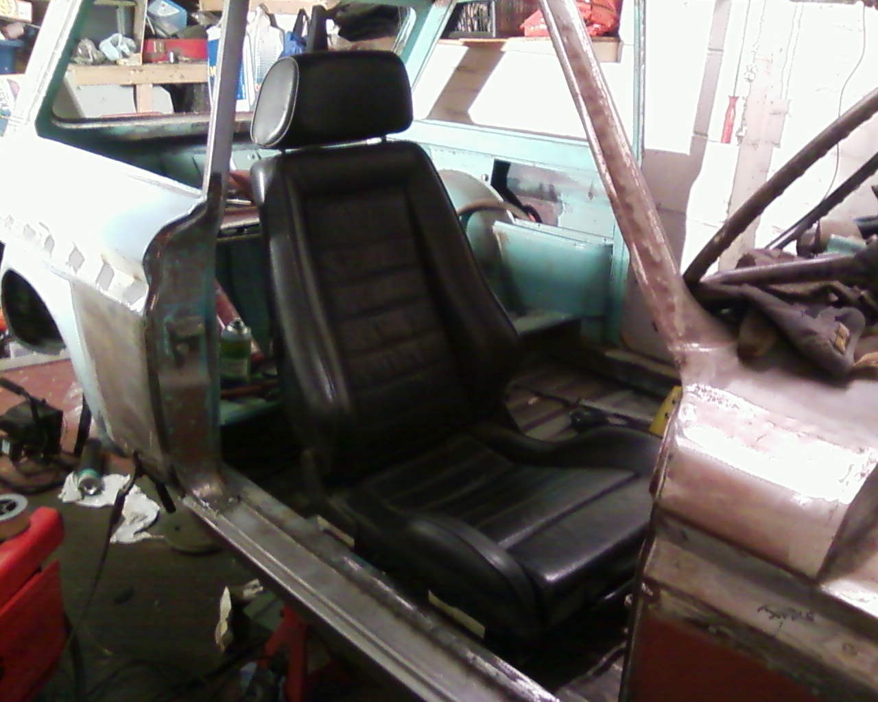

BMW M3 seats came up at a great price... FREE!!!!:D So they were going in no matter.

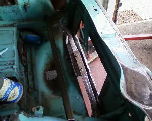

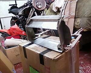

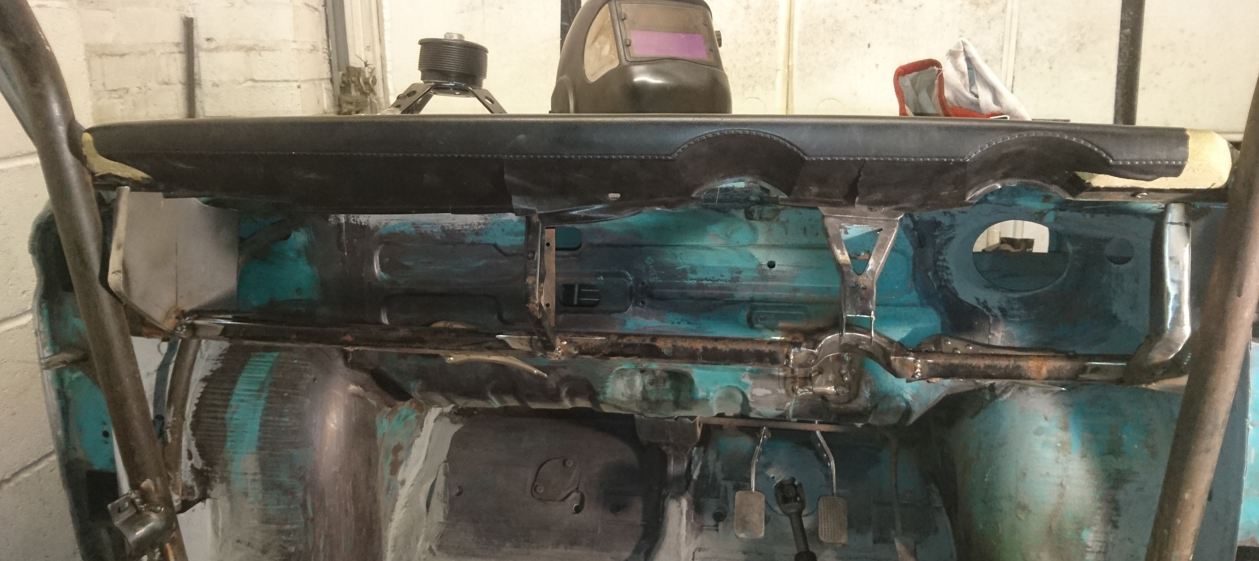

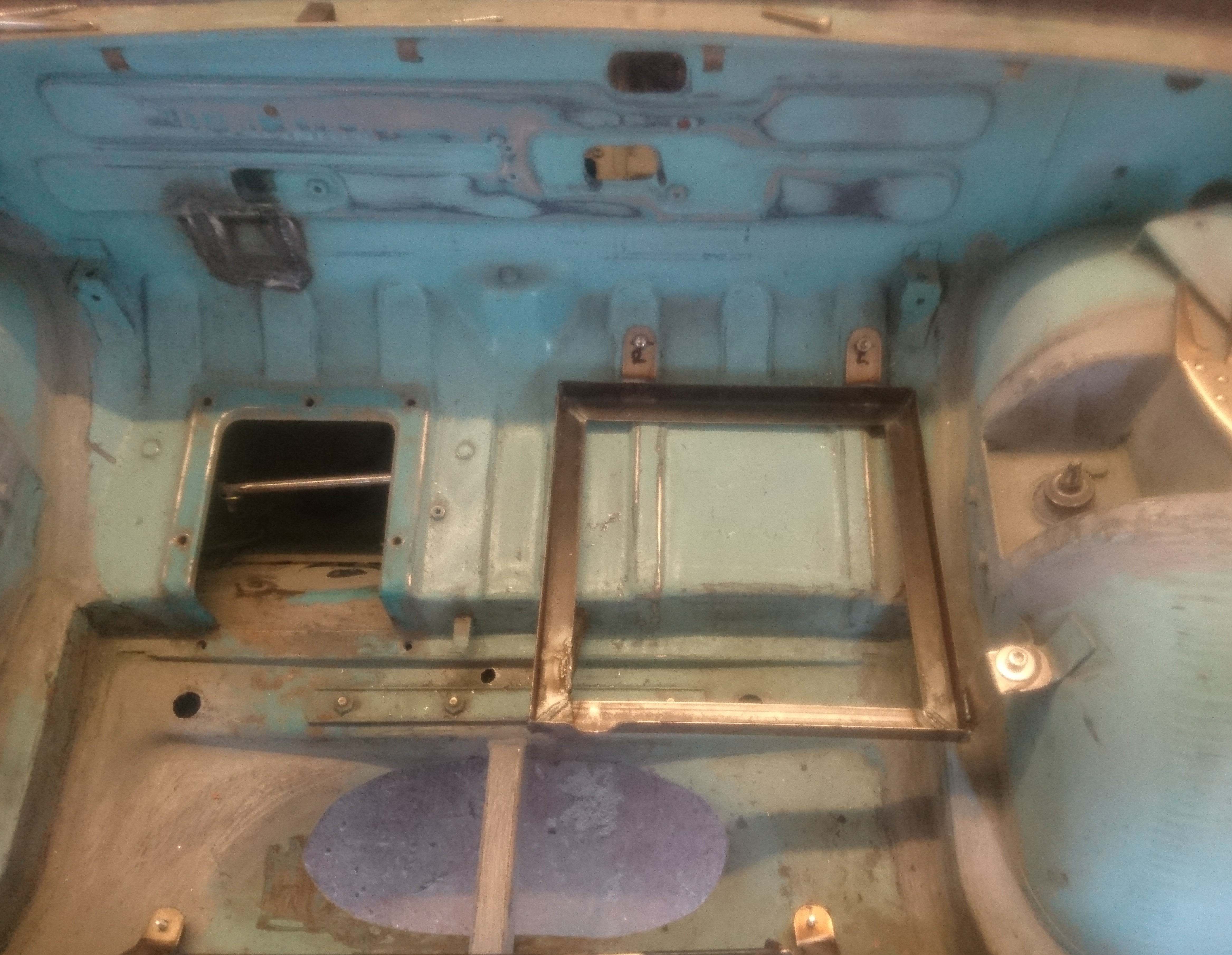

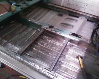

First remove the seating hump that is welded into the heater channel, floor and central tunnel and replace with 1" box section to keep the strength but keep the seats low on the floor.

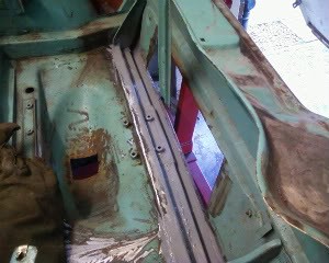

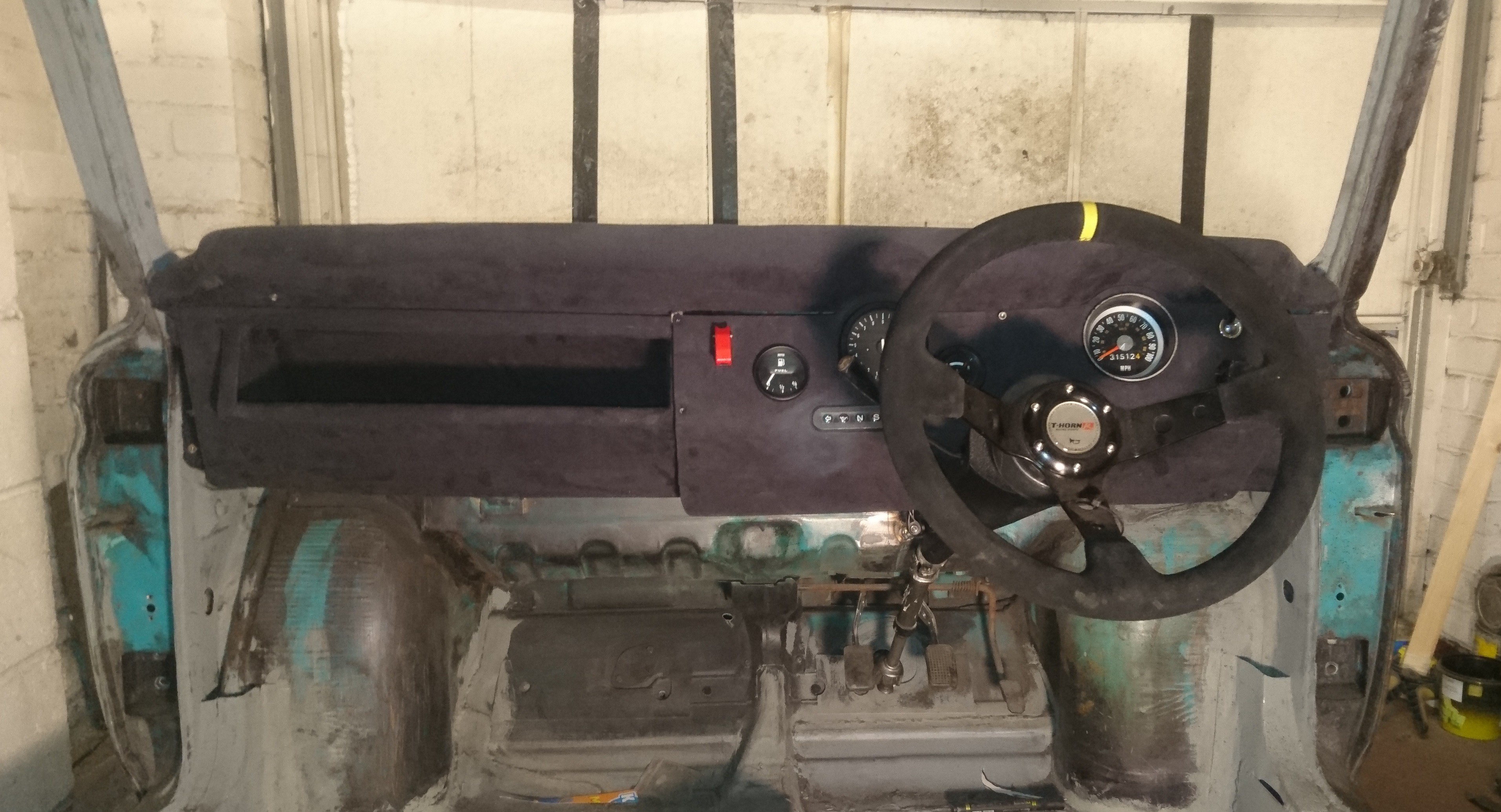

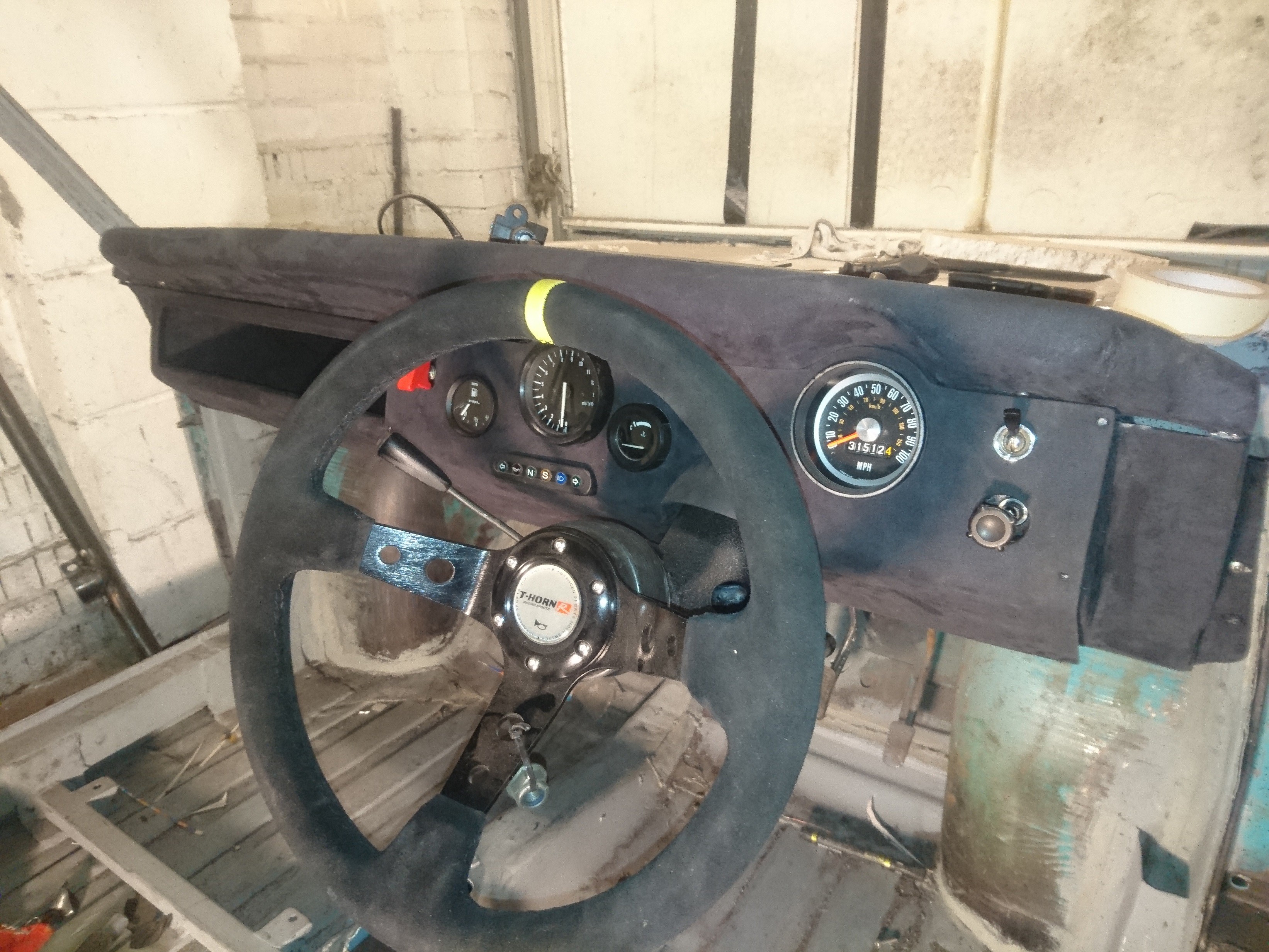

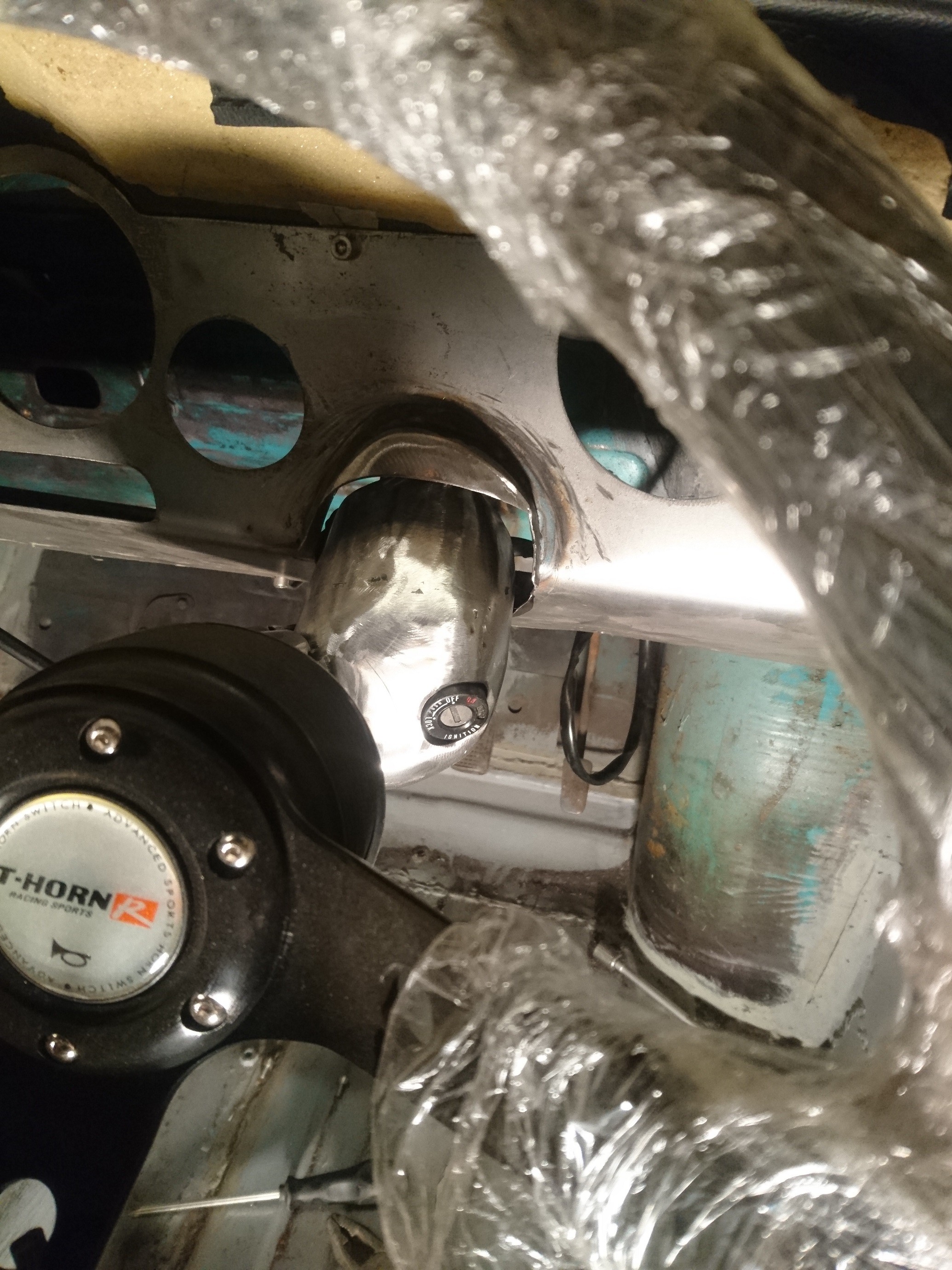

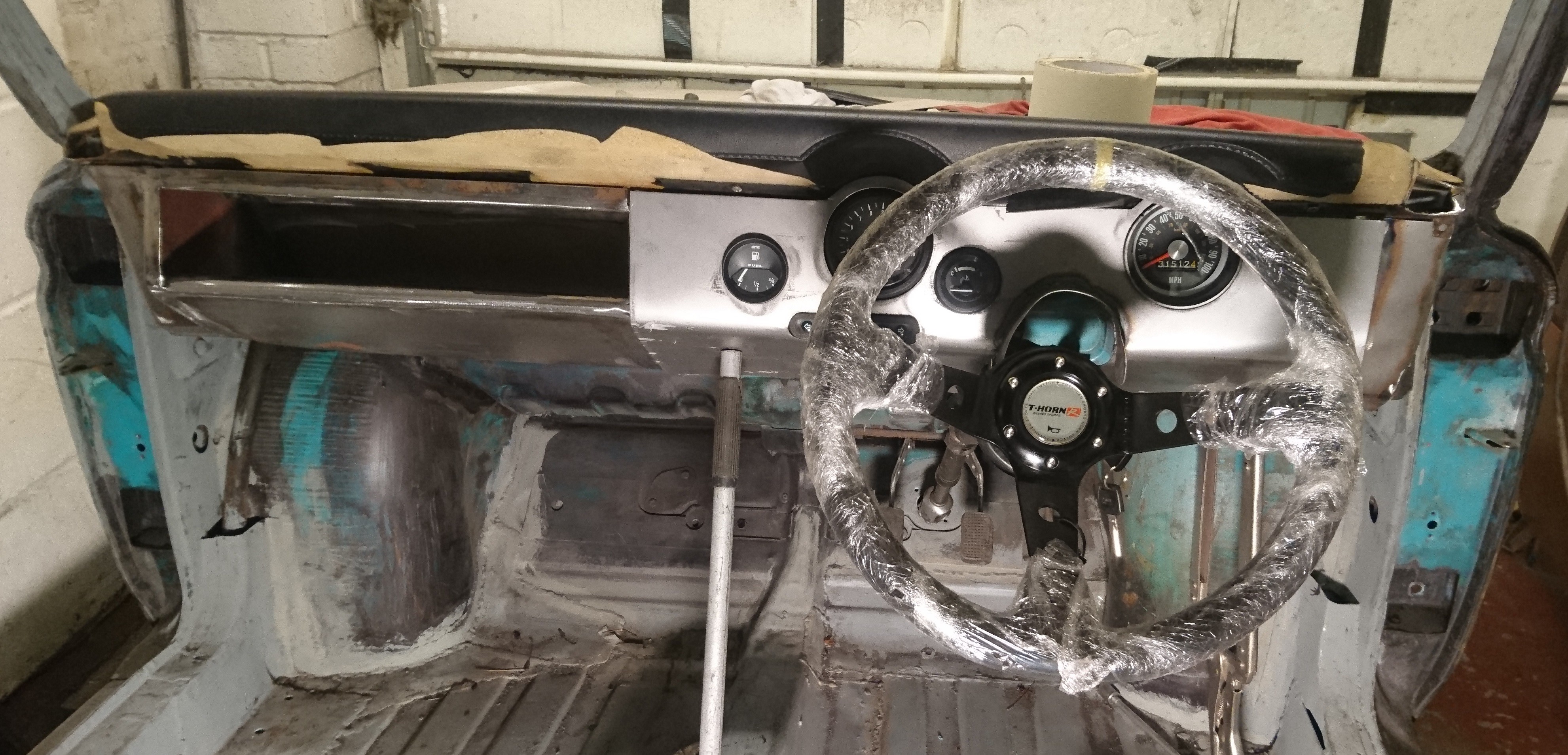

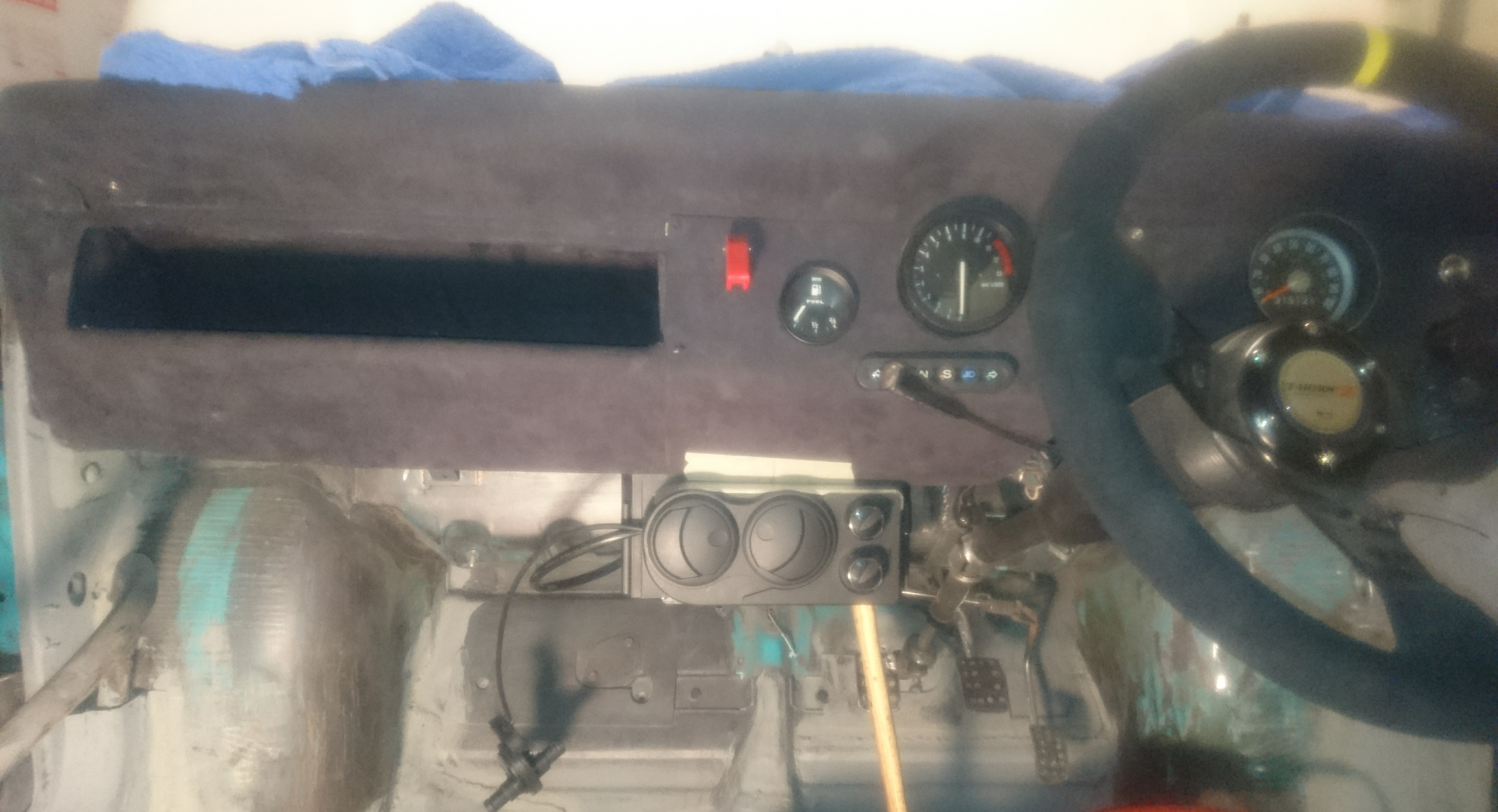

Now this was great I now knew I had somewhere to comfortably enjoy the Pest once I get it moving under its own steam. Thing was the steering wheel was miles away form me now..????

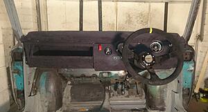

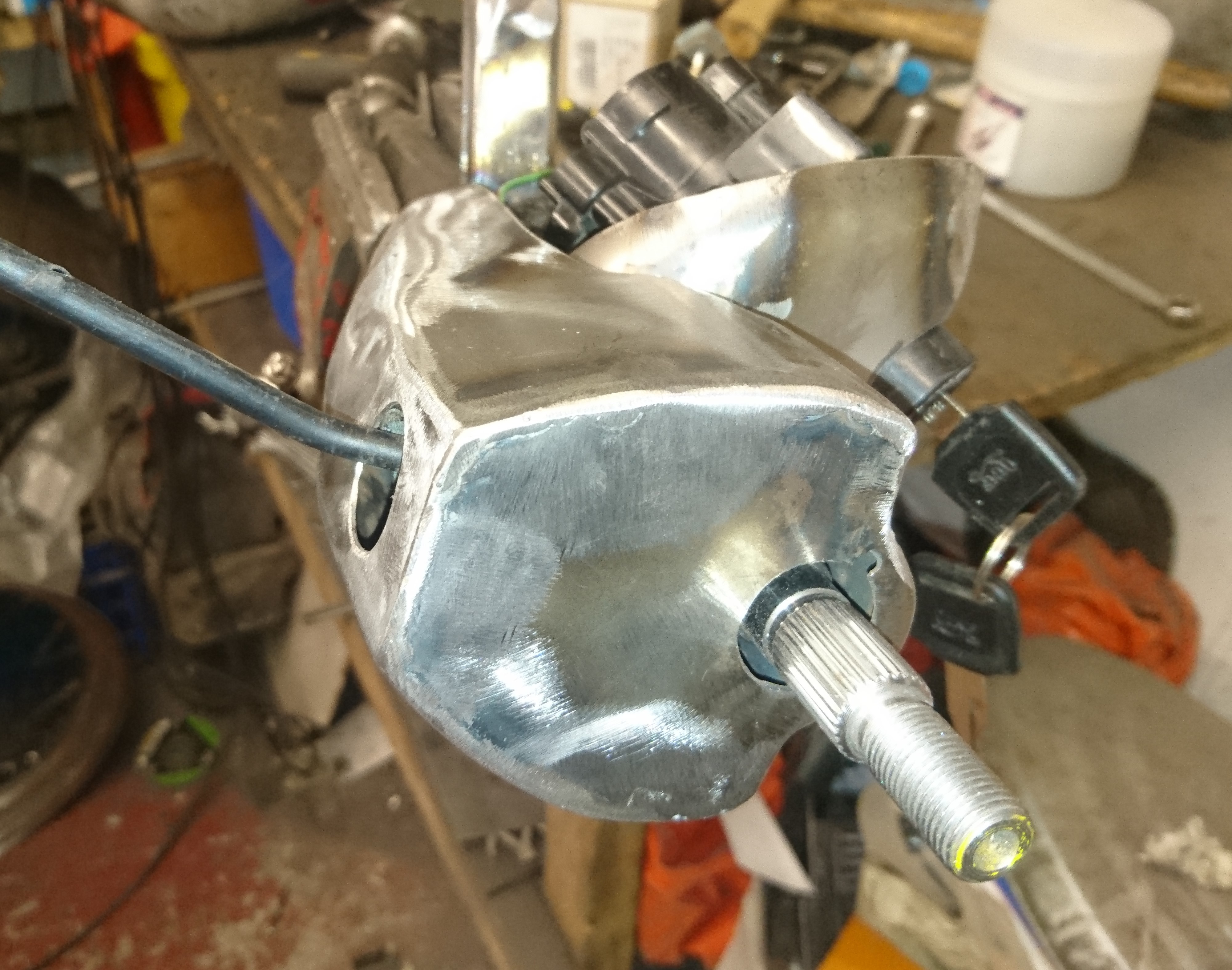

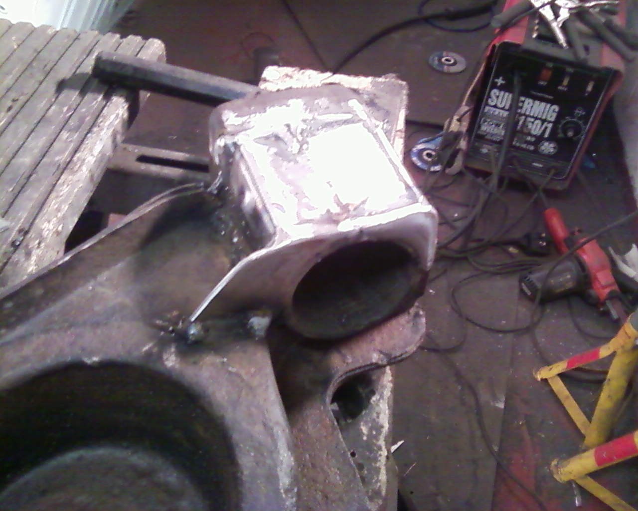

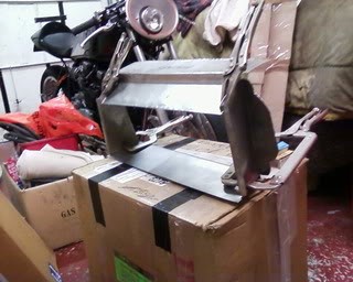

I know lets put in another steering column that is adjustable. A steering column from a MGTF was purchased and offered up, the bottom part form the Imp column cut and welded in place , brackets remade from various parts hanging around the garage and quick release mechanisms form a bicycle seat clamp used to make it all adjustable and easy.
