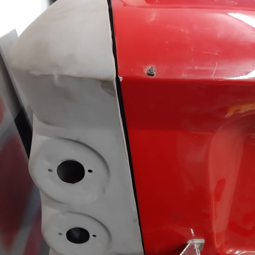

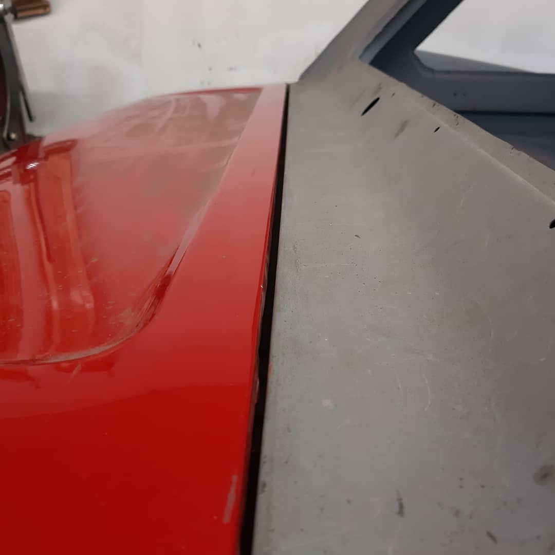

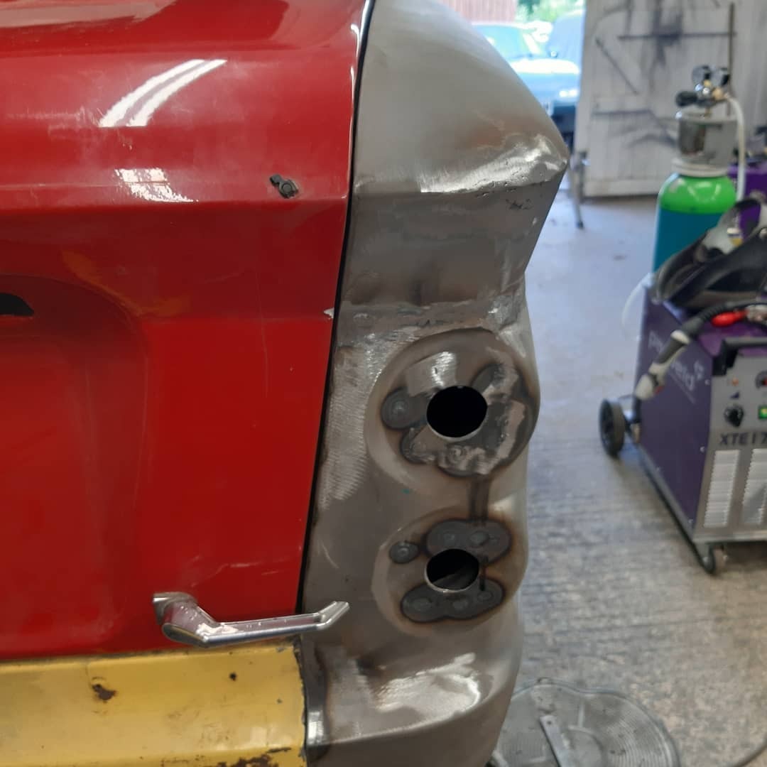

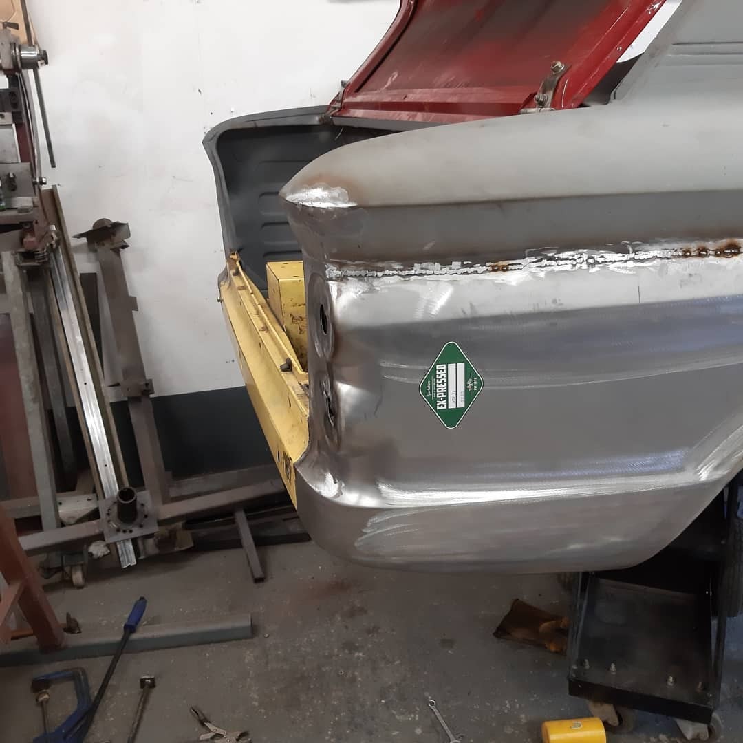

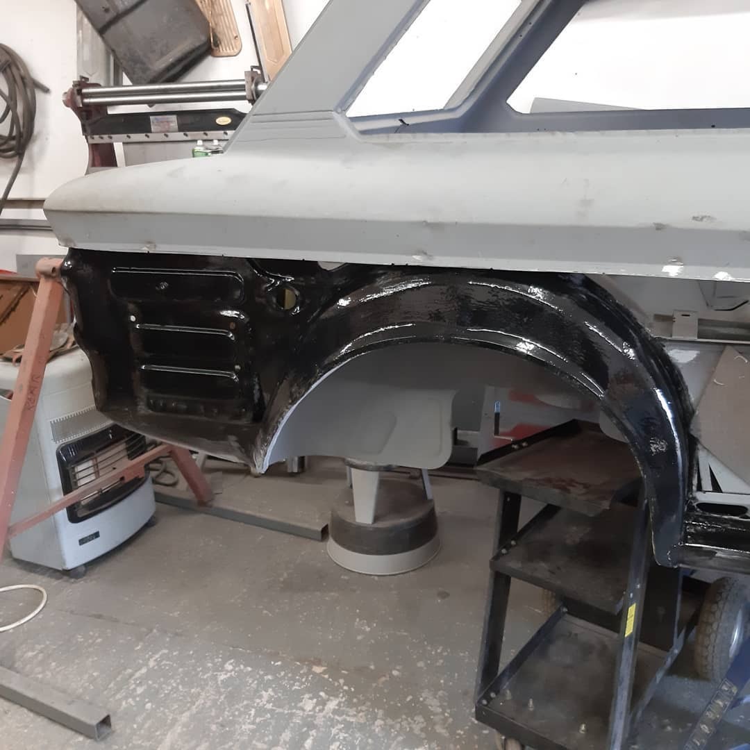

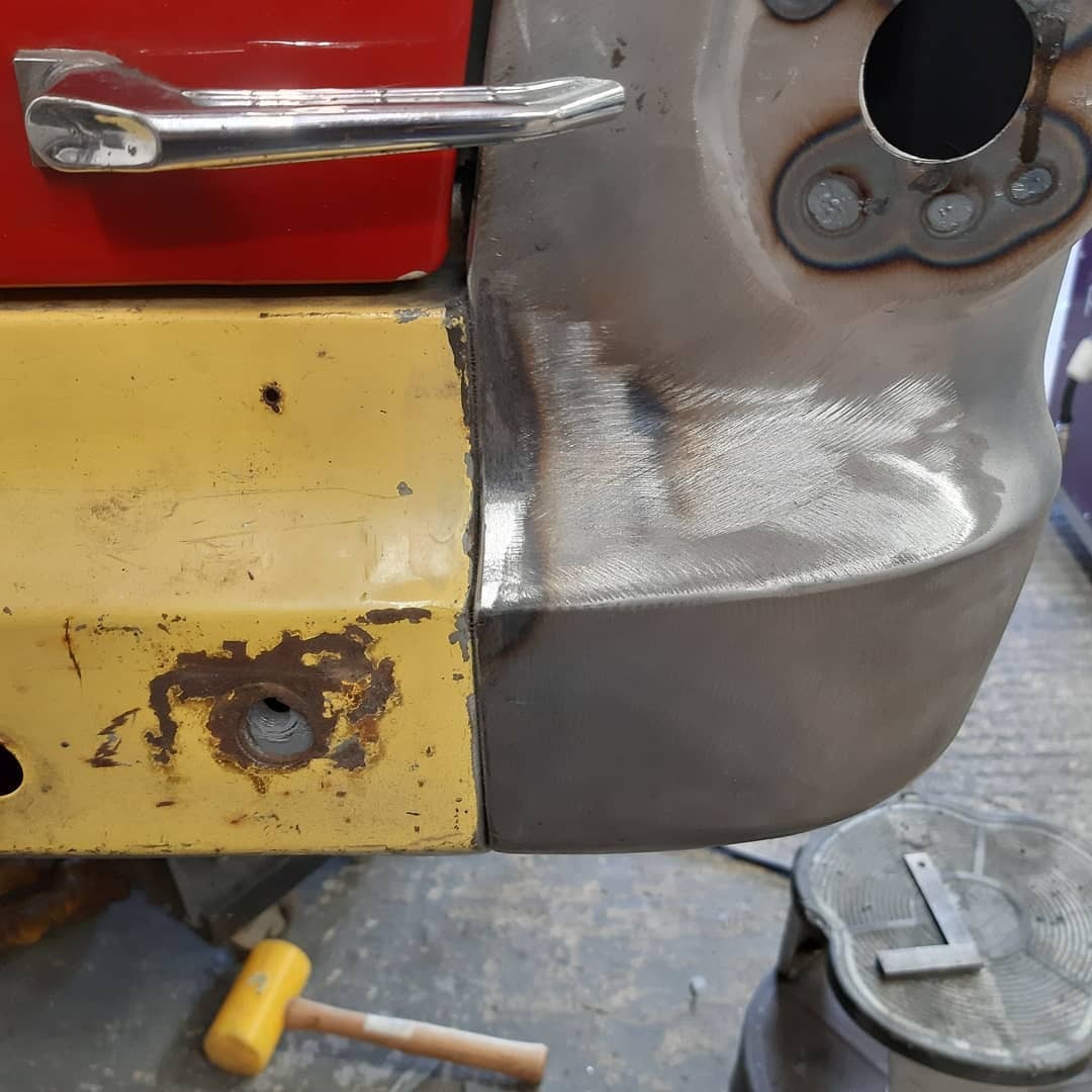

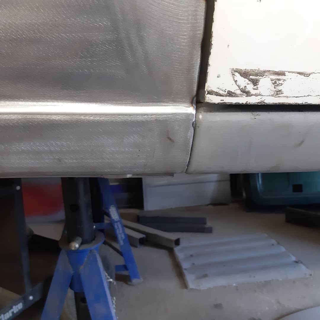

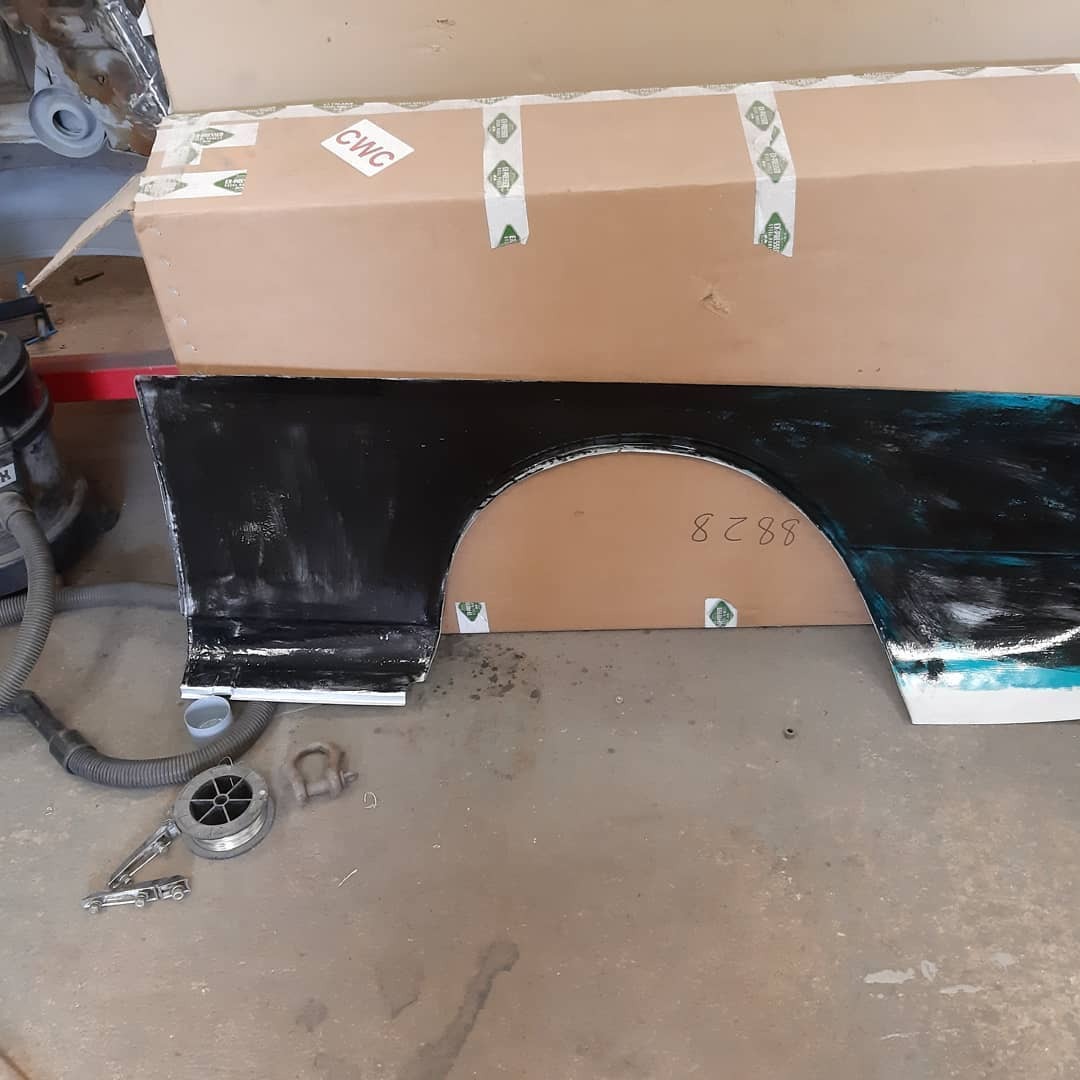

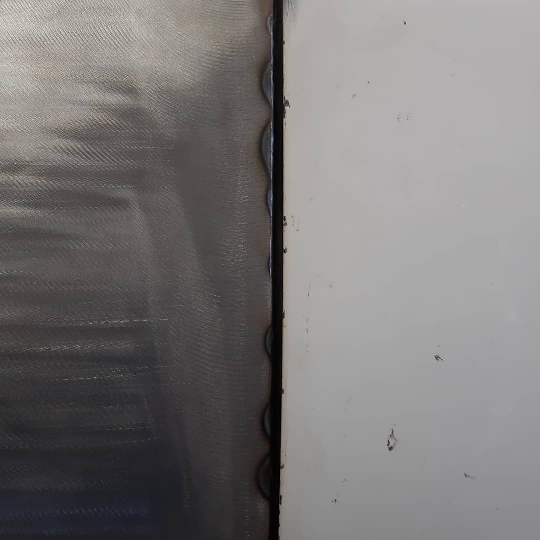

    Good day was had on Graham #imp following on from yesterday where I repaired the inner arch and put the inner wing and inside of new wing in primer.

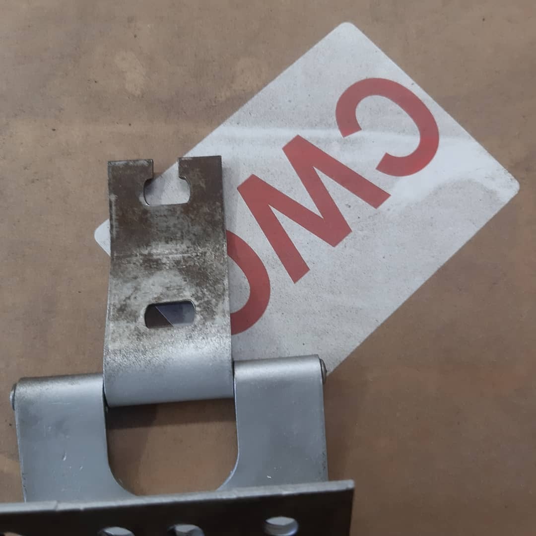

    Then 1st job this morning was to paint them and while they were drying I fixed 1 rear engine lid hinge and replaced the other with a new old stock item and lined up the lid along with rear transom and wing as in my view you need all the panels on to get the best results.
    Tomorrow will hopefully see me finish the wing and start on replacing the nearside lower rear corner
