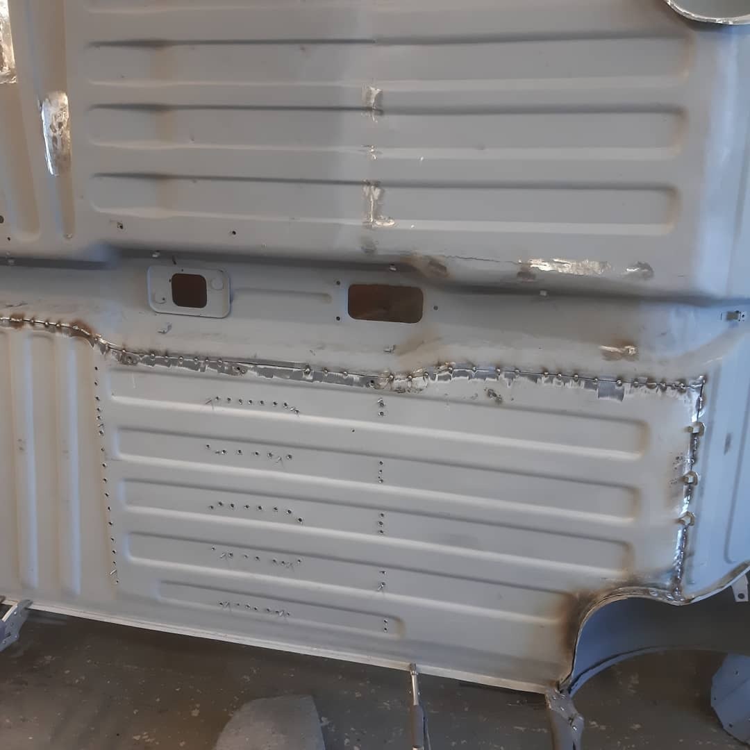

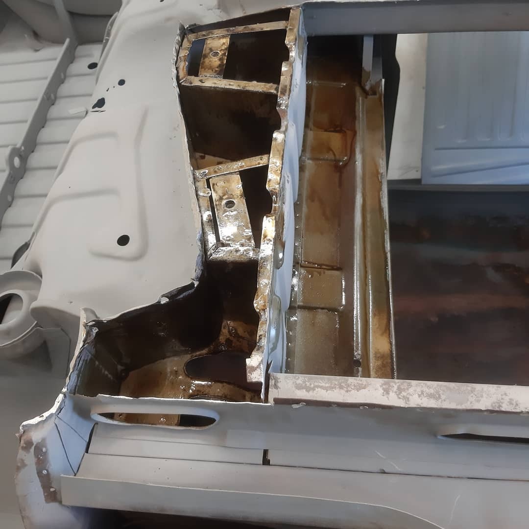

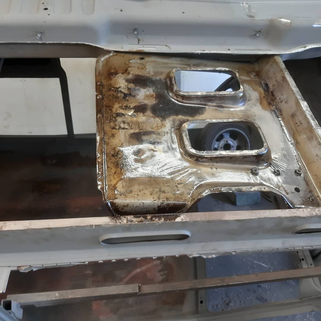

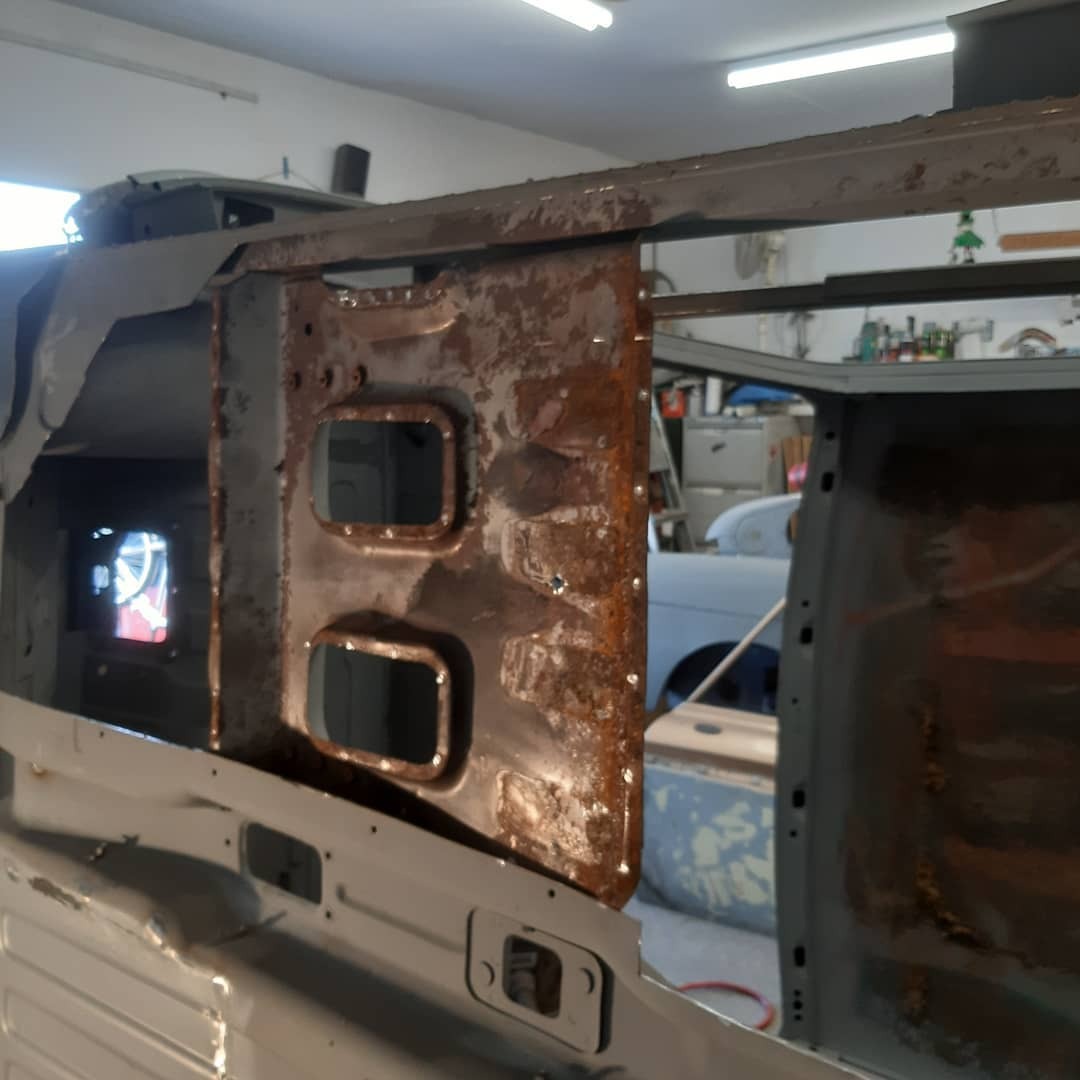

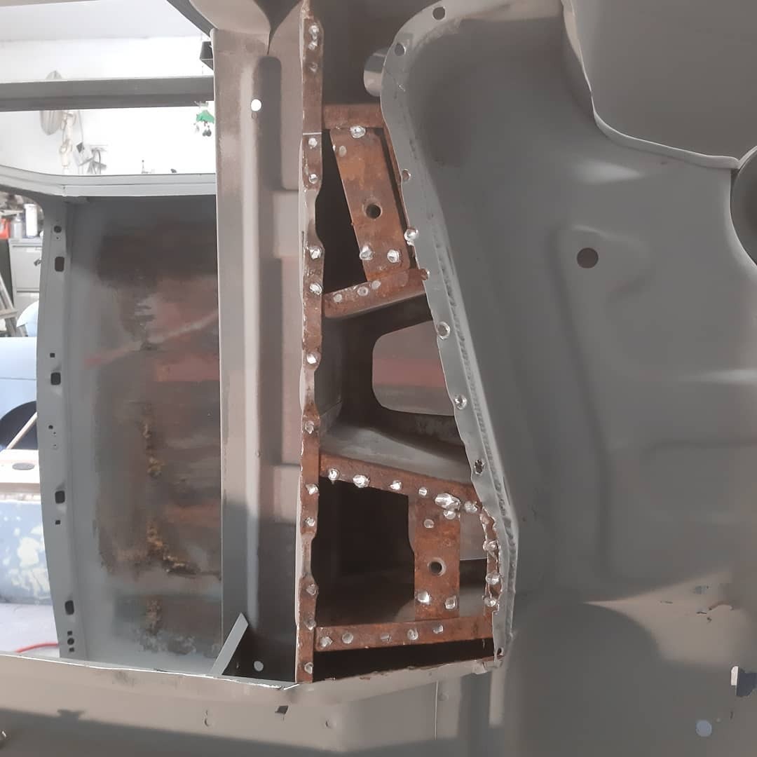

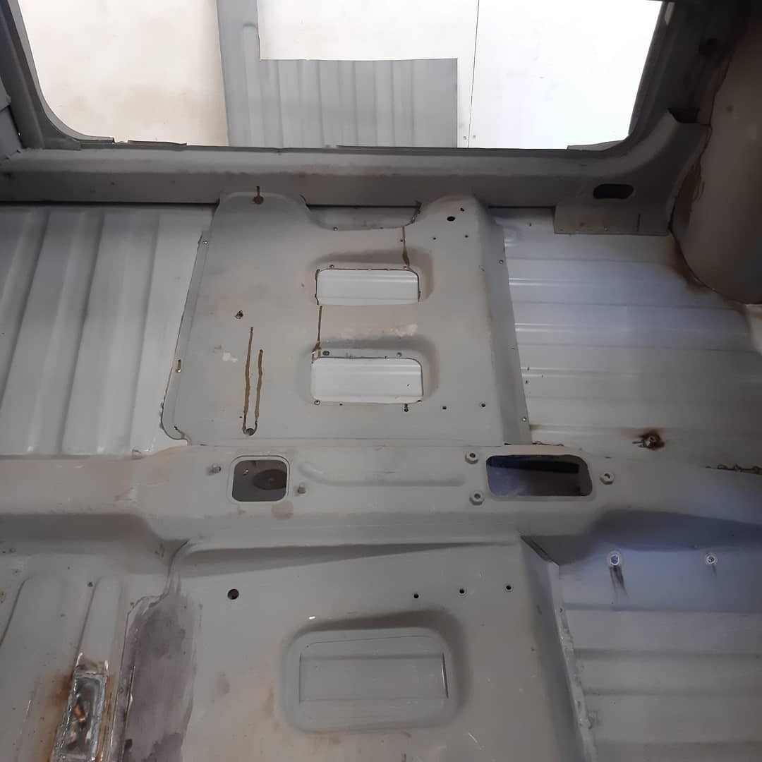

Progress on Graham #imp is going well after removal of the passengers floor pan and a sand blast to the seat pan and all around the rear suspension crossmember area . Then some treatment of fertan and etch primer plus weld trough primer the new floor is going in .
I may take the seat pan out and replace if the 1 in the scrap shell is better as it has some rust but its repairable. Next is the inner /centre and outer sill on this side all after I have welded the floor fully . Thanks all and stay safe
