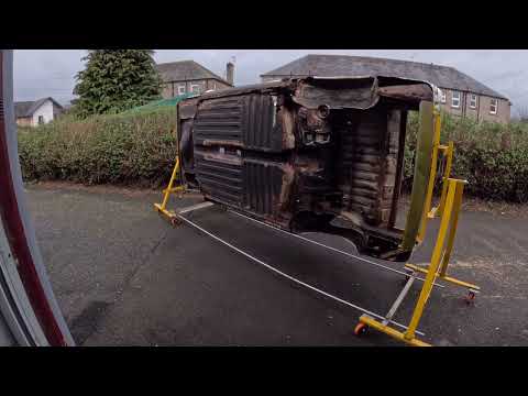

Lovely pressure washer procured rather than media blasted.
Body treated with degreaser, mild paint stripper and other bits brshed in and left for a little bit, then 150 bar and 150 deg c let loose to clear off most of the crud.
Bonus is it also stripped all the old paint from the last spray job and exposed previous repairs, area of filler and even blasted some more holes in the soft metal
