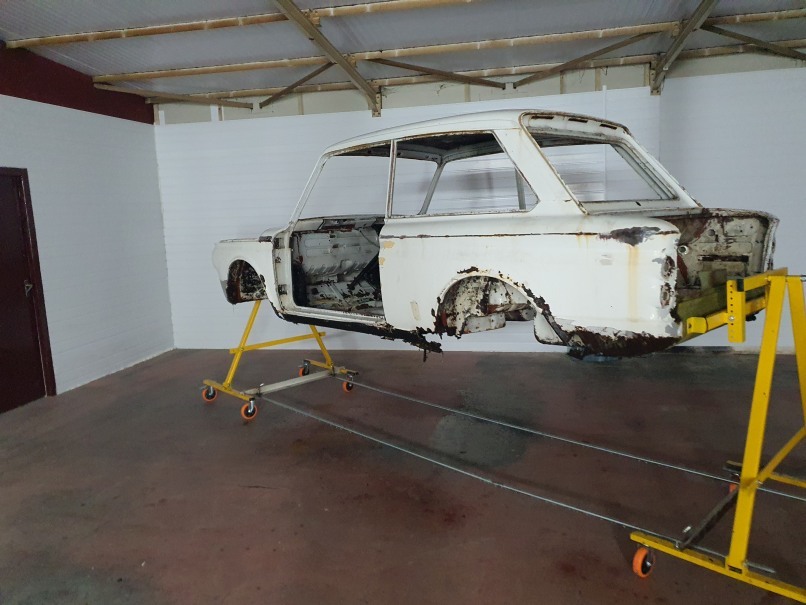

Then off outside on the jig, well sort of take your car for a walk time and blast the crap out the shell, 150 bar and 150 degrees make short work of crap as well as weak metal
As Project Doris is being done garage style, I decided not to send it for media blasting and instead use something anyone can get hold of.
These steam super high pressure washers are available from local hire centres very cheaply. Just a word of acution though is they are lethal, the cut skin as easy as metal. Treat with respect as you wont even feel a cut and keep any hoomans or animnals well away from the blast end at all times !
The worksdhop itself is as much work in progressas teh car and those following the build will see big changes as we go
Back inside and drying off

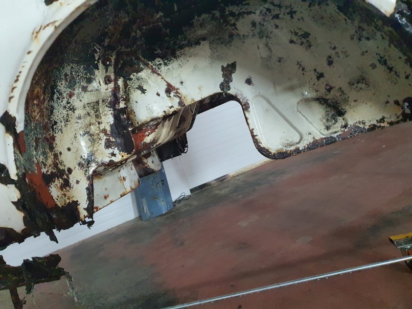

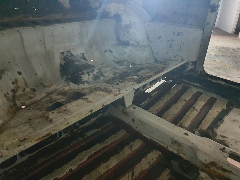

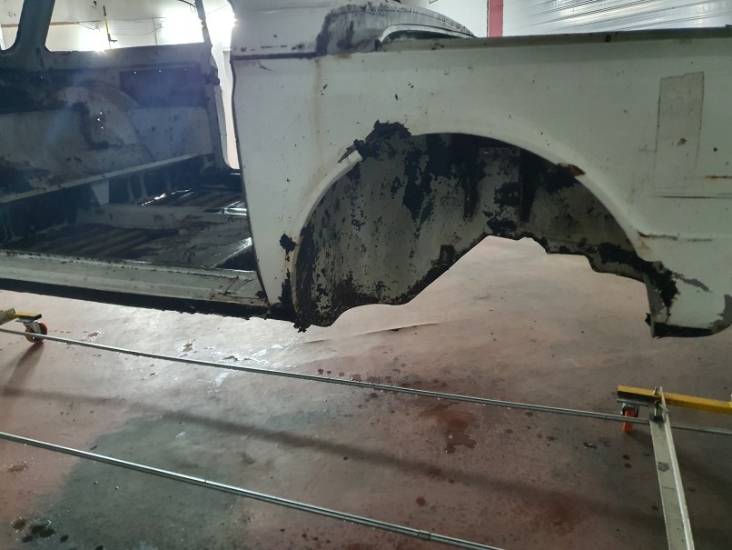

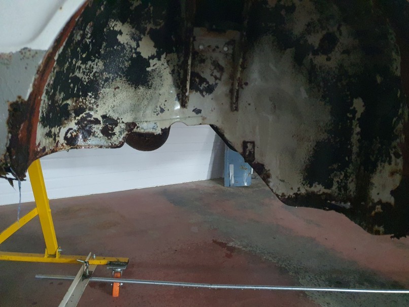

Amazing how much comes away (including soft metal !)
Overall pretty happy with the condition.
