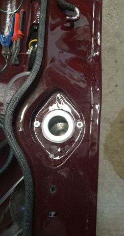

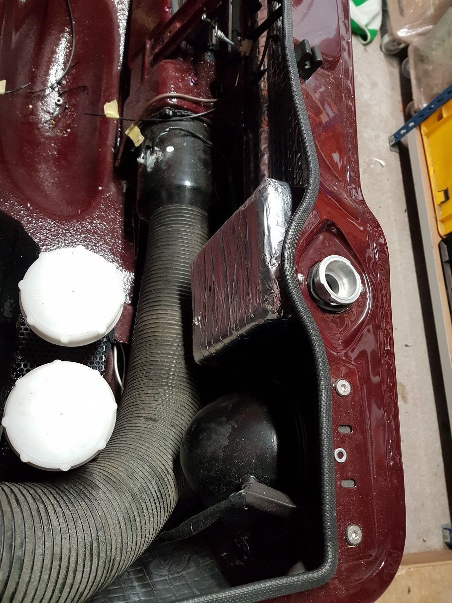

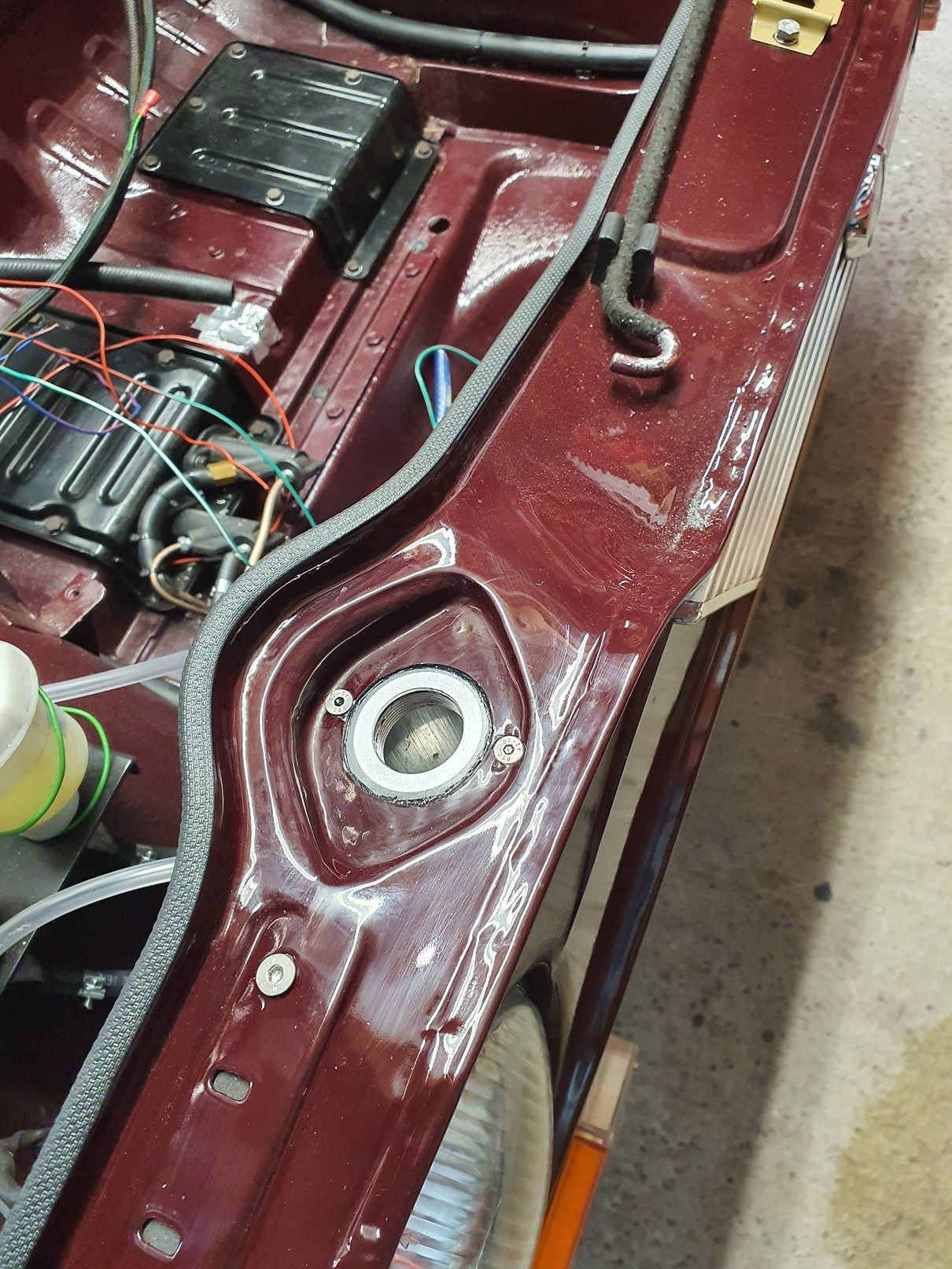

    Wonder what to do with the hole left by the old brake / clutch resevoir space when you move it ?
    Washer fluid is a prime candidate instead of the usual useless bag.

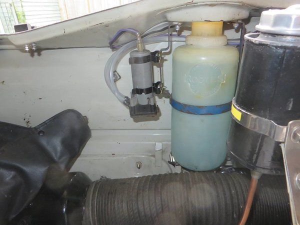

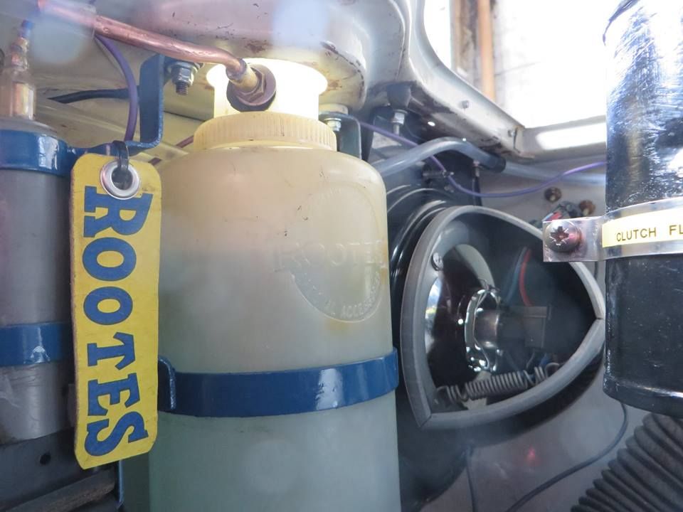

    Dave Lane solution inspired me to look at doing same, I could not finf Peter Nunney version on his maroon chamois which was pretty cool as well.
    Click image for larger version  Name:	011045049_n.jpg Views:	44 Size:	38.6 KB ID:	6742
    Click image for larger version  Name:	886438765892_n.jpg Views:	45 Size:	73.5 KB ID:	6743
    DAVES MOD IS HERE - MORE PERIOD CORRECT AND BETTER KEEPING WITH THE CARS HERITAGE

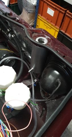

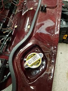

    So I first fitted a re-worked overflow tank but that was a bust. Simply an ugly fit and had a radiator cap. looked like a radiator !
    Click image for larger version  Name:	image_2459.jpg Views:	45 Size:	21.4 KB ID:	6744Click image for larger version  Name:	image_2456.jpg Views:	46 Size:	228.8 KB ID:	6745Click image for larger version  Name:	image_2460.jpg Views:	43 Size:	289.0 KB ID:	6746
    Did not like it, pretty much like the reseviour bracket

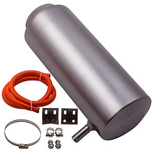

    So picked this up and reckoned it was there or there abouts

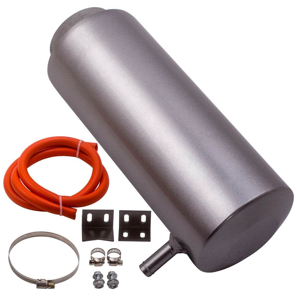

    Click image for larger version  Name:	s-l1600.jpg Views:	44 Size:	91.8 KB ID:	6747

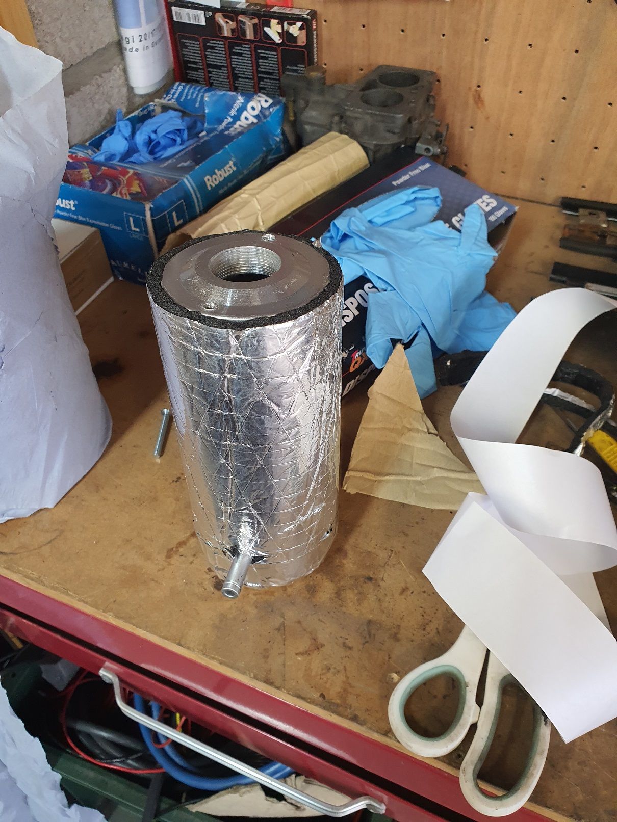

    OVER FLOW BOTTLE CATCH TANK

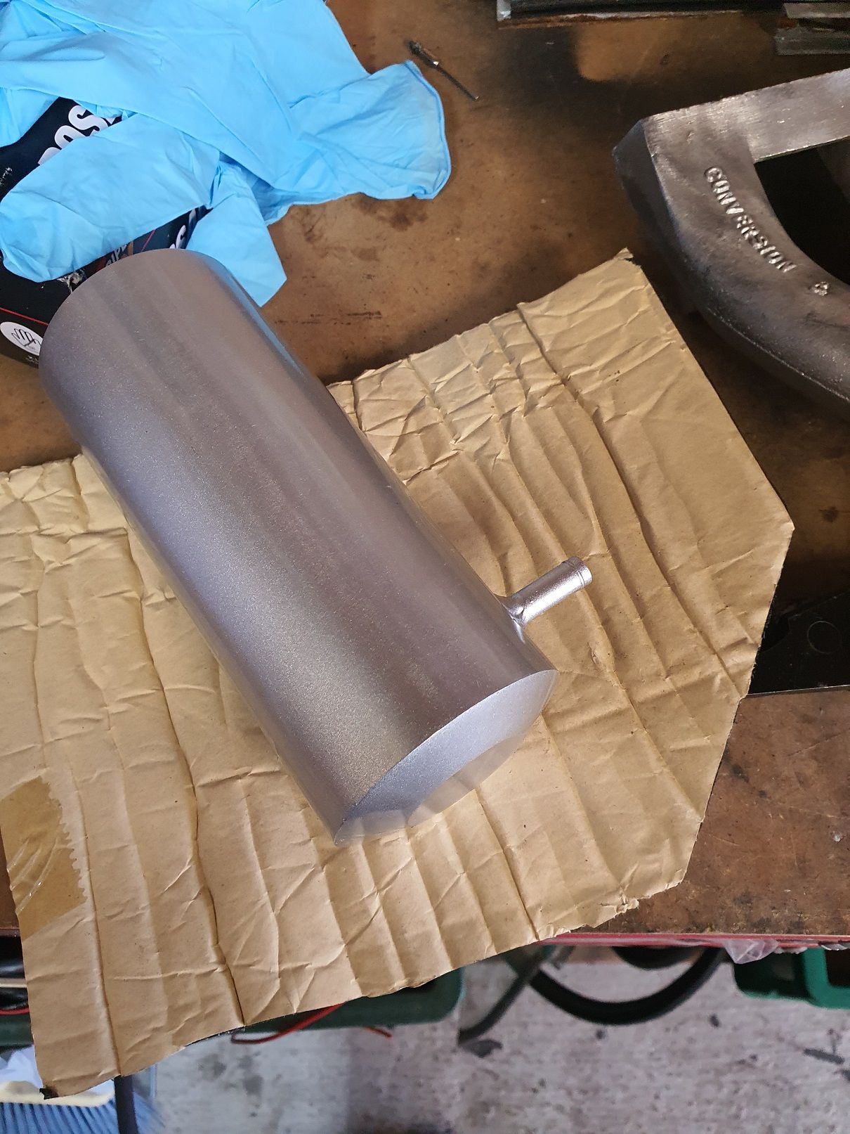

    When it arrived there was a bonusm, the top is about 8mm thick so it was easy to drill/tap fixings into where I wanted.
    Click image for larger version  Name:	277664256_n.jpg Views:	43 Size:	23.4 KB ID:	6748

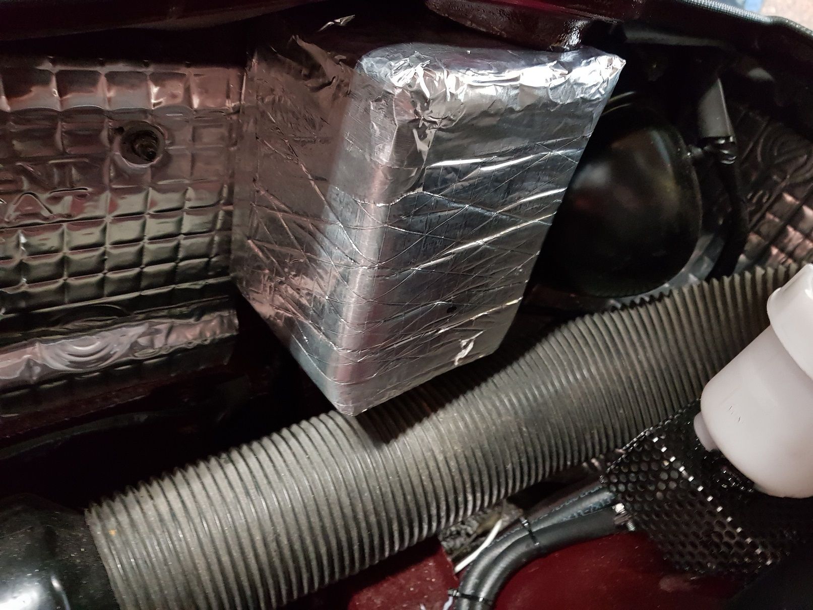

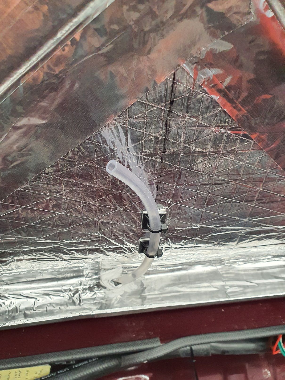

    And a little wrap as its in a cold spot
    Click image for larger version  Name:	20200427_163628.jpg Views:	44 Size:	275.7 KB ID:	6749Click image for larger version  Name:	20200427_164354.jpg Views:	43 Size:	302.6 KB ID:	6750

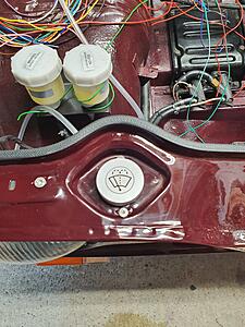

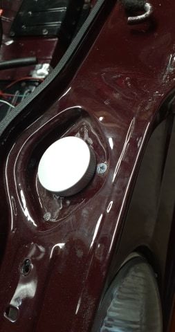

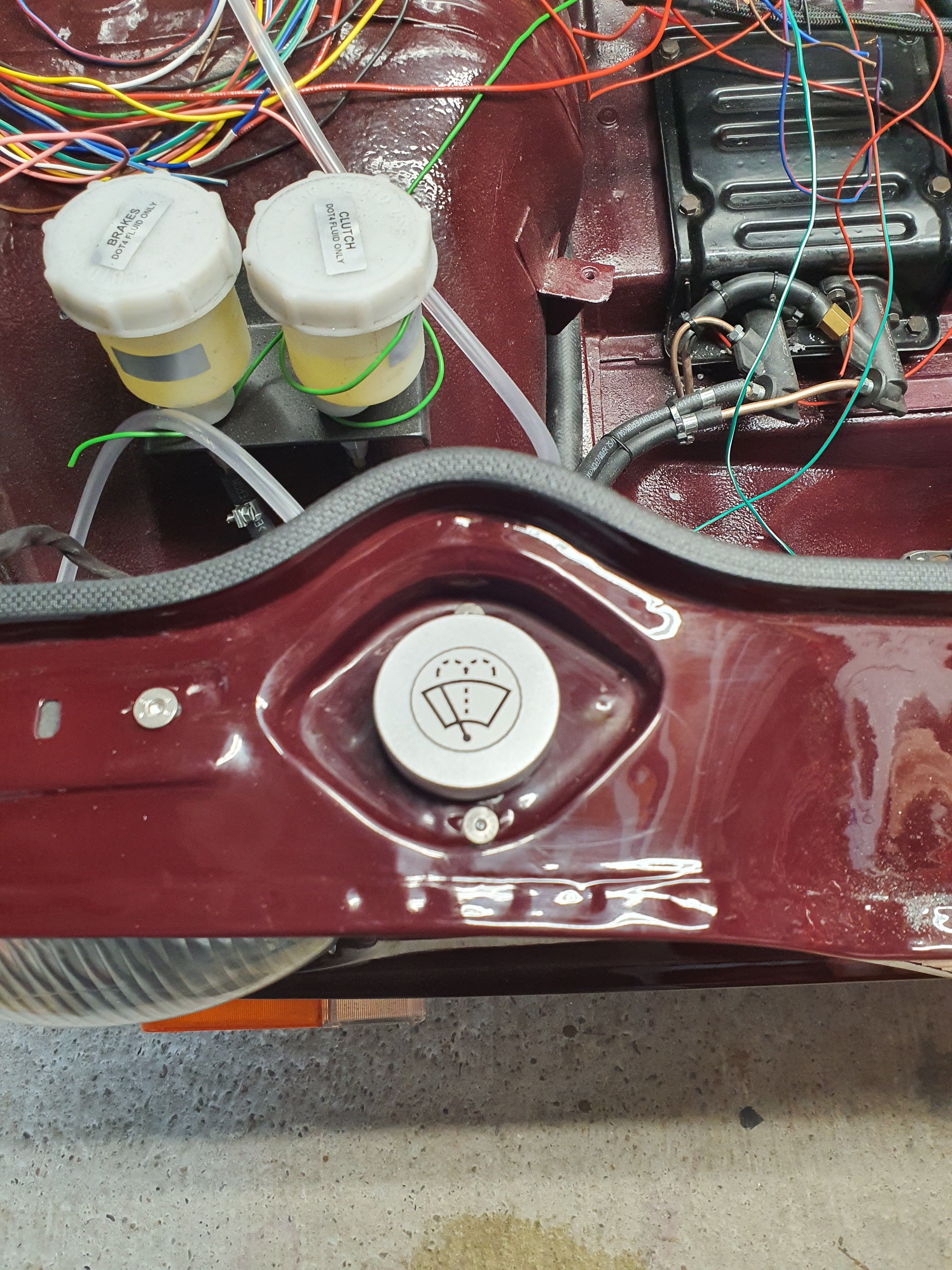

    And how it turned out
ID:	6752Click image for larger version
ID:	6754Click image for larger version
      looks a superb job - most impressive

          Needs a small trim of the inner lip of headlamp bowl, make the fit much better with the thermal jacket on.

            Brilliant , electric pump? if so where did you place that? just looked at them on ebay (tank that is) have been wondering what tank to get.
            Just been assembling new headlight bowls to refurbished mounting frames , so picture of Daves bowl mod will be useful in couple of days . THANKS

              Bob, electric pump is on top of drivers side wheel tub behind heater duct.

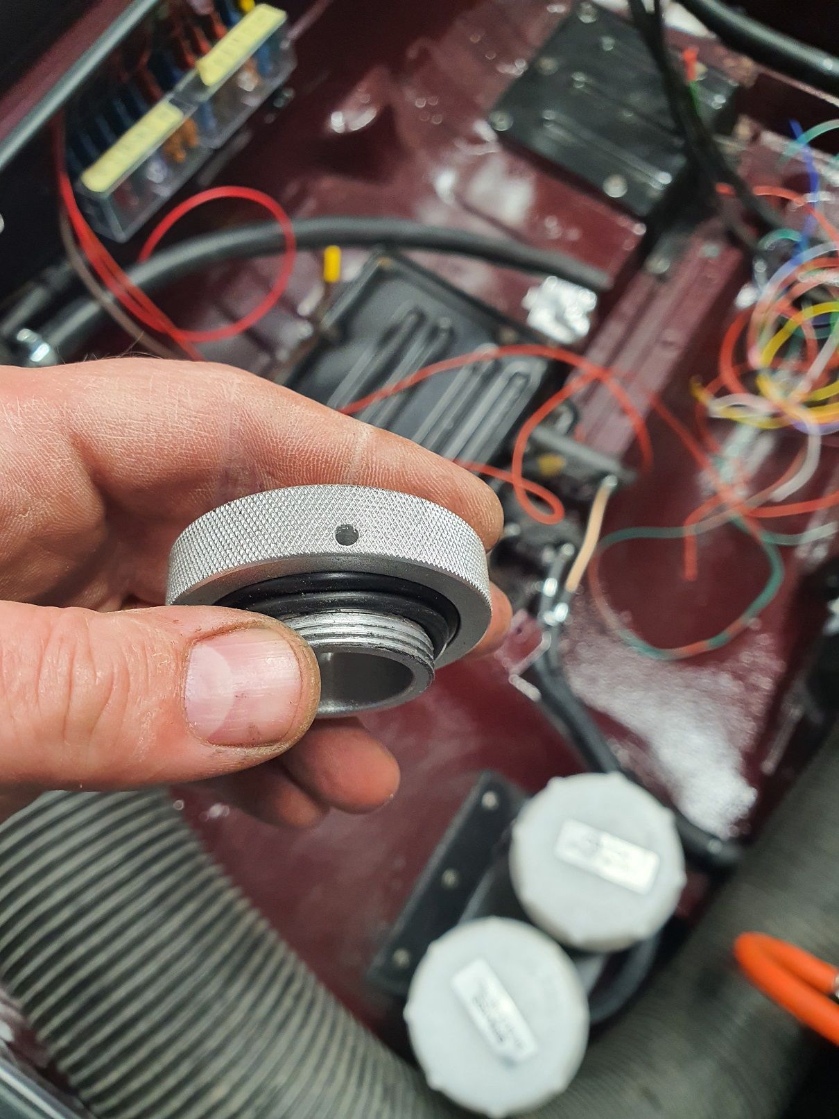

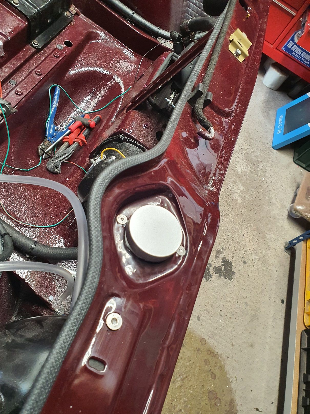

                ​ Tested it this evening.
                Petowner this is where the washer pump lives in this car anyway
                but flow seemed to slow down and then the homer event happenned and my forhead was duly slapped.
                No breather hole !
                So time to get drill out again
                  Yeh , dont forget the breather hole , theres two in my lid
                    • 4839
                    I drilled it so its at the back Dave although starting to think I made a mistake with bottle size, either that or its gonna have serious pressure as that 800ml bottle gets pumped empty in no time.

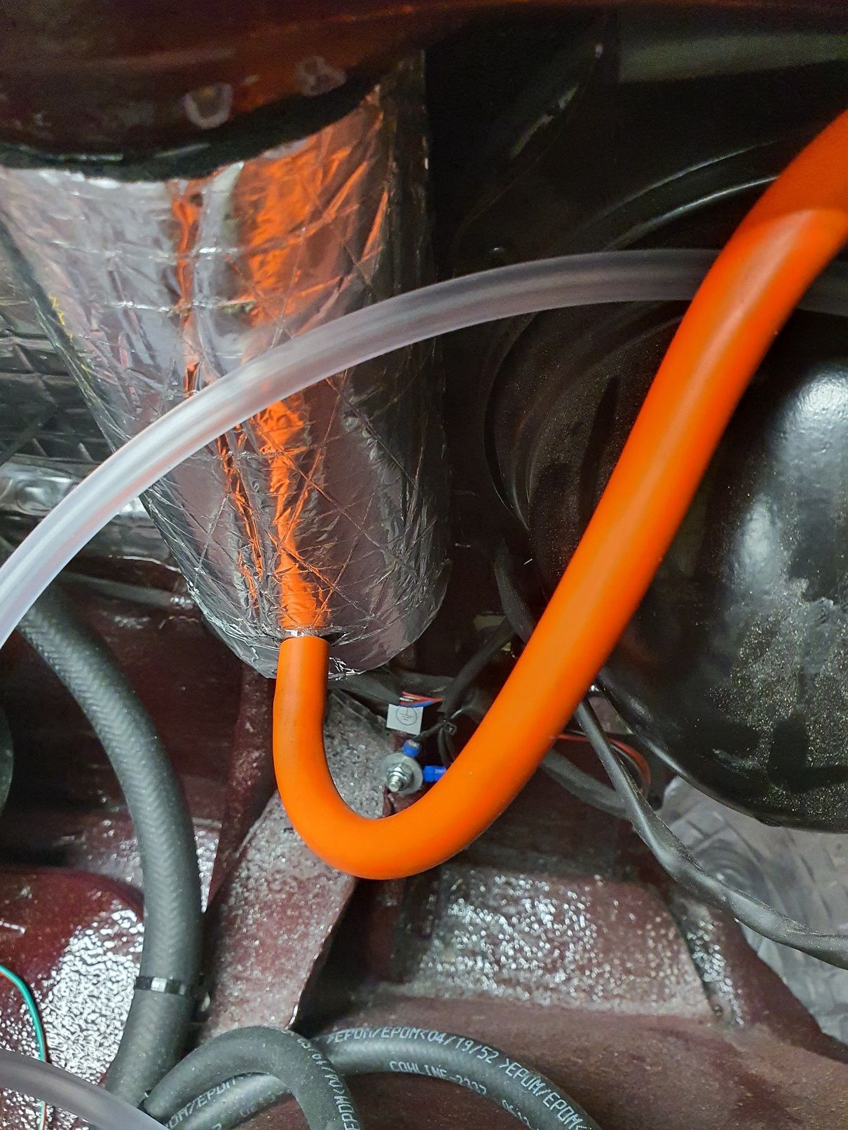

                          Bore of the tubing, maybe its bigger than 5 and open ended. Might work better as a coolant pump in some imps
