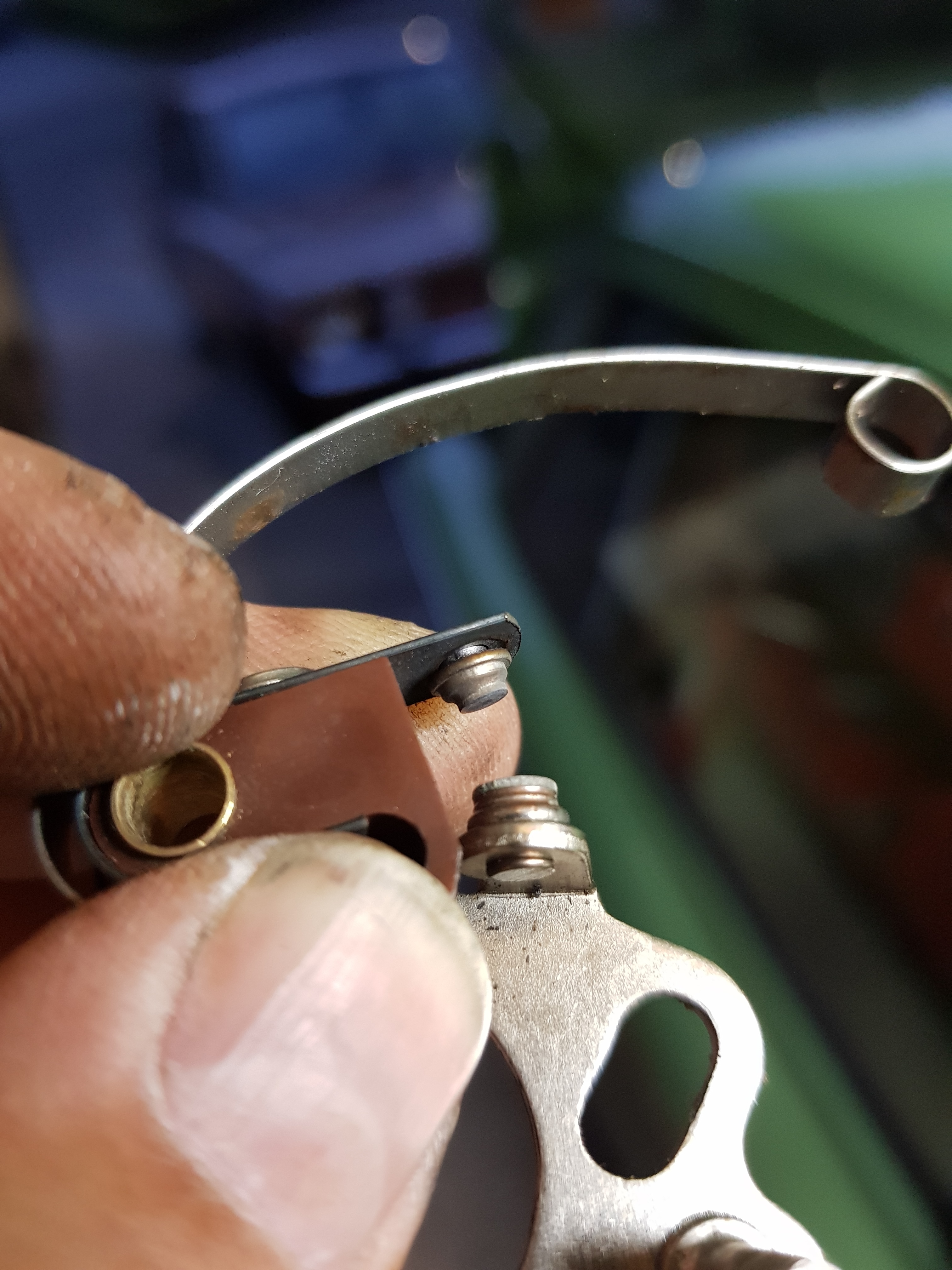

Dont buy points kits from Eaby, especially if you see an intermotor box ANYWHERE.
If the points are not branded, leave them be. Condensers are much of a muchness and in fact made better these days (other than no name ones) as any of the larger spares manufacturers need to supply parts to AECQ these days and that means no short cuts.
Except points !
Imp engines run way to high, even if the points are for a 25/45 dizzy and new, this is what happens to them mechanically, complete crap.
This set last from Stirling to Errol for a show, les than 100 miles !
All bad, rivetted contact face fell off !!
Except points !
