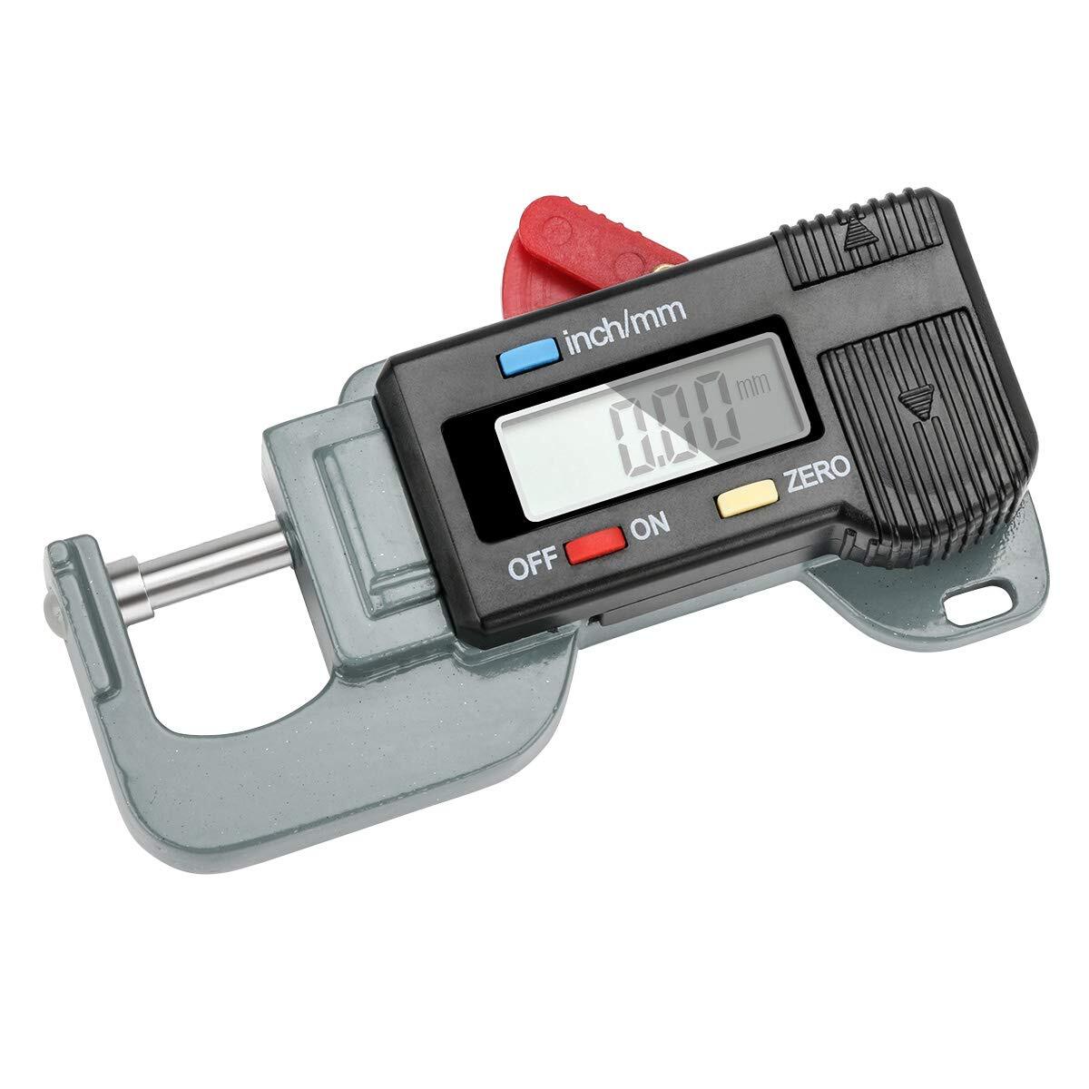

We bought, we tried, we returned as it was complete poop.
  • We bought, we tried, we returned as it was complete poop.
    Was planning on this as a pressie to Paul as he just LOVES shimming heads and keeps using that damn vernier that measures outside edges.... he was kind enough to sortout some Puegot 107 woes for me as he loves modern junk (his job after all )
    First off, battery was fitted, and DEAD
    Take first measurment at zero AFTER zero the guage, -0.01
    Touch lever, 0.00, yes just touch
    Take measurement again +0.02
    Dont go near the lever, dont even turn the whole thing around, it changes !
    And thats using its own zero/ref stop
    Complete crap, but as its was from Amazon back in the packet and off it goes back to where it cam from
    The actual body/movement was very nice, shame they could not do the tolerances for the encoder to work.

    That's the dood thing about Amazon, no hassle returns.
    I keep meaning to buy one of the ones for measuring discs and pads easily.

      Pay nowt and get crap : not really unexpected, John

        I am a forever optimist was a bit cheaper than the Mitutoyo one I have been eying up

                Andy, yip, I keep looking and thinking I need one, then its back on with something else. No digital readout on the one I have now and its in mils
                Was worth a punt.

                    Some decent reviews though.
                    Want me to order one as a second try?

                      Pat, you could try, Paul is still using his ex wkik fit calliper vernier for checking shim sizes
                      I can only see a man suffer so much throwing spanners around when shimming a head
                      Reckon they are just crap though, I picked him up a R17 to go with the big valve head his mate just refurbed for him and those honda civic carbs, so more shimming on the horizon
