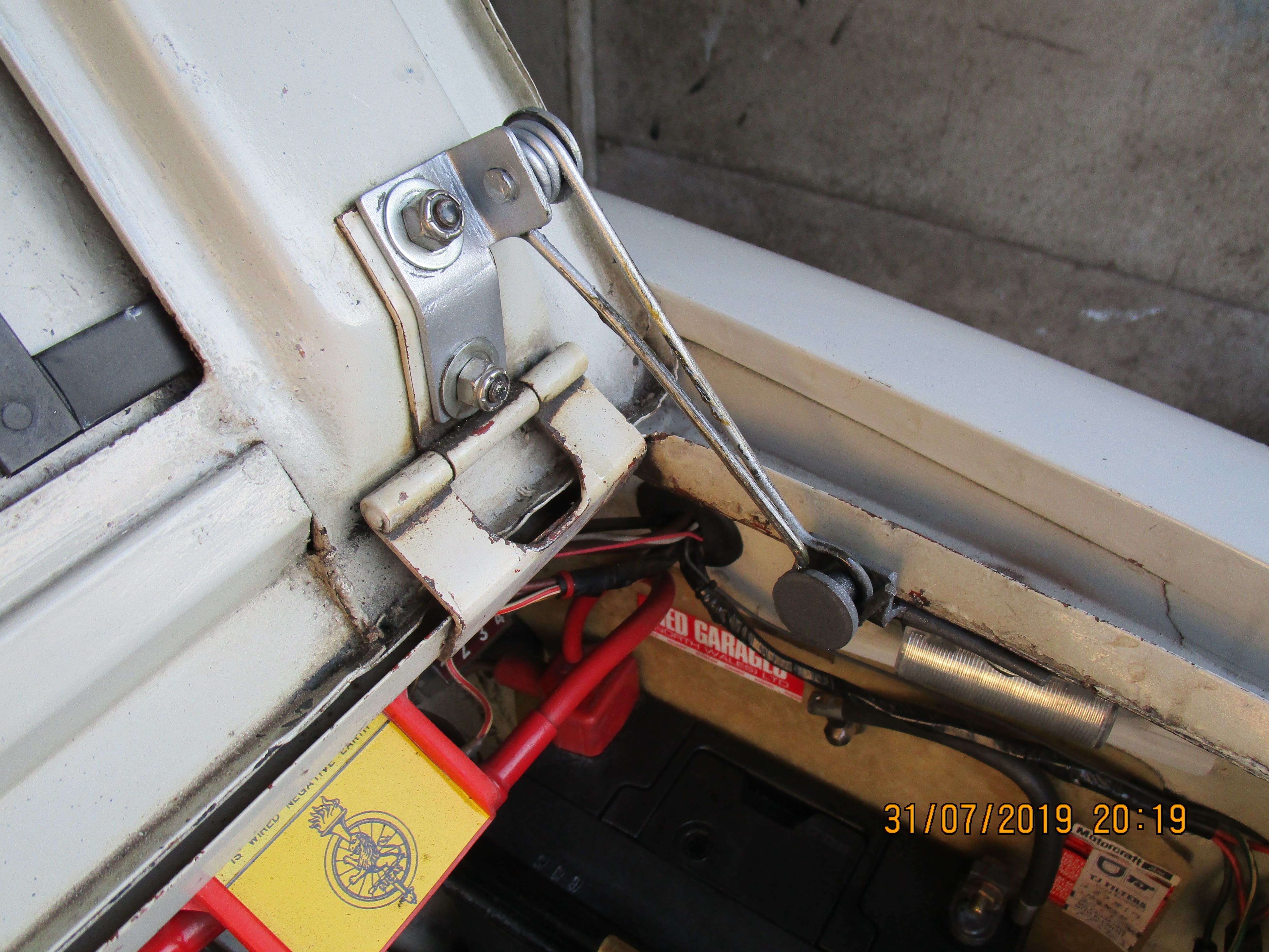

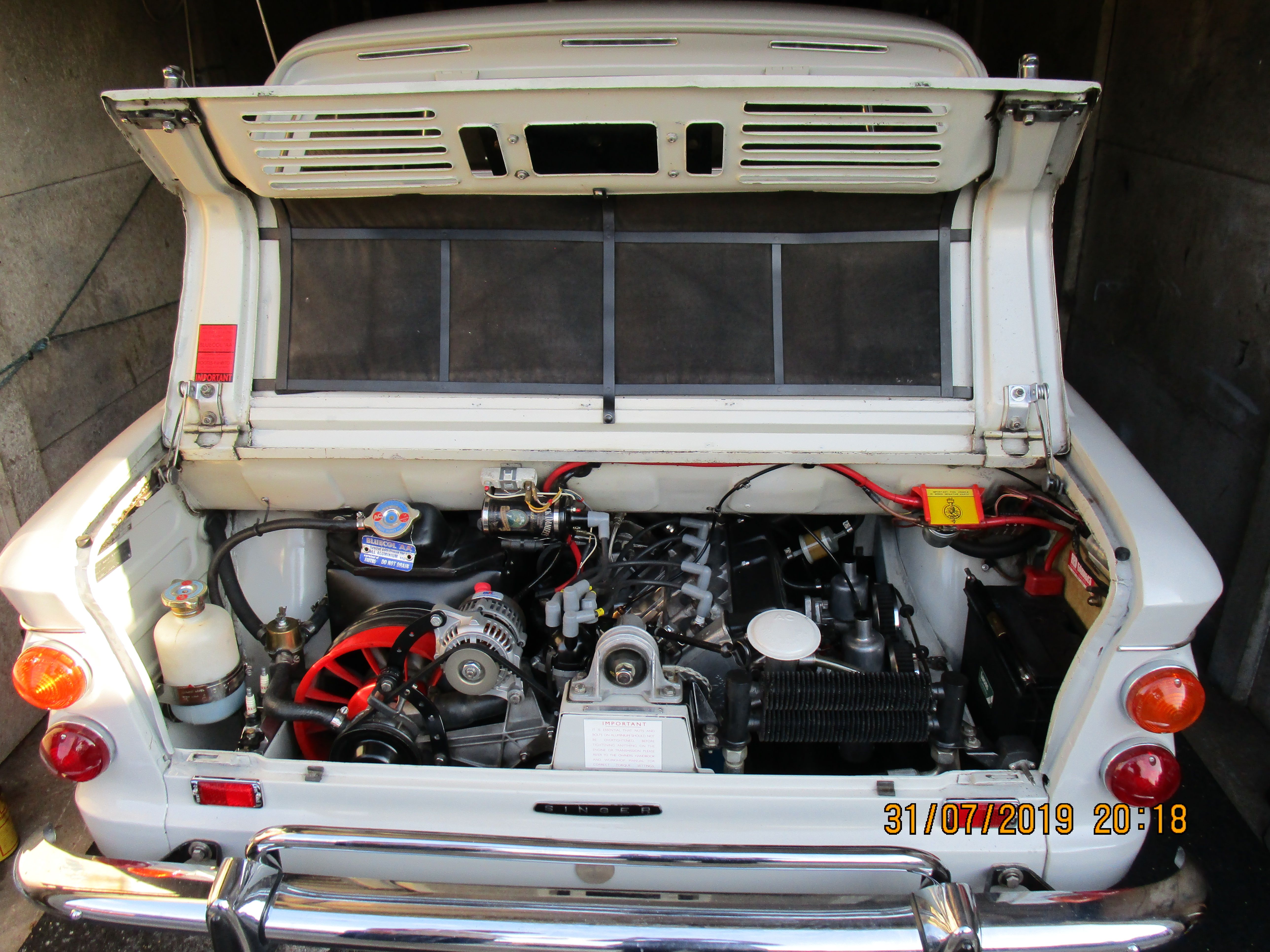

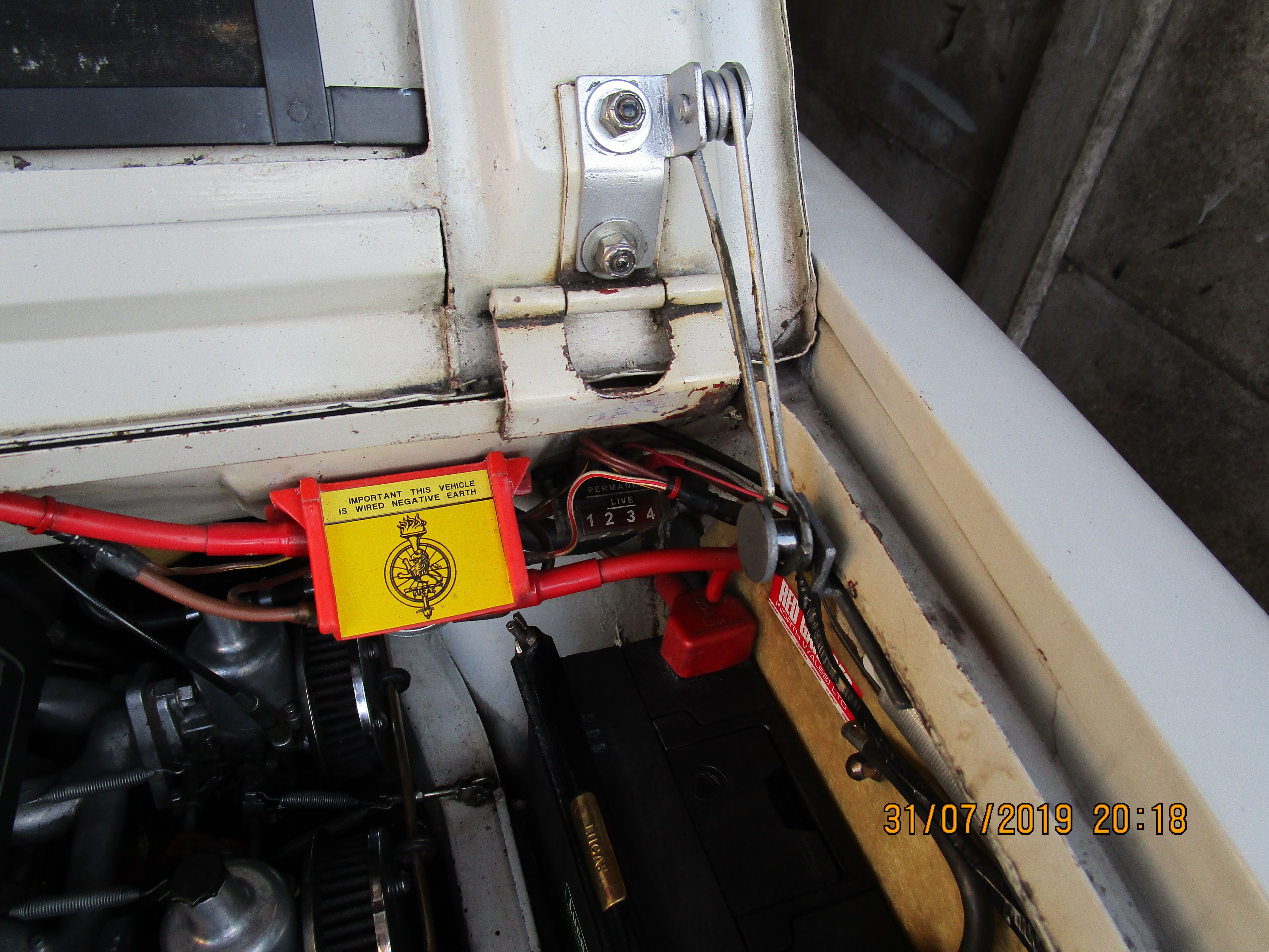

So i hatched a plan to fit two early type stays on the Singer - one each side .
Didnt turn out as easy as i thought because apart from the spring itself everything else is handed wrong.
Come the end I had to make both mounts from scratch including the steel bobbins the spring fits too and locks into .
Still a few hours making a few small brackets and a bit of time on a lathe resulted in a real success
The one and only R/H engine lid stay
And then there were two
