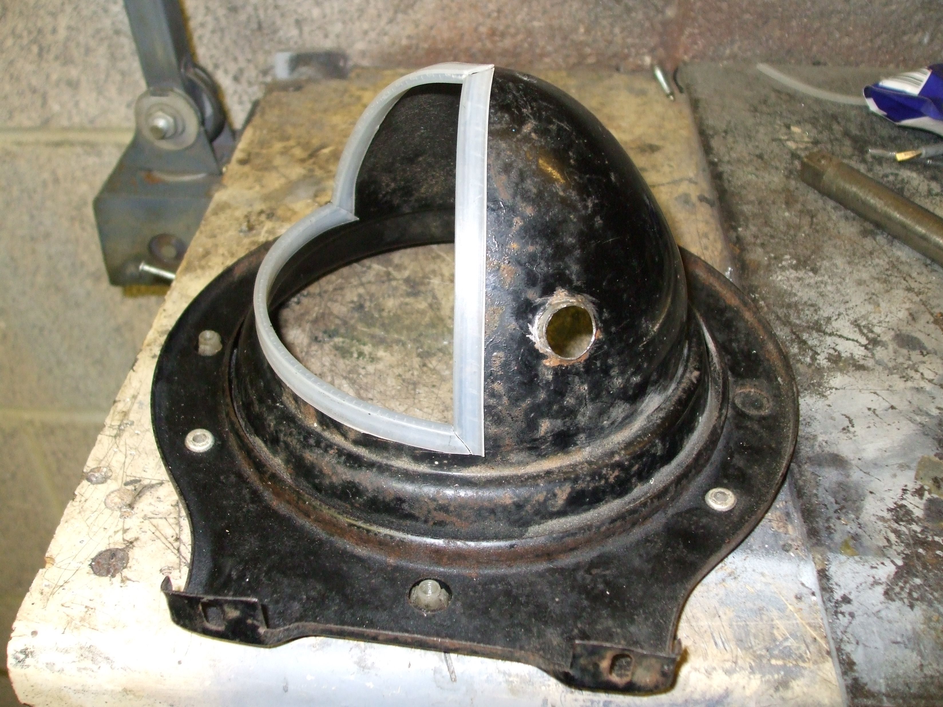

This is only needed if your running halogen headlights , makes changing a bulb a doddle with no need to remove the headlight ala. sealed beams . running halogens also means you can put the sidelights in the headlights giving a much bigger visible sidelight .
Headlight bowls are NOT handed , its the same bowl for both sides , its just the mount its on is handed .
Doing the Drivers side ( RHD ) headlight is easy however the passenger side is a little more complicated . just remember you MUST leave the spring tag in situ or you will get a very wobbly headlight .

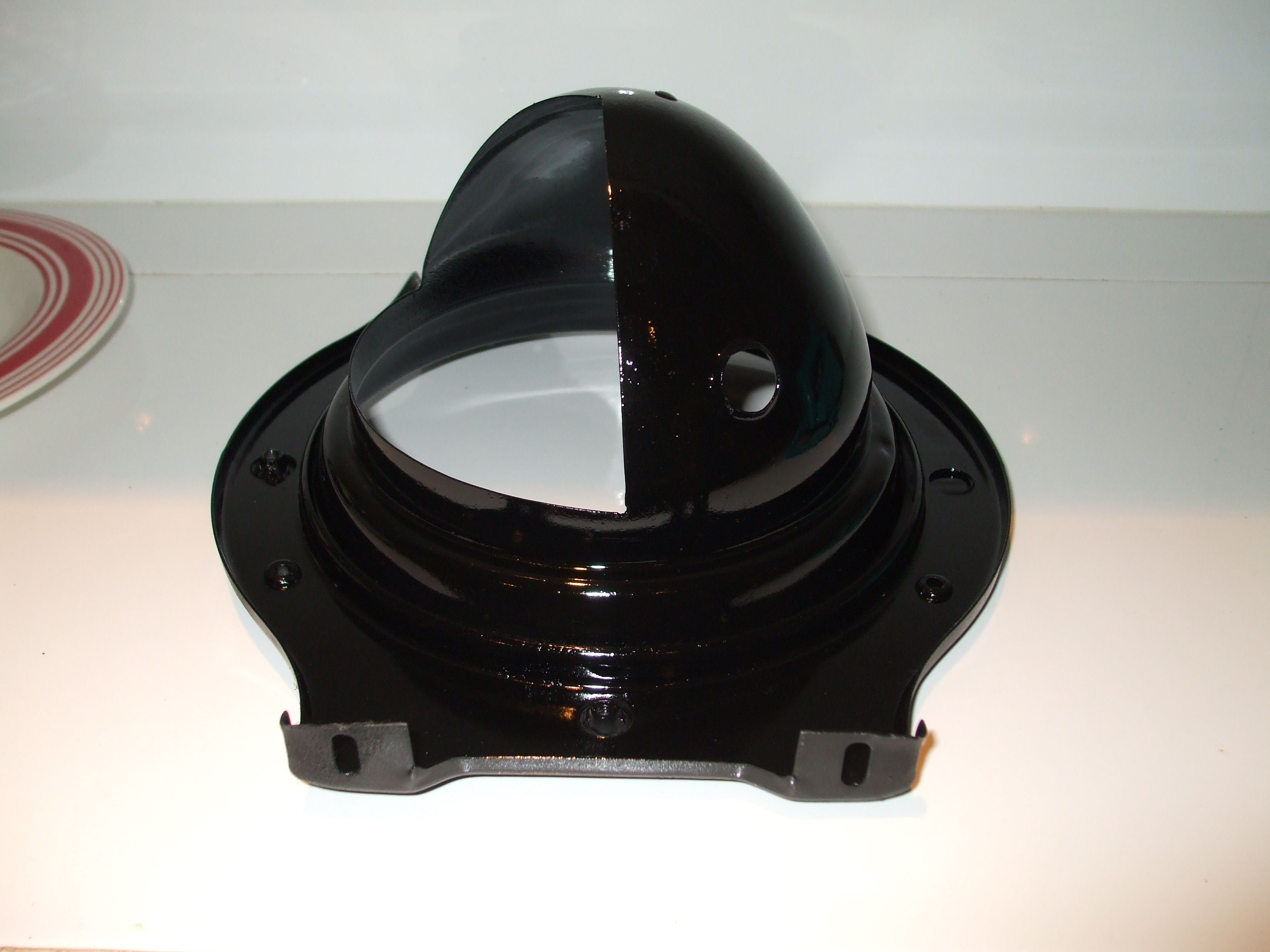

I used a 1mm thick cutting disc on a grinder - takes seconds
Pictures tell the story better

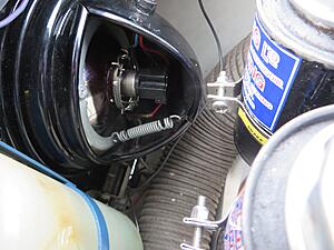

Drivers side

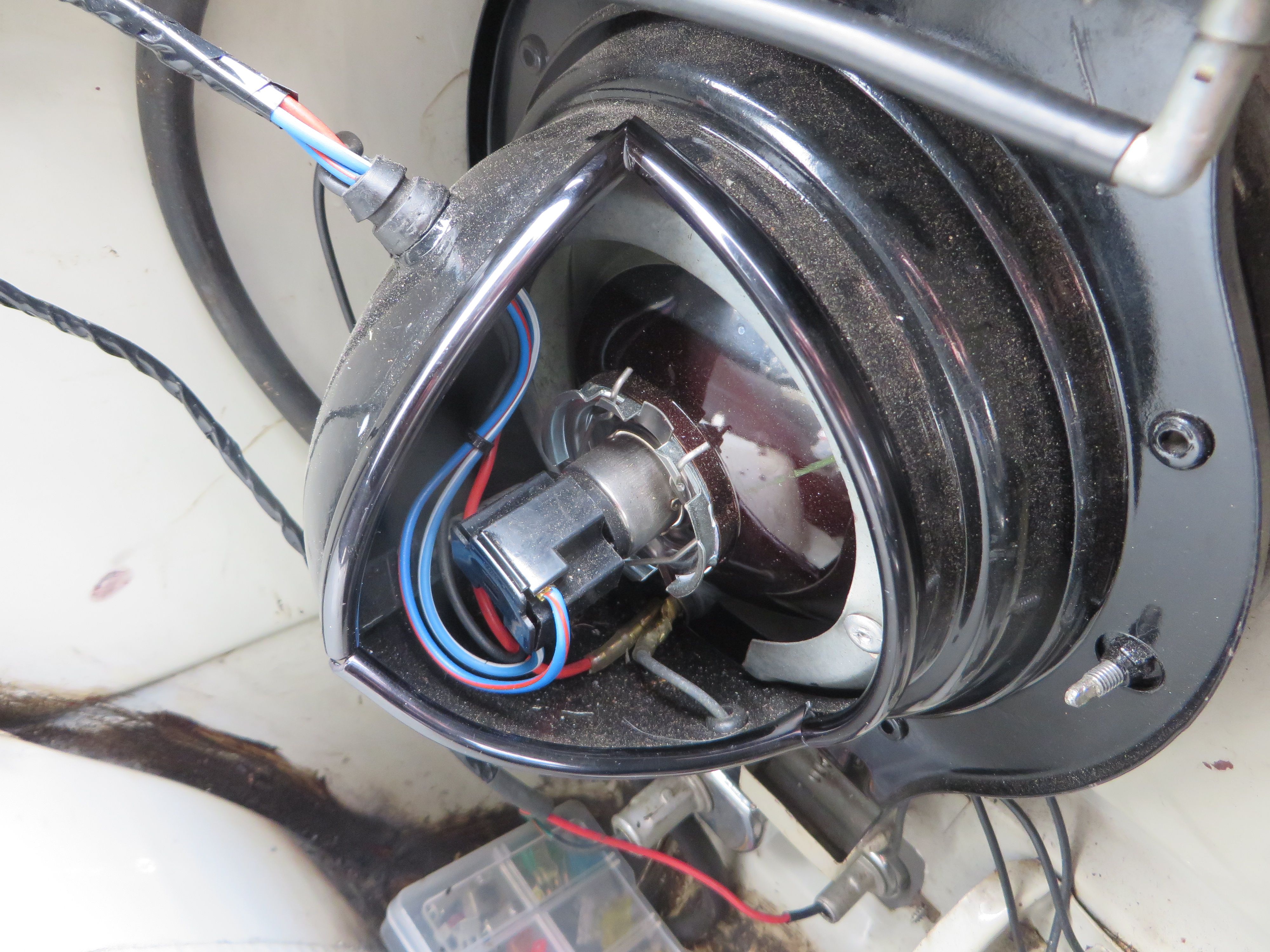

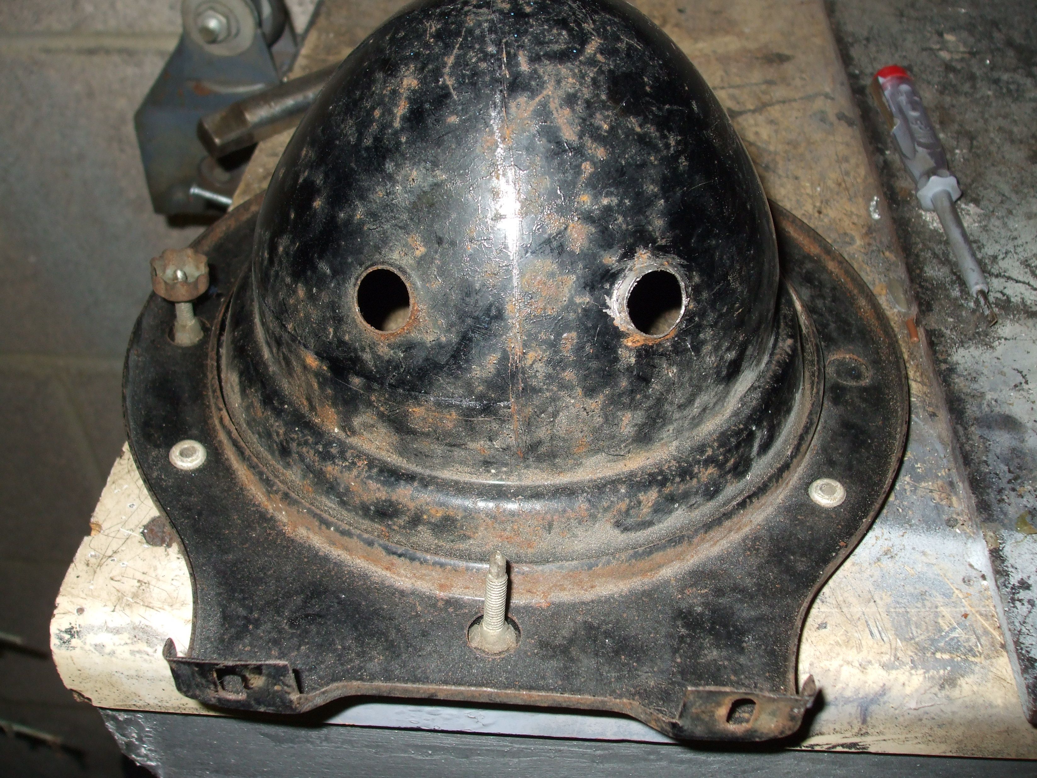

Passenger side is more involved , you need to drill a mirror image wire entry hole and flare it slightly like the original , i just used a suitable socket and a hammer .
Then cut the other side out that was the original cable hole
Sandblast , etch prime then paint

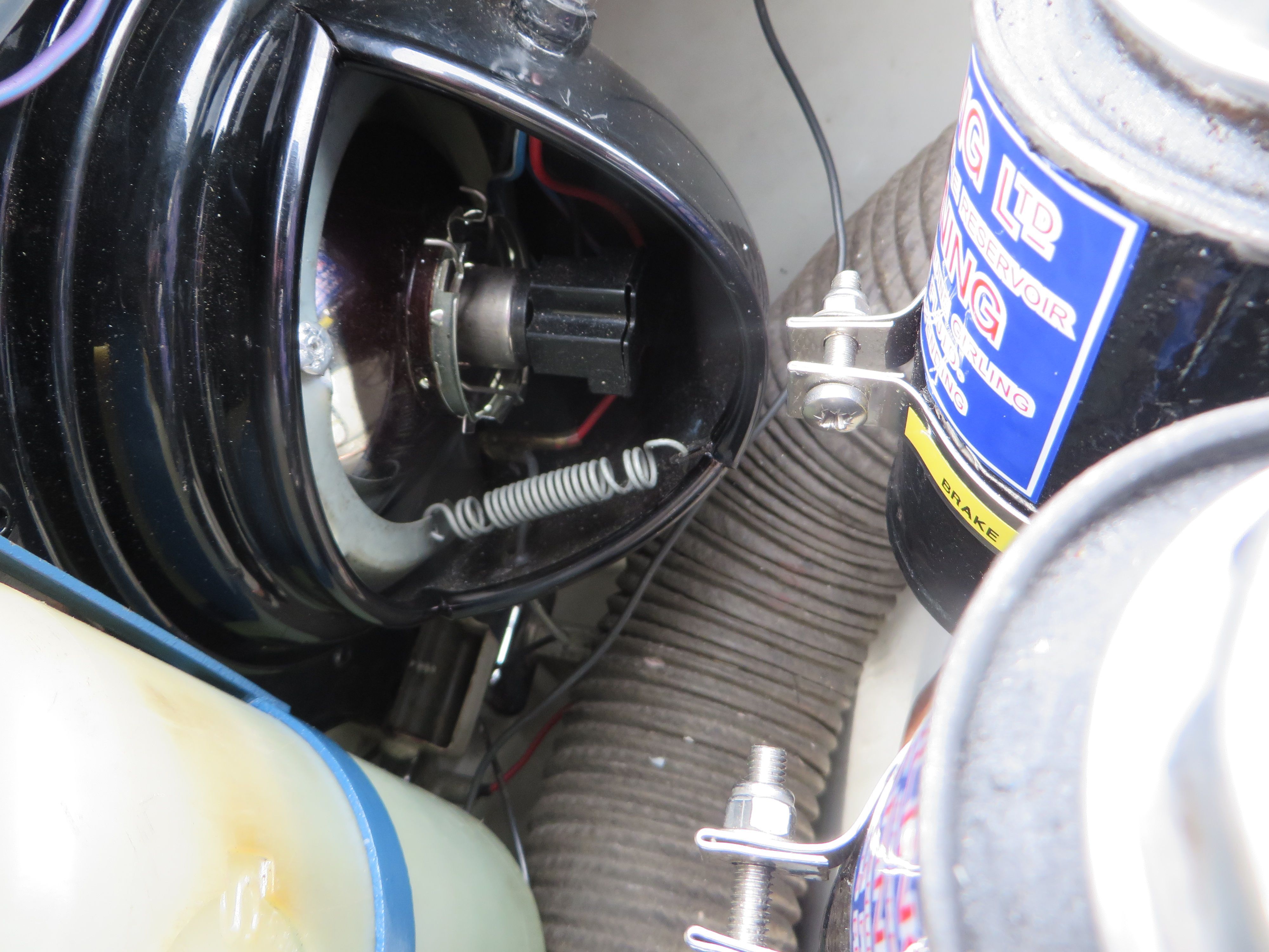

Then fit . if your fitting the sidelight in as well part of the silver mount will need removing to clear the bulb , passenger side in
Drivers side , note the spring and tag which must remain however much you chop out

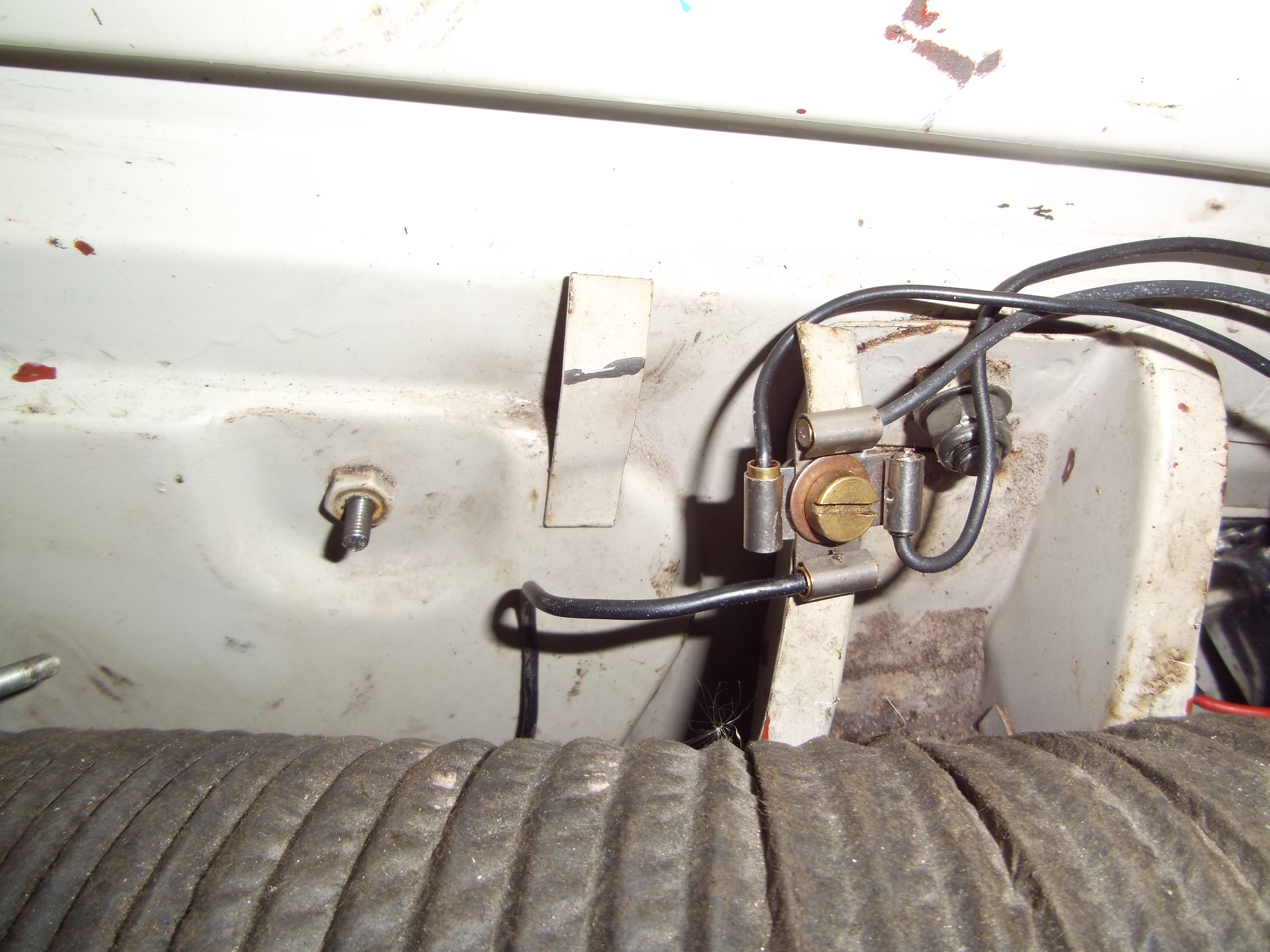

Whilst your at it do away with the headlight earth on top the inner wing and add a dedicated earthing point for the headlight / indicators / electric washers etc ( further posts later will show you how )
Drivers side
