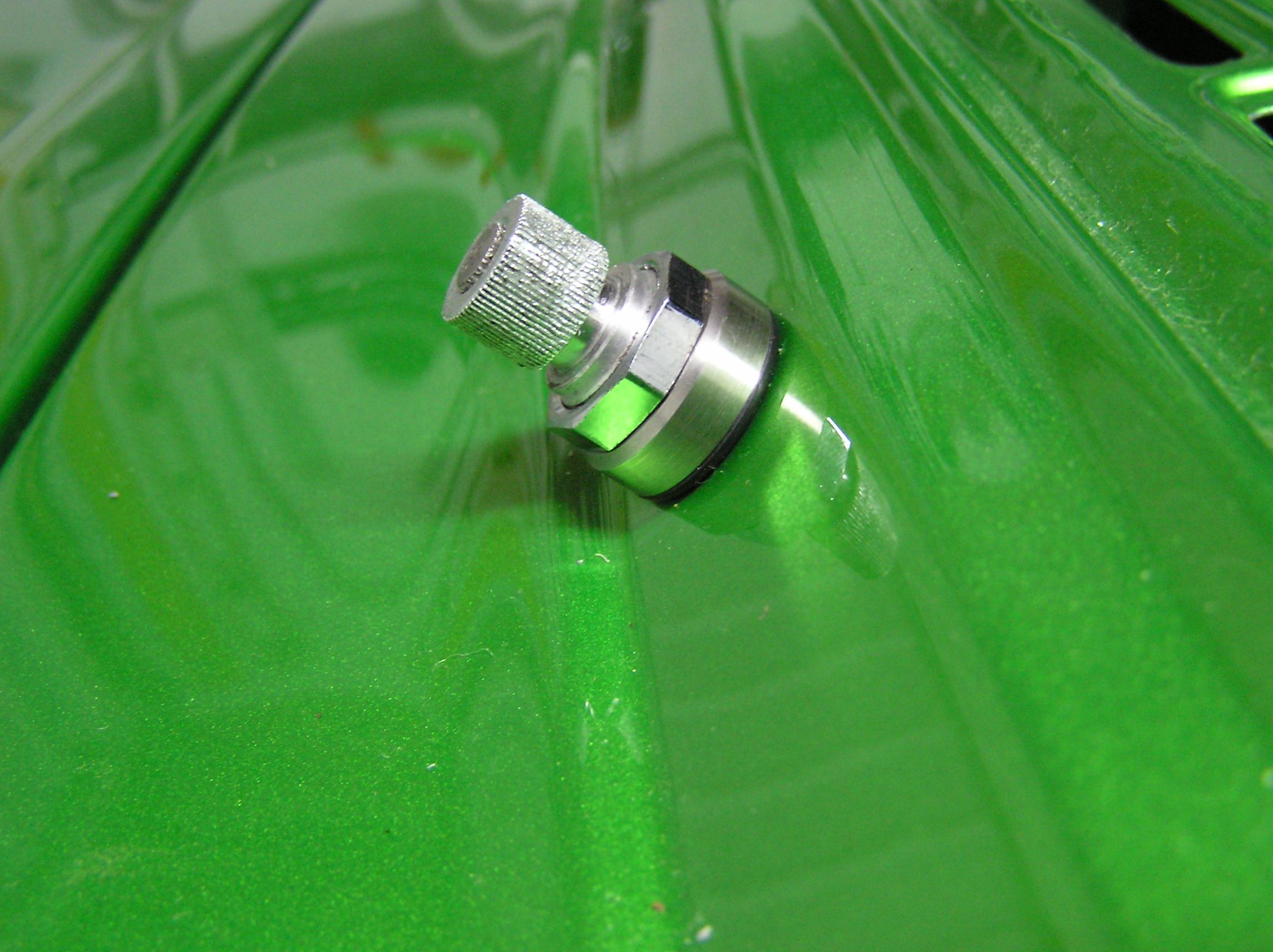

These are standard Lucas wheel boxes for the wipers so this mod will fit many cars.

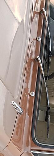

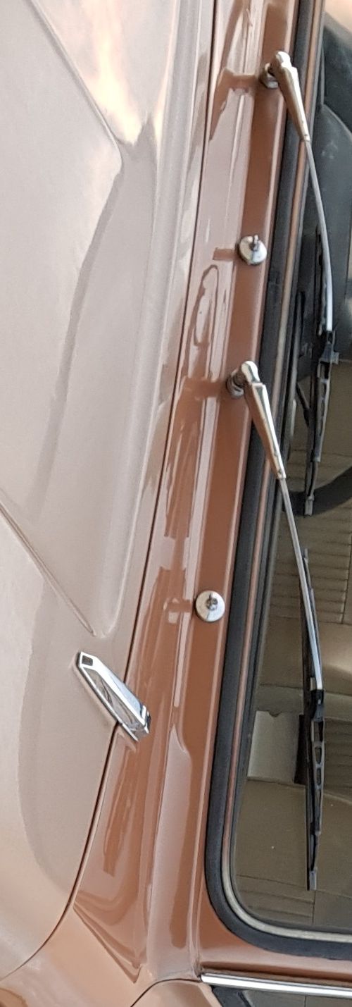

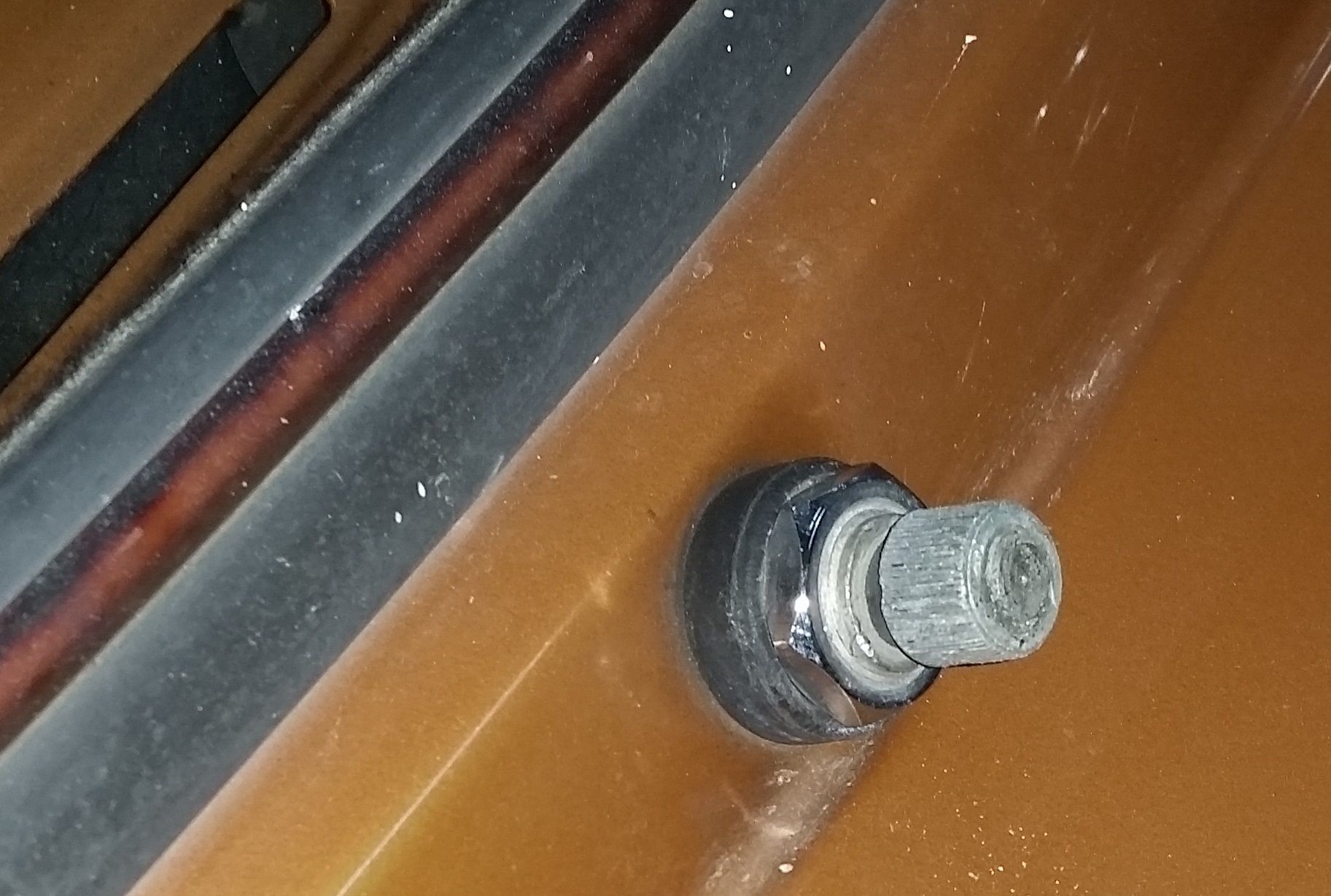

Change the look from this
To this
The matching stainless washer jets can be found in this ARTICLE HERE

Spray a little penetrating fluid around the lock nut on the wheel box and leave for a bit, using a soft brass brush clean out the threads on the wheel box that the spindle nut needs to come off as trust me the last thing you want is a jammed wheel box nut binding on the alumnium. When left for a bit clean off with some more penetrating fluid. WATCH OUR PAINT !

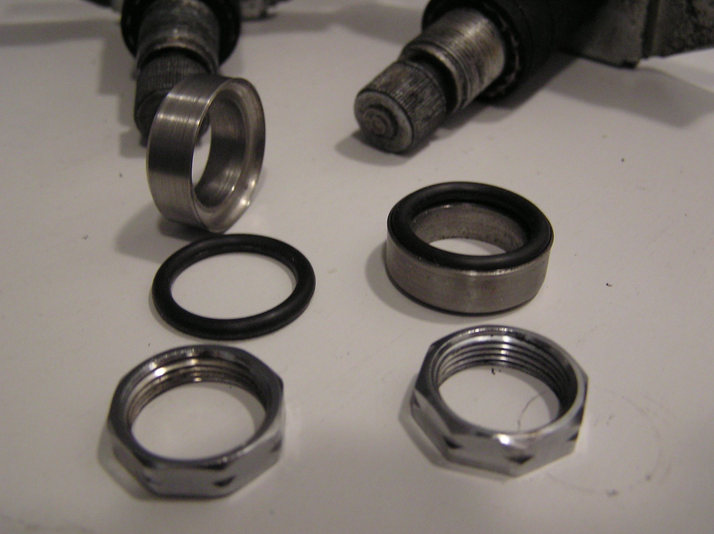

Remove nut
Remove old spindle seal which is usually just a lump of rubber
Clean up residues
Again use a brash wire brush to clean up the spindle threads while you are there

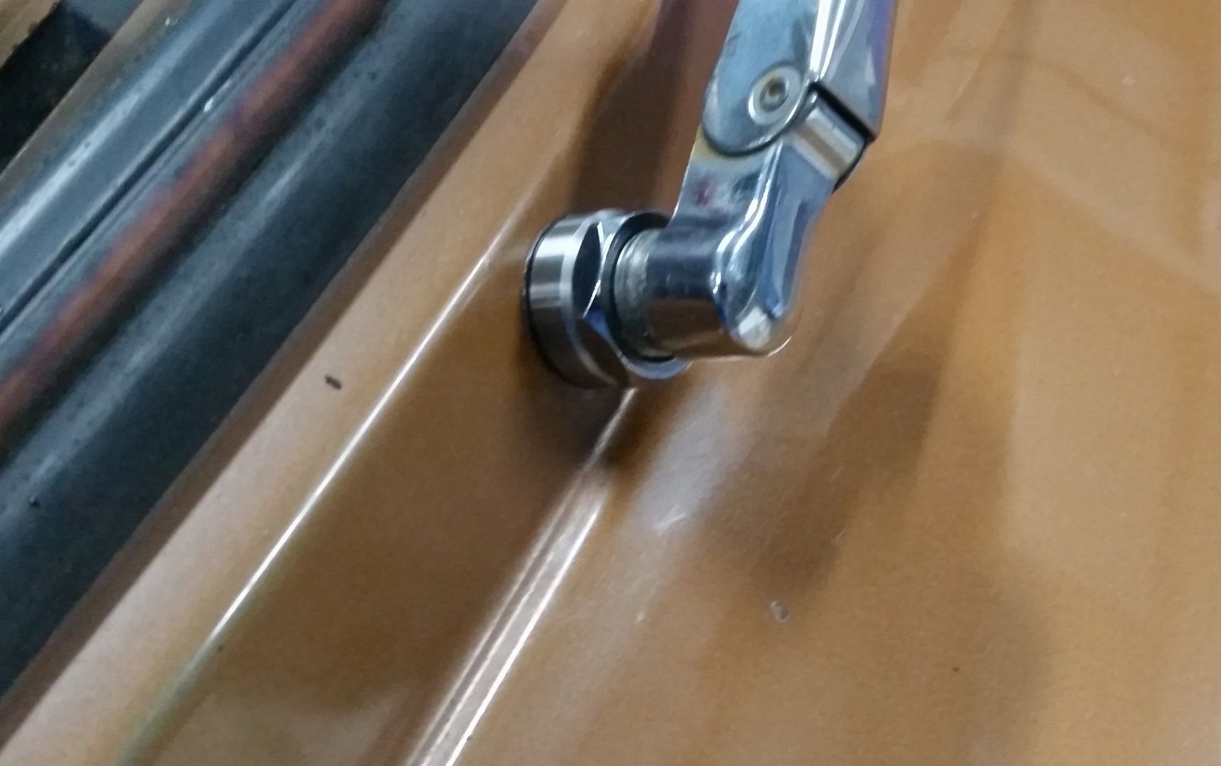

Add some silicon grease to the O ring seal

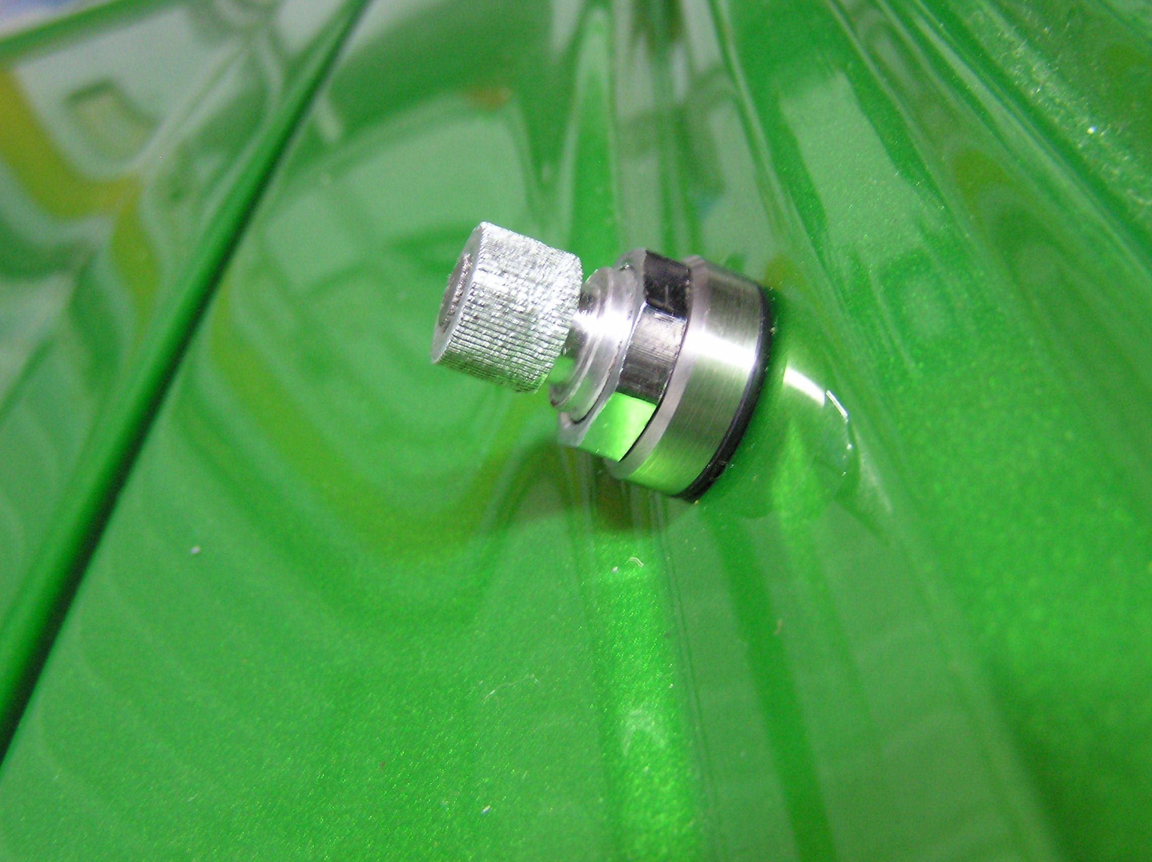

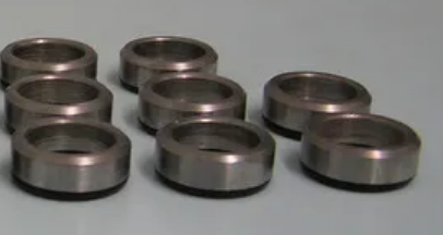

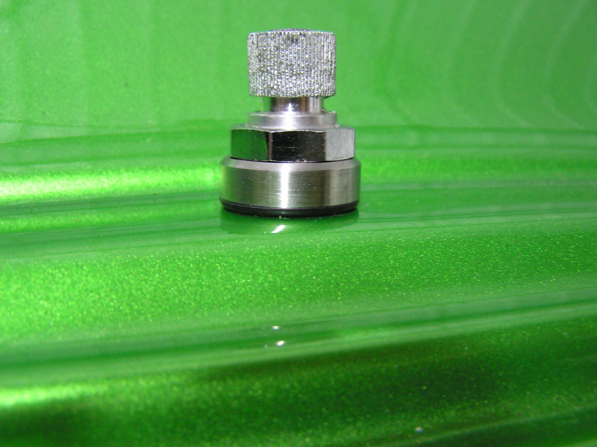

Fit seal body and O ring
Refit lock nut
Clean UP
Refit wiper
Deed done and give youself a pat on the back !
